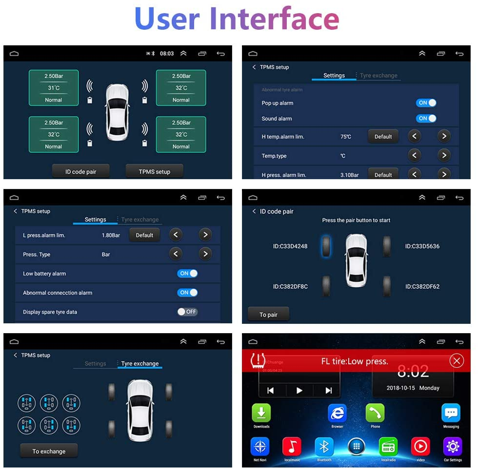

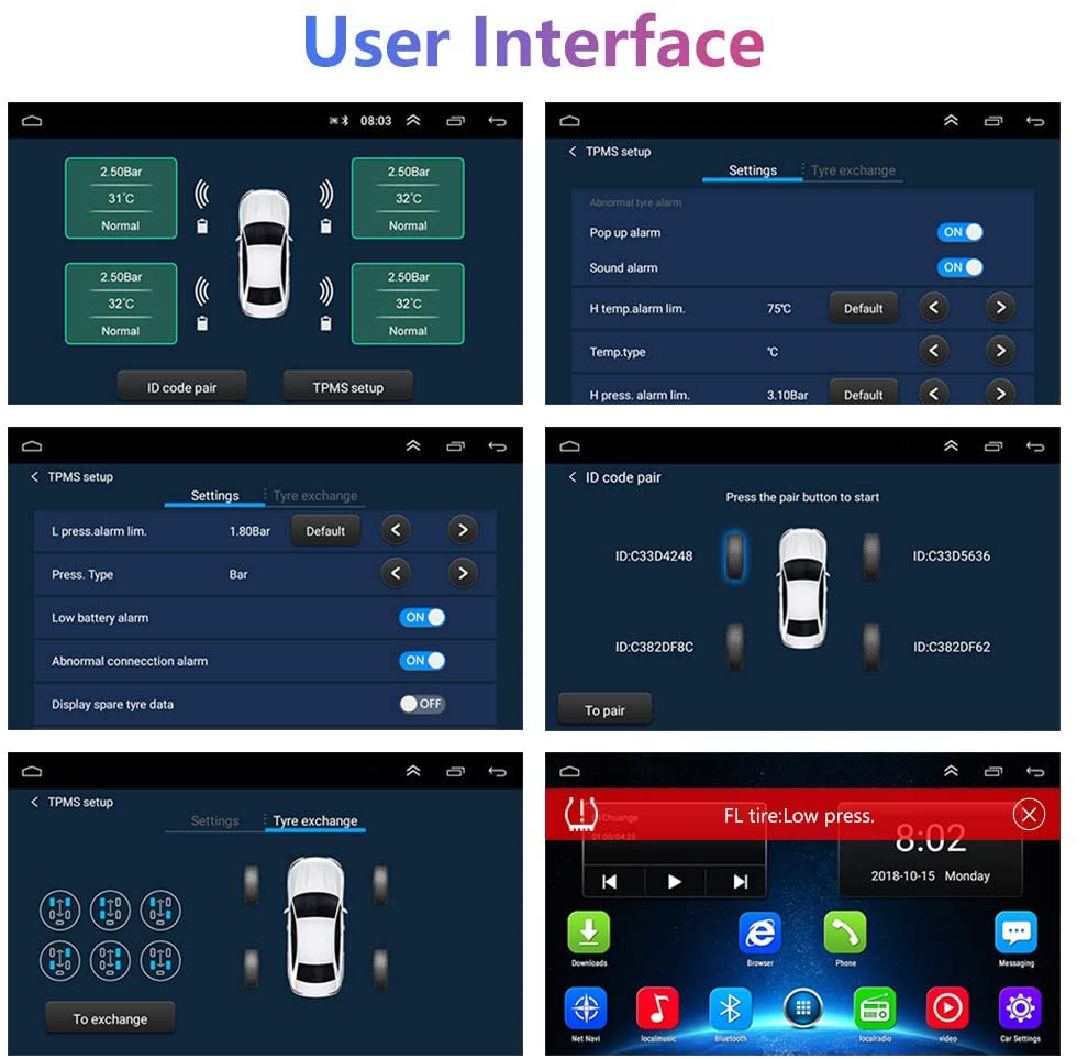

Following are a bunch of App screenshots from the Amazon listing
The app seems pretty good. You setup your parameters for high and low pressure and high temp and then if the thresholds are exceeded an alarm (visual and audible) comes up.
I still think in PSI so changed the units from BAR to PSI, and setup the pressures to suit the motorhome. I run at 65PSI all round and I made sure the TPMS system could cope with the higher pressures found in commercials (the kit works upto 8 BAR, which is well over 100PSI, so more than enough. Many kits are car only and have a 4 BAR cutoff)

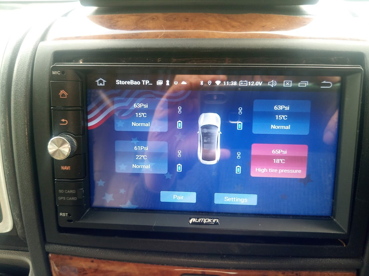

BTW. The display below is slightly different as the App you download is different to the one they supply on the key and show in the example, but everything workds in the same way.
This shows each tyre (and this is telling me I need to pump them up!). I set the High Pressure value to 65PSI to check how the alarm would look.

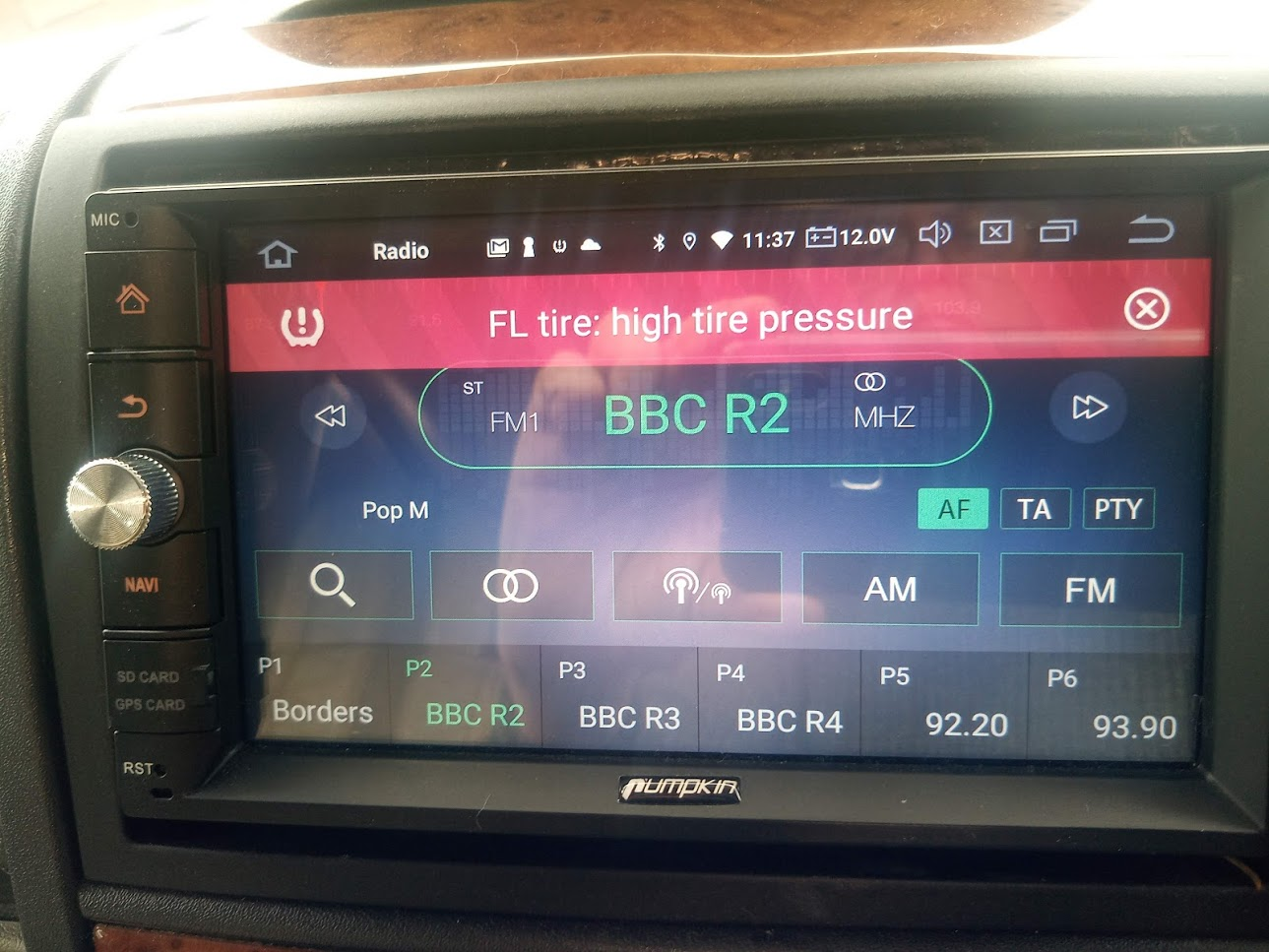

And when the dash unit is in normal use, say listening to the radio, and an alarm occurs, you get this kind of display...
Set the thresholds correctly after that (went for 71PSI upper, 55PSI lower at the moment).
