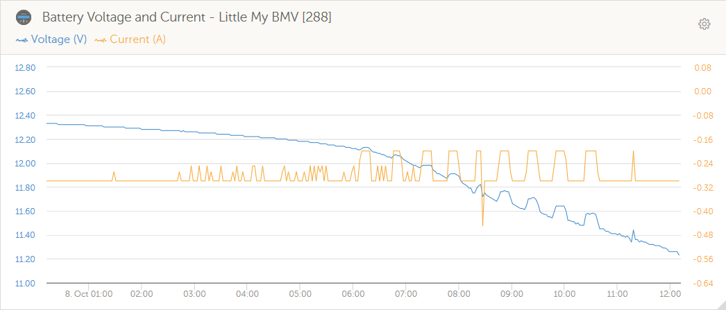

Tell you guys what? I can't wait for those new batteries to arrive at Alpha Batteries!
Check out what my excessive power use is doing to the "200Ah" Battery Bank!!
Down from 12.33V to 11.23V after drawing a maximum current of 0.3A - that is just 3.6Ah in the last 12 hours!

Changed my batteries and I *think* it is better, but not a lot! moved from "knackered" to "slightly less knackered"
This is the original 2 x 100Ah AGM Battery Bank
Voltage dropping from 12.4V to 10.7V in 18 Hours with an average current draw of under 0.3A.
Seemed pointless keeping those in so took out and in their place put in a 75Ah SLA (Sealed Wet Cell) Varta battery and charged it up ...
Same kind of current use (basically this is the Raspberry Pi and MiFi charger)
Voltage dropped from 12.23V to 12.01V, so while still pretty poor, would seem to be noticably better.
You might think there is some other current draw that is not being recorded for this kind of drop, but the battery is connected via the BMV Shunt to the rest of the system, so unless the BMV is dodgy, that is the actual current (and there is nothing running inside so pretty sure it is just that).

Well, looks like the old Varta battery is not much of improvement ....
Wow! Battery is really shagged!
Last update was 30 minutes ago. I would think the Raspberry Pi has now died due to the low voltage.
Will just have to wait until I get some more temporary ones to tide me over until the actual ones I want arrive in the UK :)
