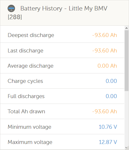

On my test, I went to around 80% Depth of Discharge to see what kind of capacity I could get
if there was an occasion I needed to.
93.60Ah taken out of this nominal 100Ah battery and still within the 80% DoD zone is pretty good I think.
Plus there is a note on the Datasheet for the battery that says "
The battery must be fully charged before the capacity test.The C20 should reach 95% after the first cycle and 100% after the third cycle". So after a couple of cycles I can expect 5% more, so essentially get 100Ah out of this 100Ah battery at 80% DoD
if needed.
So pretty pleased with that (bearing in mind it is possible to go to 80% DoD 2,000 times with these batteries so an occasional visit that low will make bugger all difference

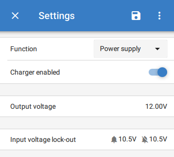

Something I am considering, maybe not immediately, but in the future, is to fit a Buck-Boost regulator in-between the battery and the 12V distribution unit, which could be set at a fixed 12.0V output regardless of the battery voltage. So when charging, can avoid the usual high of ~14.4V which is not great for some systems; and when the battery is low (like as described above), the voltage will be boosted upto a nice steady 12.0V as well.

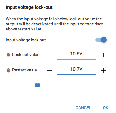

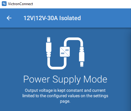

One option is to actually use the Victron Smart-Tr B2B as a Power Supply, rather than a Battery Charger (You can choose which mode you want to use through the Victron Connect App)
In this mode, you set the output Voltage you want to deliver and what the minimum input voltage the battery will carry on outputing to.
View attachment 3152 View attachment 3153
Downside is the Orion Smart-Tr is not a cheap device so while it is perfect for the job, is it really neccessary? Hence the 'suck it and see' approach
