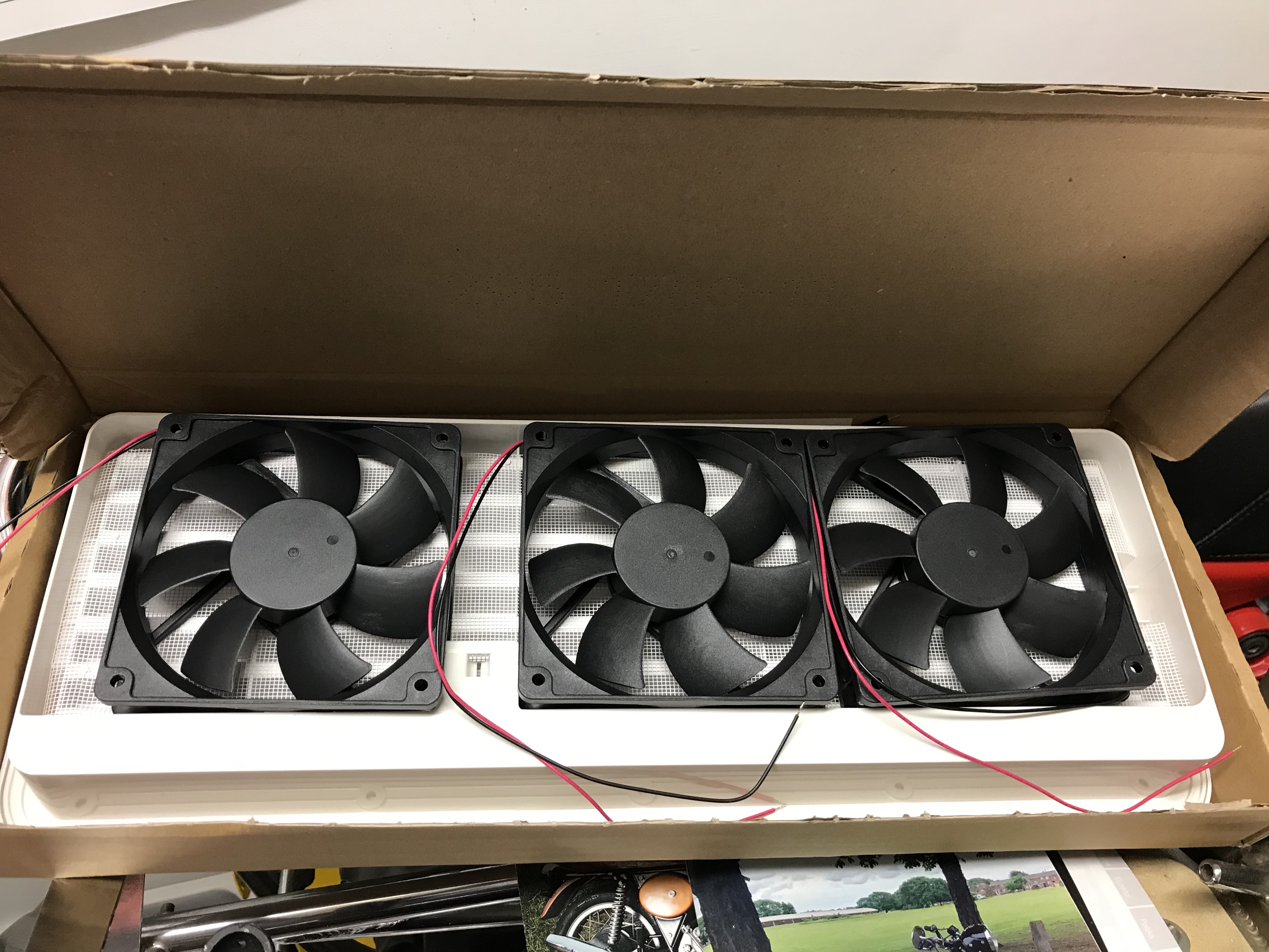

Are you going to do it so the fans gradually kick in one by one depending on the temperature and cooling needed?This my fan plan, just need to mount them and figure out the switching. So much easier to type.View attachment 2641
Fancy idea there David, but I'm going to keep it simple. Once current is detected in the fridge supply the fans turn on. Once the fridge stops the fans turn off. I have a self powered Chinese current detecting switch, but as yet it won't play. I suspect I'll end up making the device I posted earlier.Are you going to do it so the fans gradually kick in one by one depending on the temperature and cooling needed?

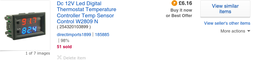

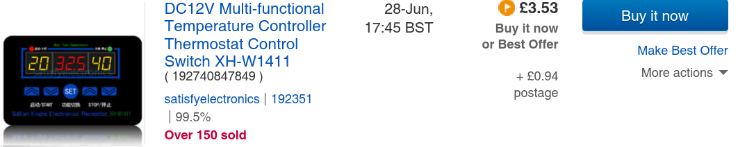

I've studied this route, temperature switching is a serious mistake. Unless you have some fancy controller to take in consideration of the ambient temperature.Are you aware that you can get thermostats, sensors and all sorts of control gear for these computer fans? I had on off controlled by temp sensor then either auto or manual speed control on my big Thermaltake computer years ago before changing to water cooling
Like these.I've studied this route, temperature switching is a serious mistake. Unless you have some fancy controller to take in consideration of the ambient temperature.
