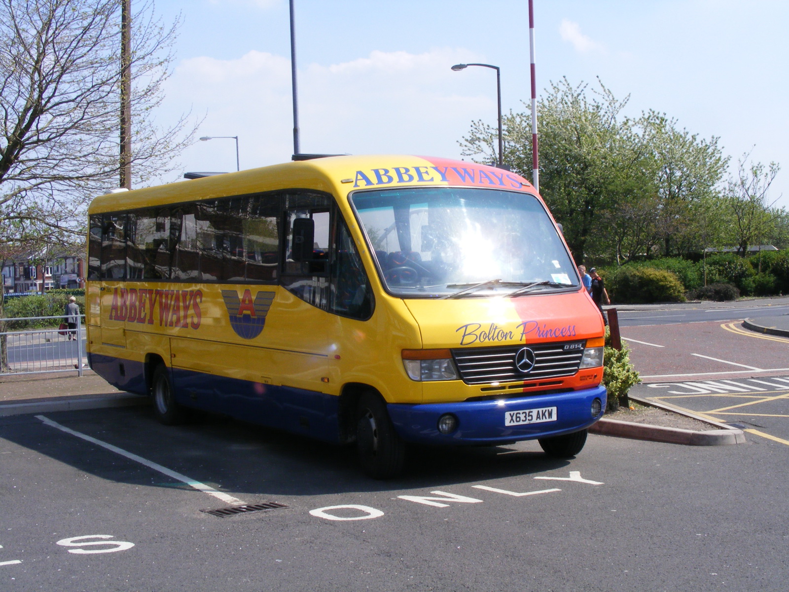

So a new build starts, time will tell how foolish we are being. We have discussed down sizing or even a new build on a chassis bulkhead. In a fit of madness we purchased this old tart, that will be renamed Betty. I hope it doesn't get to many other names. I will post progress as the mood takes me.

Whilst toying with the idea of another project we kind of favoured the look of the Mk1 Plaxton Cheetah. The idea was to buy a clean late model. Looking around they were some distance away. There was no way we wanted to commit if it would be impractical for conversion. We found this thing locally, though it had been repainted. I hate anyone who would do this but we did. We went to look at it with no intention of buying it. I turned down the opportunity to test drive it or even remove it from the workshop to see it in daylight. I didn't want to mess them around to much as we did not want it. After explaining that we did not want it as a coach and did not require a PSV test the price dropped a good amount. So discussions were had as to would we commit £20k - £40k on a better one. Then in a fit of madness we decided the one we looked at. Arrangements were made to recover it and of we set with a pocket full of cash. Pennies were handed over and it was ours. The question was asked "now we've paid you what's really wrong with it?" Even after much bullying he insisted it was good to use as a coach!
Driving it out of the workshop I discovered it had no clutch until the very end of the travel. I could see it had some new pedal parts and realised it had been put together wrong. Easy fix. It started raining on the trip back. Touched the heater controls and the knobs fell to the floor! Wipers worked but not correctly and would not park. It was hard to hold the steering wheel over 40mph Whilst accelerating there was a lot of air noise. Also cold air entering the cab from strange places. OMG it's a heap of shi*.
It was not in a condition to take to it's first MOT, so the weekend was spent stripping the seats out and making a fake motorhome conversion. Shock horror, when it was taken to it's next test it passed it's MOT as a Motorhome with just a few advisories.
