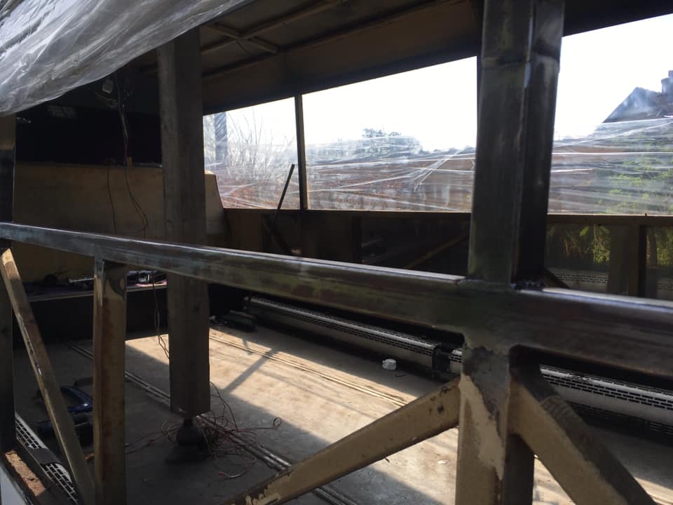

A couple of action shots of Anita fabricating the garage floor outer supports for me to weld in.
