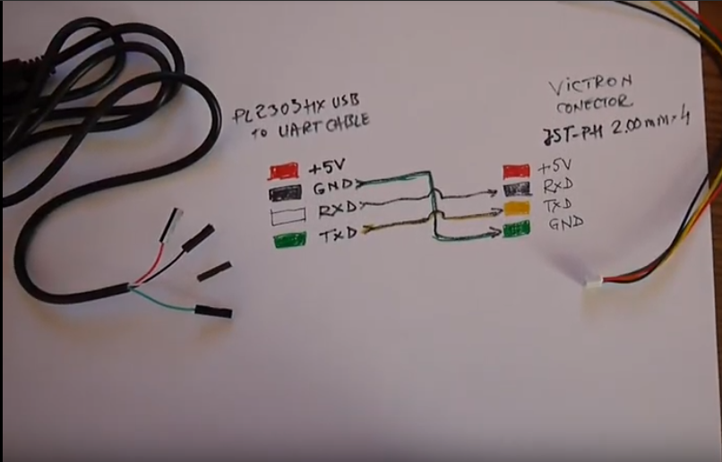

Maybe
And see this Video
Might try that and would be a Fiver (£5) to make the cable though I might have some bits kicking around to DIY it myself, looks like +5V is left out in the comms which is just data from the Victron device to Pi and vice-versa
Cheers as always, coffee is on me when we eventually meet @wildebus !! :cool:
Although the connections in the picture are correct the guy has made a mistake labelling the JST plug side, the TxD and RxD are the wrong way round, which is only a problem if like me your JST plug has different colours to the one in the picture ;)

I never got it to work on a Raspberry Pi running Venus OS and pretty sure I swapped TX/RX whilst trying

Now there is proof that home-brew cables are possible (I have not previously found any "I made this and it worked" reports until Del's posting), decided to try again and started looking for cables.
