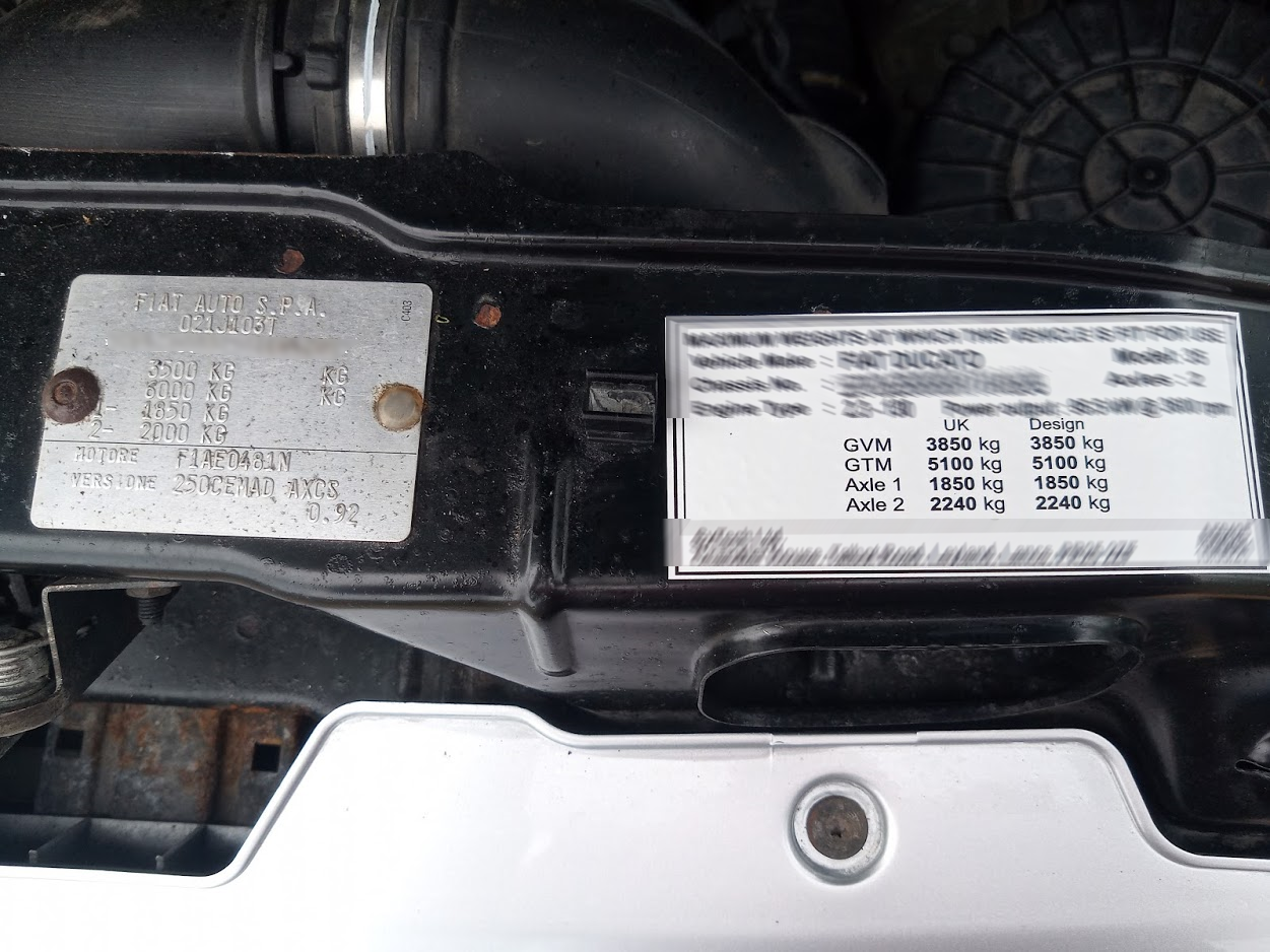

Stuck my new VIN Plate on today (y)
Extra 350Kg to play with now :D
Going to the weighbridge tomorrow to get a current idea of how much the Motorhome comes in at with a full load of water and a full tank. Then the difference will be there to accomodate two occupants, a few clothes and a pair of eBikes and whatever might go sit on the Thule Easybase :)
Need to send the V5C to DVLA to get the weight updated as well. I think I am ok to run to the new weights whilst waiting for the updated V5C as long as the request has been sent? (could be relevant as DVLA staff are apparently in a dispute and it can take many weeks to get requests completed).
Weighbridge visit just done. Came in at 3780 total and 2200 at the rear axle. However .... the business I use with the weighbridge is waiting for an engineer to come in and check it as they suspect it is out by maybe 100Kg or so, which I think is likely based on other times I have got weights done there on this van (the last weight was 3500 compared to 3780 today and I don't believe I have added nearly 300Kg of weight in-between the visits)
