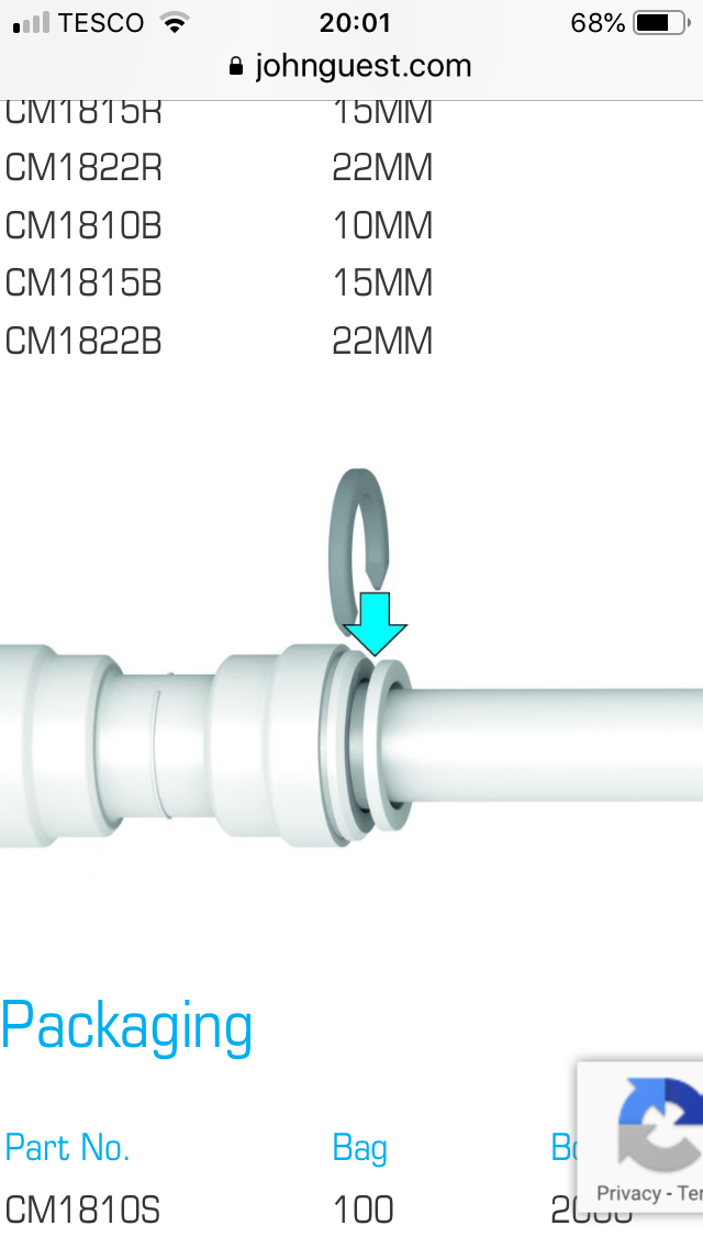

John Guest ?
Another question- should I get & insert these collets in the joints
Never seen them before silly arse that I am, but I don't have them on my pipes and in my installation at least, so far, I don't have any leaks.....
If you want to use them Vic then do so, but as Phil (Squiffy) says, they would be an absolute pain to try to ever remove.
I like my barbed connections with the plastic pipe :) secure with jubilee clip and either warm to remove or just snip off and remake as appropriate.
