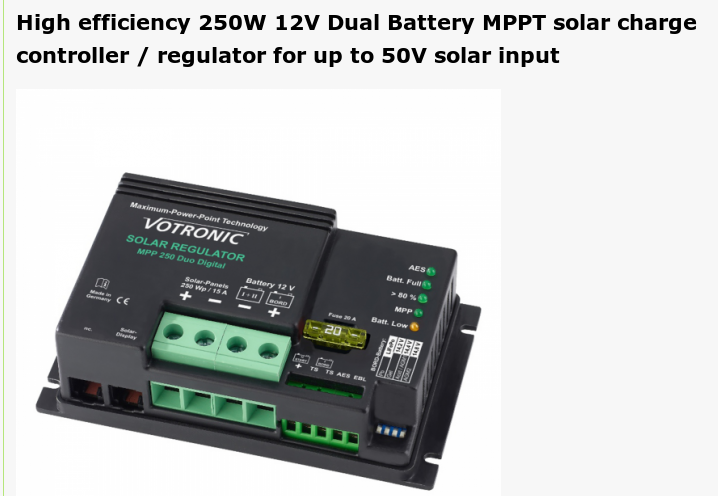

I have 200w solar and feeding into 180ah batts, make sure you are using a MPPT regulator, votronic has a 1am bleed to starter battery which is handyView attachment 3780
