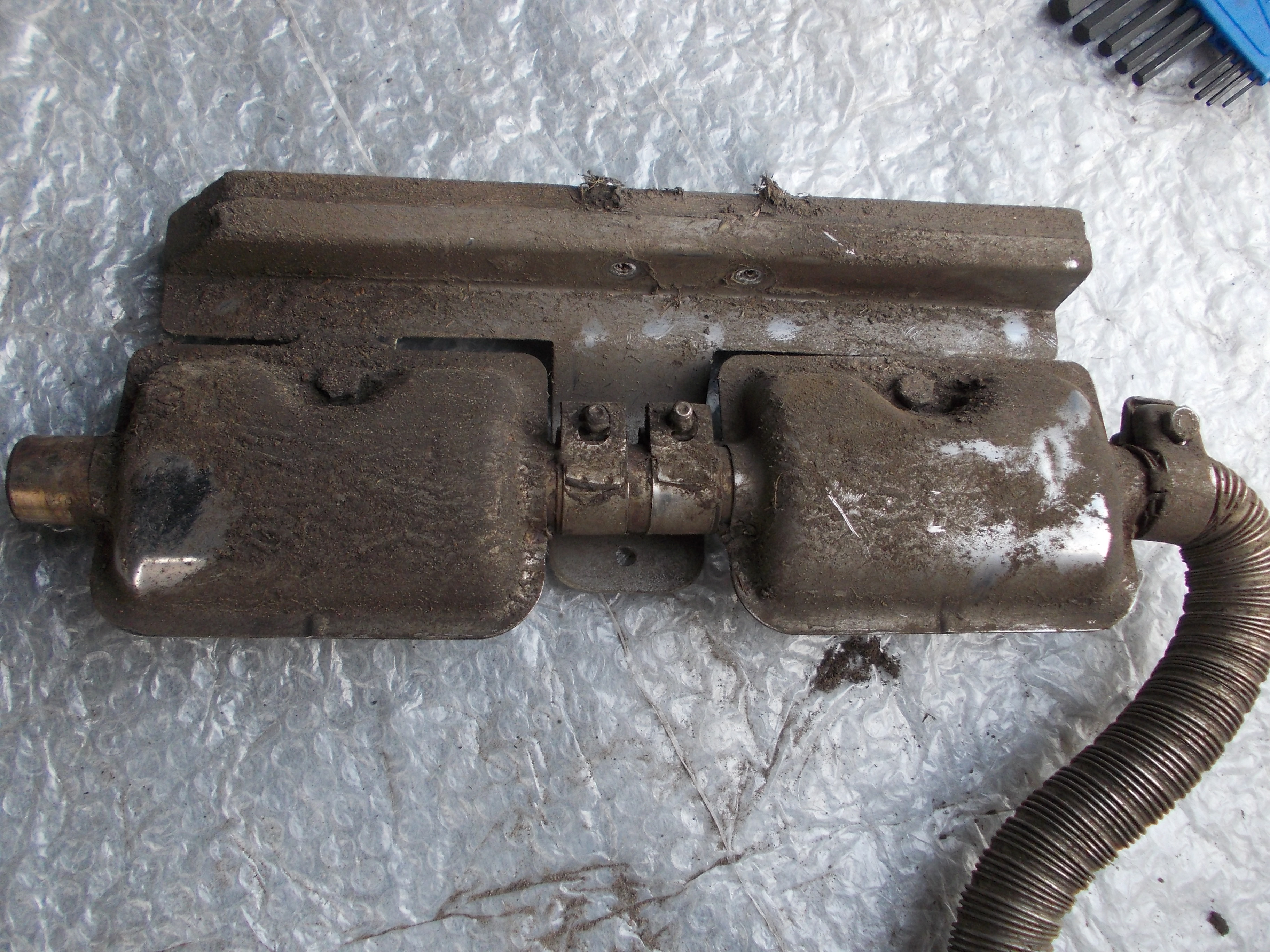

Could not believe how much soil had deposited itself on the silencers.
Next job, pull the silencers apart and have a look through. When I was making this system I opted for the Chinese silencer as it was straight through. Looking at the first one, no problem there.

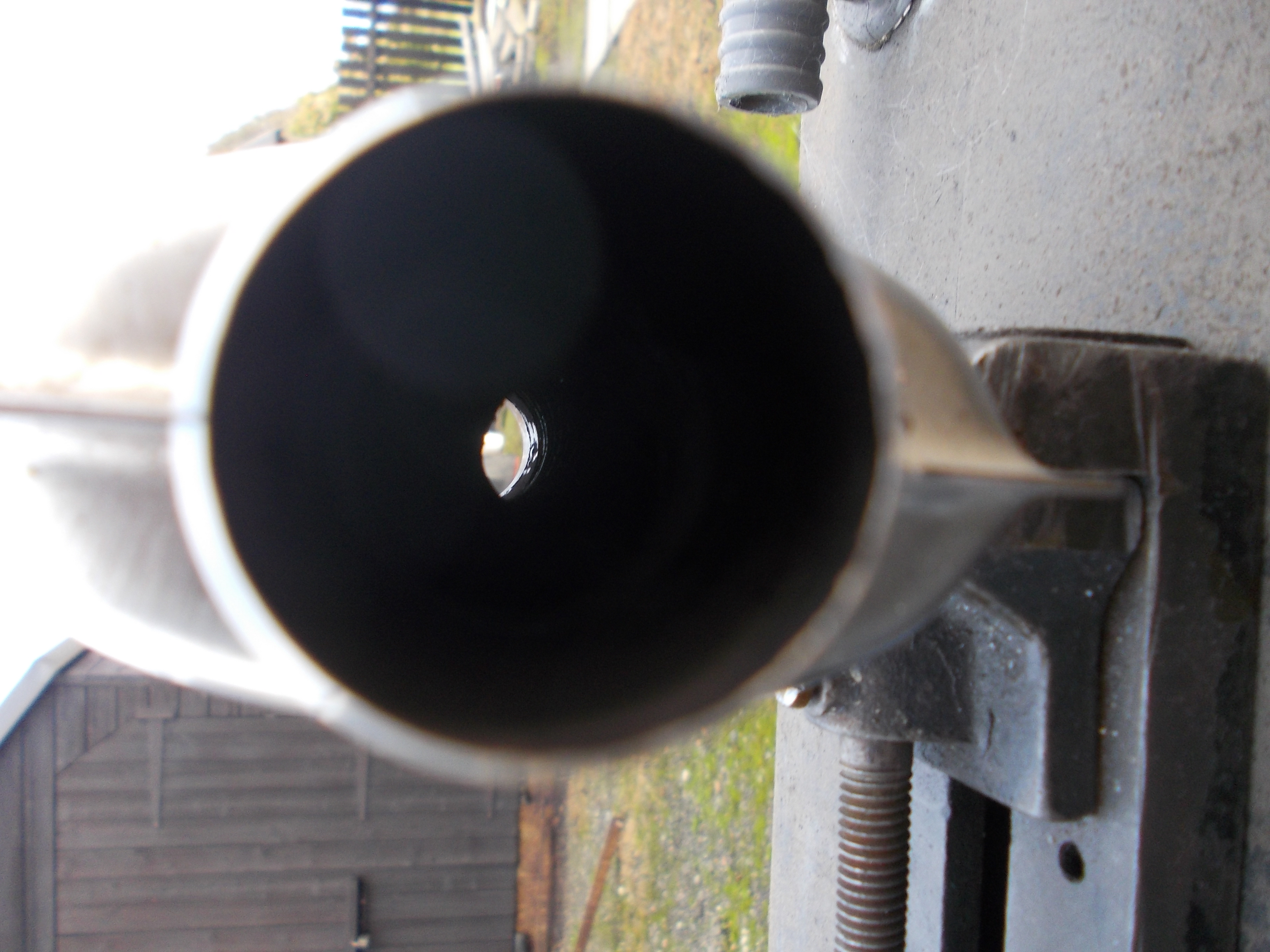

Here we have the second. I think, and I say think, this may be the problem. The muffler has collapsed inside and it must make some difference to the exhaust gases. At the moment I'm running it with no silencer just to see if that, in fact, was the problem.
A new silencer will have to be purchased but, this time, a quality one as I believe the noise will not be acceptable to me.

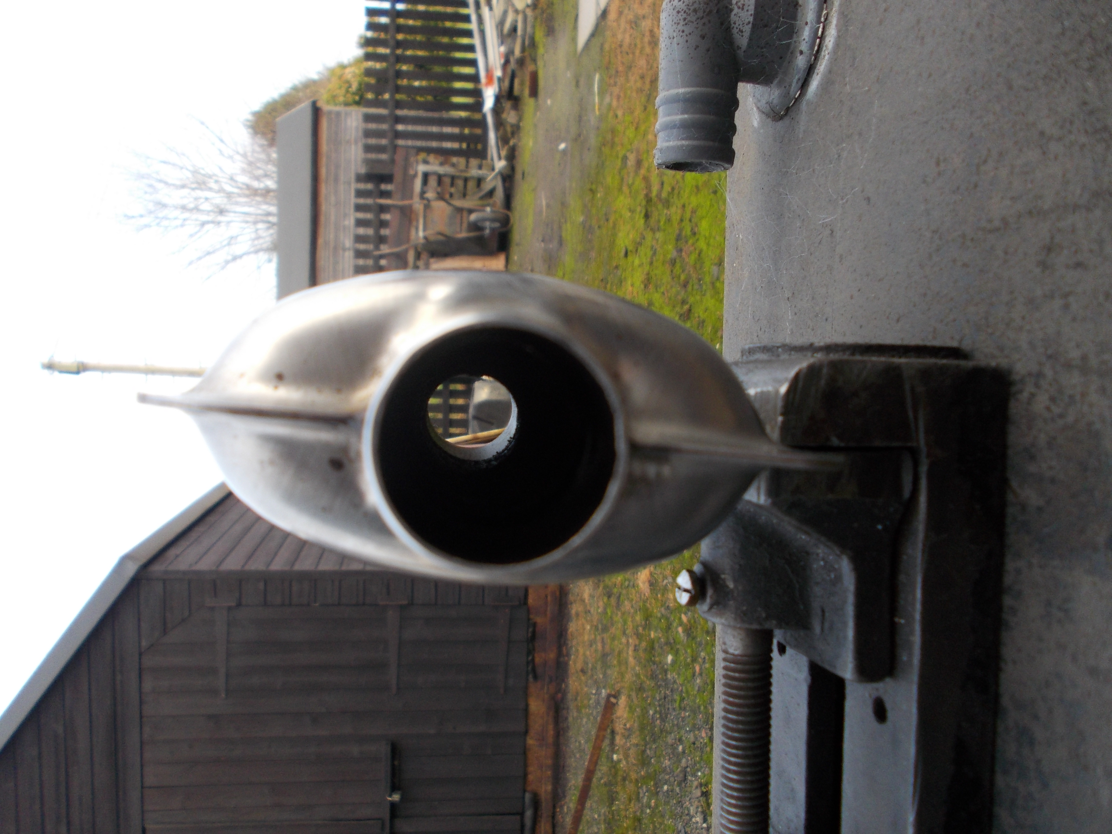

Doesn't look damaged to me... Just looks like the genuine eberspacher 'u' bend inside...
I'd be more concerned about the fact I'd paid for a silencer with the other one and got an empty tin...
Have a, looksy on here at what a correct one looks like inside.
Could still have all the wadding around it even if no bend though. Can't be sure it is an empty tin from that picture.
I have taken it apart and it looked like the spring had collapsed and, yes, it is a Chinese one. I could have used a eberspacher one but I wanted one that was straight through, as I had 2 in line, I thought the bend x2 would slow the gasses down.

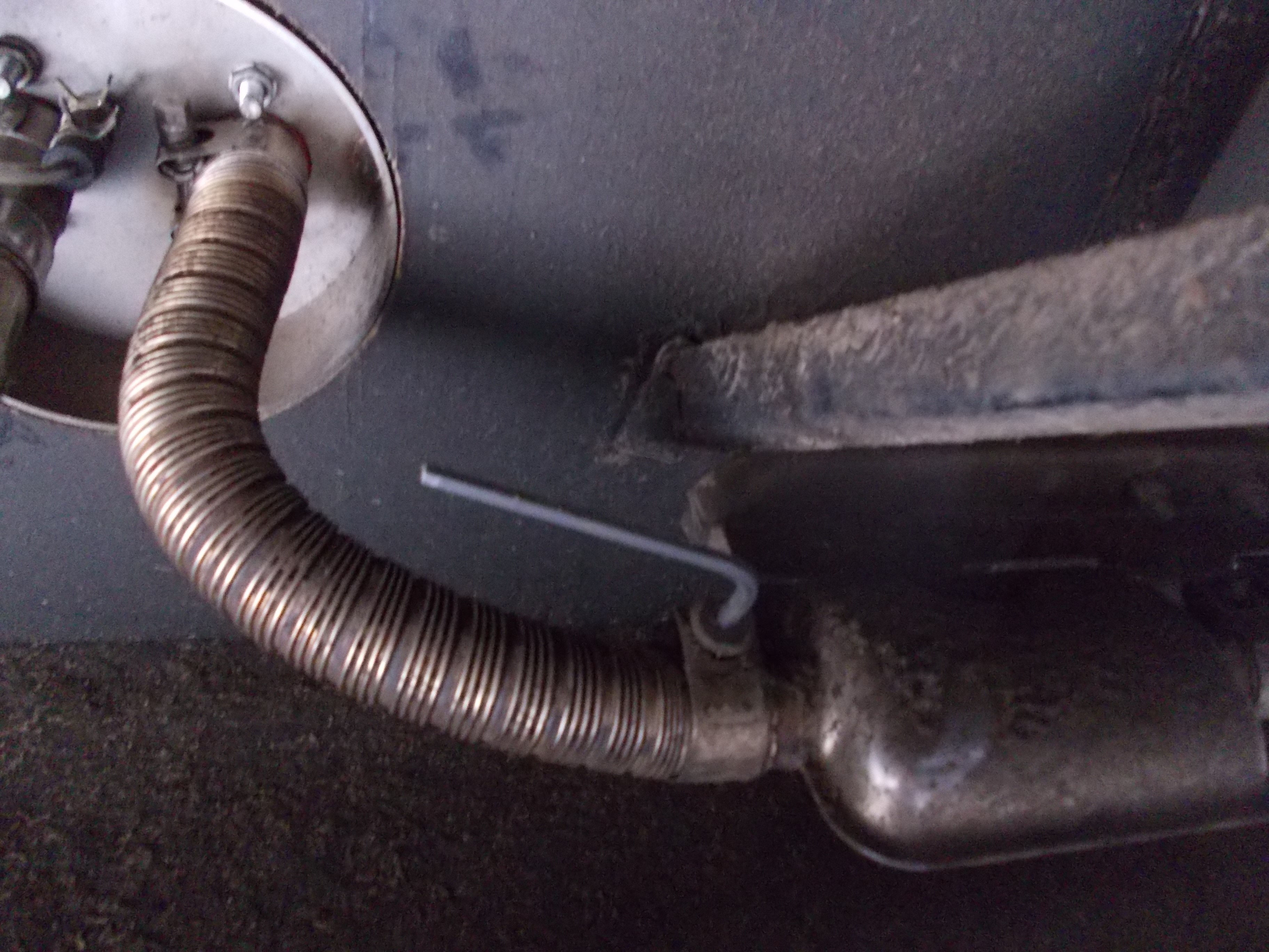

I had a similar problem with my old eberspatcher , every so often I could smell burnt diesel fumes in the van , I did same as you and dismantled it then cleaned it and rebuilt it and it was great again , but now and then the smell would return , eventually by luck I noticed the fumes stronger around the cooker area , after further investigation I noticed a vent in the floor under the cooker and realised this was were the fumes from the heater exhaust under the van was coming in and not the hot air outlet from the heater , I moved the heater exhaust and pointed it away from the underside of the van and the problem was cured , no more fumes in the van . Could this also be the answer to your problem ?
