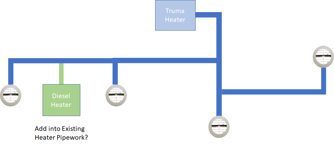

What is the concensus on fitting a Diesel Heater as a secondary/backup heater, and adding it into the existing heater ductwork? such as in the diagram below? Blue would be original. Green would be the add-on.
Some of the things that I would want to know is:
  1. Heat. Is the Diesel Heater output (which is pretty high) compatible with the ducting? What is the temp at a Truma Heater as it enters the ductwork?
  2. Backflow. Any issues pushing hot air INTO the output vent of the Truma Heater?
  3. Flow Pressure. Enough airflow from the Diesel Heater to push around the existing ductwork?
  4. ANO?
I am also looking to add a diesel heater into my van as an alternate heating option. Obviously can install it as totally independant, but I would like to take advantage of the standard ducting to circulate the heat around the living area and washroom like the Truma does for improved comfort
I also do not want to decommission the Truma Heater and want to be able to chose whichever heater to use (for one thing, if on EHU, would make sense to use the Electric option on the Truma).
Any thoughts/experiences on this?

Would some of the heat from the diesel heater which gets into the Truma be wasted heating water in the combined boiler?

In my case, the water heater (UltraStor) is separate from the room heater (UltraHeat) so residual heat wouldn't have any impact on water but it could make a difference on a combined unit? If you did have a combo unit and had water on, does the room heater part work at the same time? (Or is it like a domestic boiler where there is usually a diverting valve so it is either/or but never both? (and usually water has priority))

I think Rae used his existing ducting for his diesel heater.

Before the engine died on our Old Hymer I fitted a chinese diesel heater and connected it to the exisitng ducting and it worked a treat.
When we scrapped the Hymer I used it as a donor vehicle for a self conversion and moved the heater along with most other stuff over to our current van where it also works just fine.
