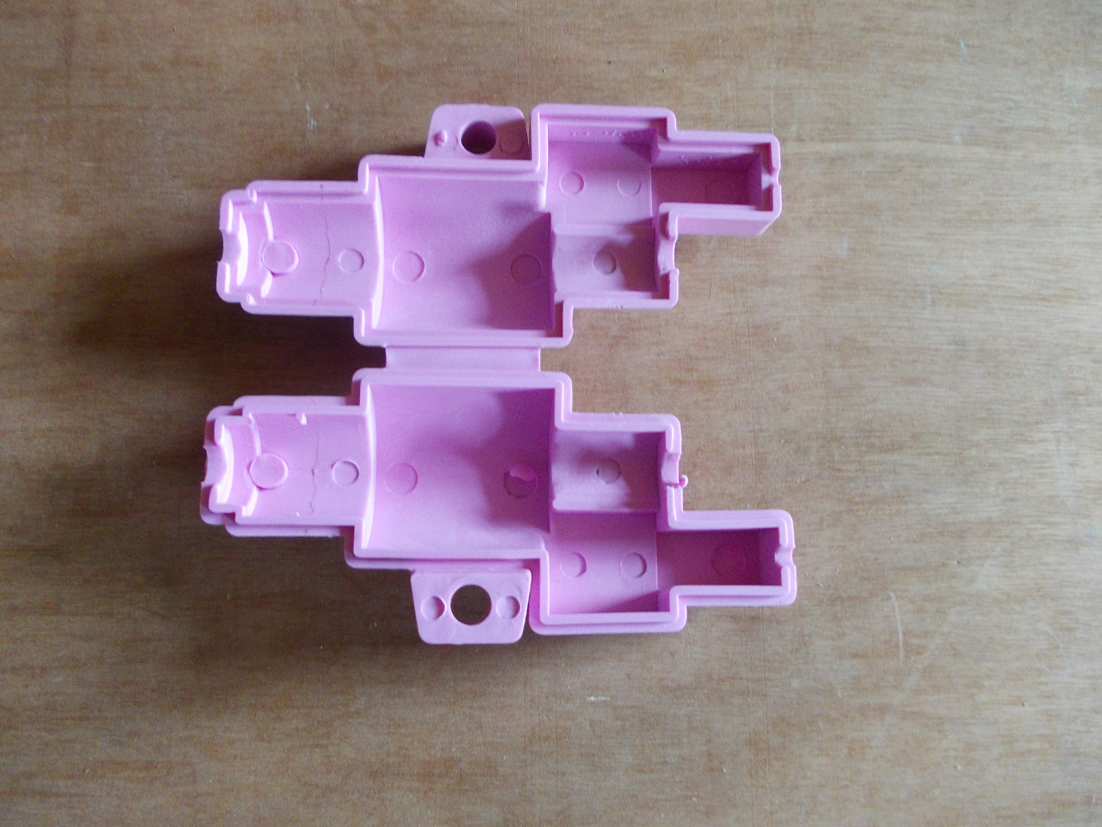

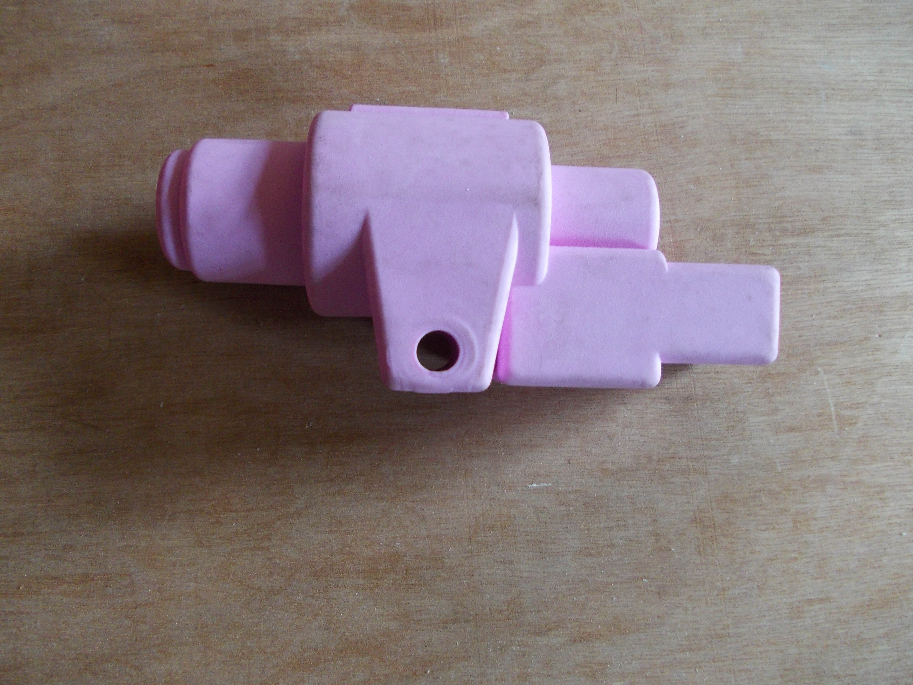

Pump cover arrived this morning, fitted it to the vehicle by the means of two tie wraps and I can honestly say I could not hear any ticking from the pump in the van. You could still hear some ticking from outside if you lay on the floor and crawl under the van so I would have to say this has been a big improvement.
