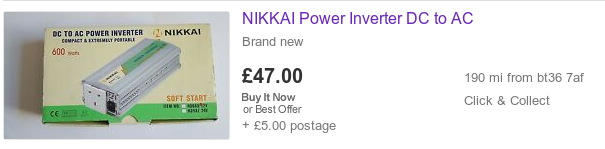

Well my we el cheepo standard inverter is running the fridge 100% from about 11am this morning with some of and ons,it goes into a sleep moad using almost nout on a ammeter,voltage from 13.7 down to just above 12v on first cycle to get fridge down to almost 0c ,it then holds a long time to fridge rises to just above 2c and on its comes for around 8mins run time,and only has done a few on ofs so far.
I have also connected a small 2 ah smart charger to batts and it has it up to float long before compressor starts,so im thinking my 200w of solar and two 90ah batterys are going to be no prob to this we baby.

Here is the inverter used on ebay for little money,it goes into a sleep mode when not working so must be load sensitive.
So far test with battery charger connected to two 90ah batterys the charger when fridge and inverter on load shows 4ah pull for 8 mins,next il try and see how many times in a hr it runs.

Be interesting to see what size load wakes it up. if you say plug in a 240V USB Phone Charger will that come on?
It sounds decent enough but I would consider aspects like heat and noise as well - most inverters are not dsigned to be powered for 100% of the time (even if mostly in a sleep mode).
Well fridge has been running all day on one battery with a 4ah numax charger linked,this is what im hoping i will get from 200w of solar at worst,voltage at start is 14.3 dropping to 12.3 when fridge cuts out and inverter goes into standby,fridge holding 0c to just above 2c when requiring boost,this is all tested in garage at 8/10c ,so next test will be to heat garage to 25/30c to emulate summer time temps in van.
