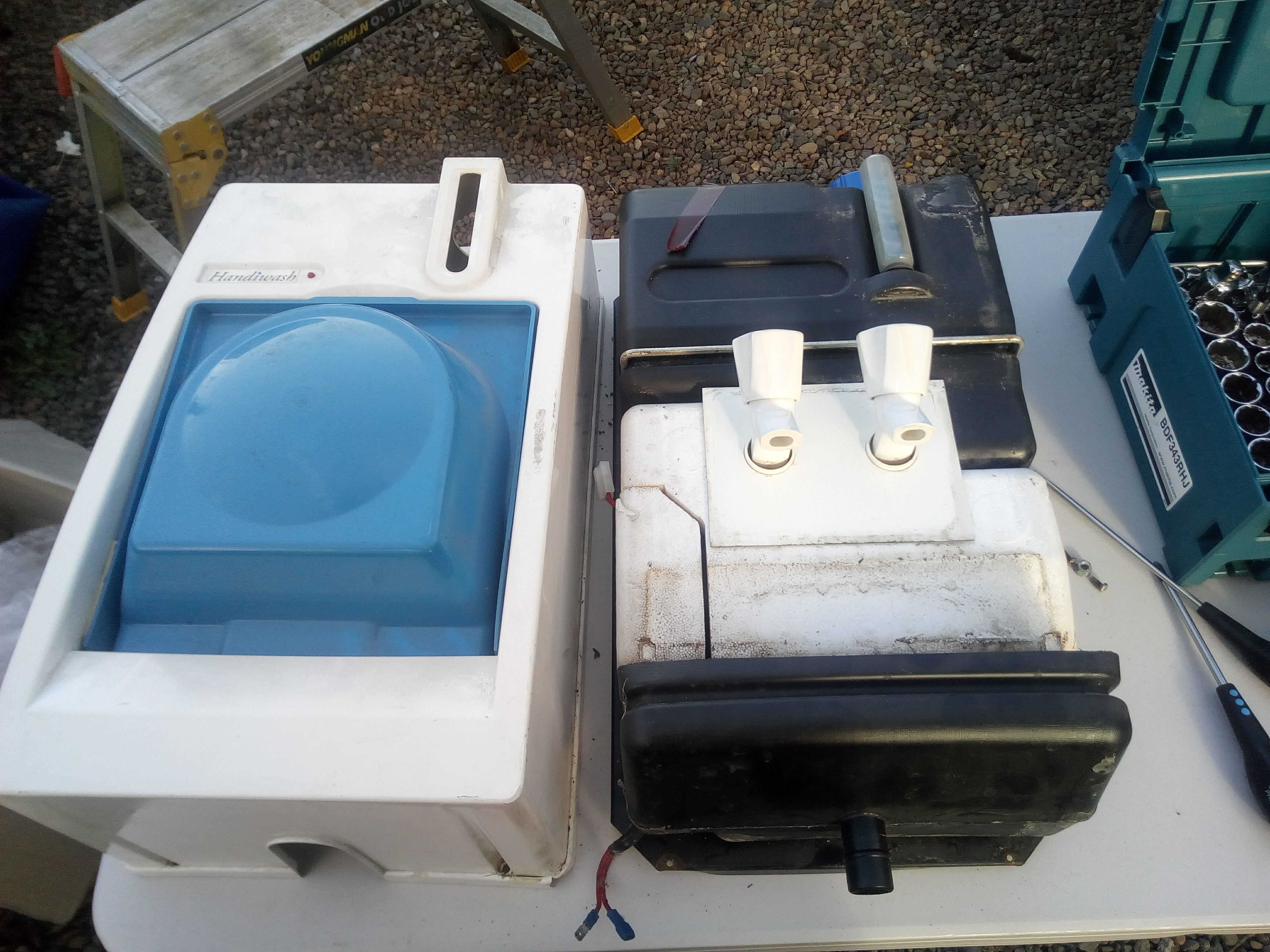

This is the unit (cover removed so I could clean and check it over before testing it)
They are handy units and provide cold water and hot water from the resevoir without the need to plumb in any feed or waste supplies. Ideal for a wash room.
