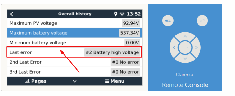

Ok, the PV voltage is fine, but the battery voltage? Opps!

Seems very high to me, highest I have seen mine go to is around 20V
20V? that won't be doing the battery much good! (unless you mean the PV Voltage?)
Not sure where my high value came from. probably a momentaty connection or short when moving cables creating a glitch but obviously not real.

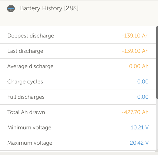

If I go to Advanced on VRM for the past month I get this

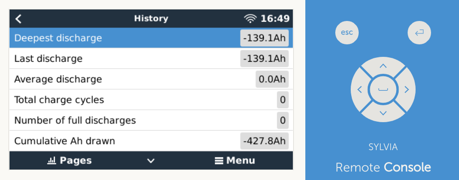

If I go to the console as you suggest I get this
Not sure why that is ?

you can scroll down for more items.
Your average discharge seems a bit odd at 0.0Ah. You'd expect that to be somewhere between 0 anf the deepest discharge number, but not actually at either extreme.
This is my screen for that info ...
For anyone not familiar with this info from the Victron BMV, a "discharge" is the greatest amount of Ah out the battery used since the last full charge; a "charge cycle" constitutes a drain to around 50% and recharge; and a "full discharge" is the battery going down to Zero SOC (or more likely, the BMV power being removed and the monitor treating it as a reset)
