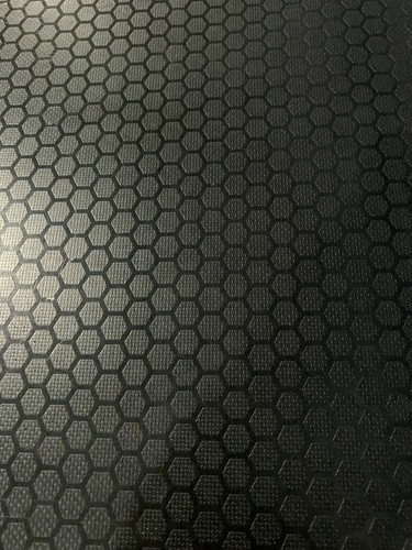

If making a floor then use sealed fiber board and insulate before fitting a top skin, good luck.

This one below might be more useful for the floor, I think this is the size that Peter used, but I think you can get 12 foot lengths not sure of max width, a truck building shop would have a better idea, that's where he got a lot of info on parts to use, AALCO was his supplier for aluminium extrusions for joints corners as caps.
Cheers for that… the flatbed that’s been built on the iveco is entirely plastic! About 15mm thick. So it’s never going to rust/rot. I’ll insulate the floor on top of the plastic & put down a 15mm ply floor I don’t think I’ll need it to be weatherproof inside the plastic body. 👍

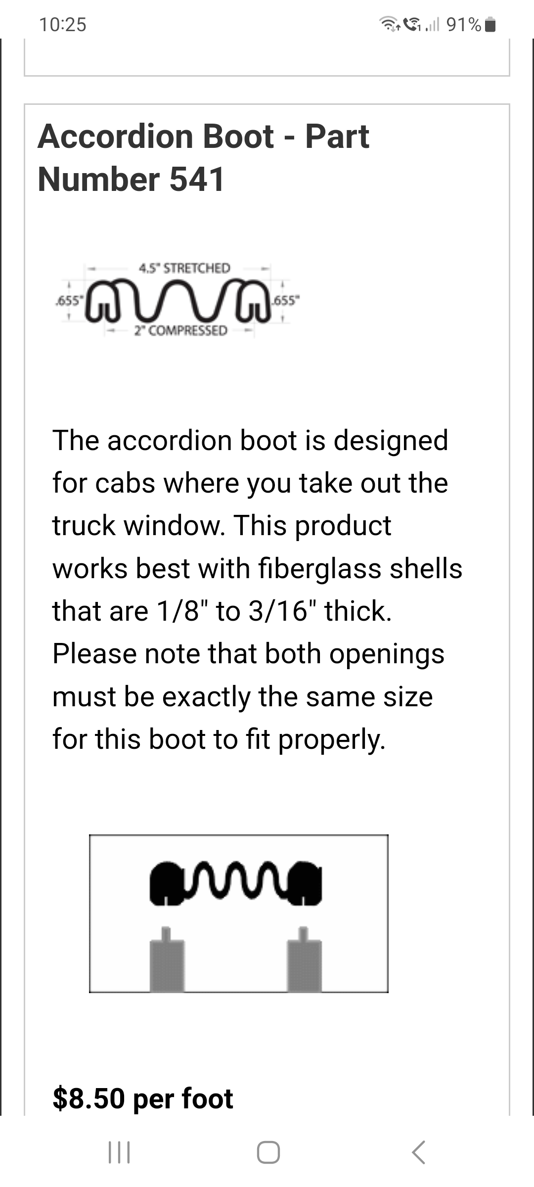

Works well 👍
Thanks for that.. I wasn’t aware that there was a gasket made to do the job🤷🏼‍♂️ although it wouldn’t work in our situation, as the tin at the back of the van is very ribbed and the front of the box is 13mm plastic!
Anyway iv ordered some neoprene ( wetsuit material ) and I’m going to screw to the wood that I’ve lined the walkthrough with, I’ll leave it loose enough so any movement doesn’t rip it.
i was quite surprised by the amount of movement between the cab & box.
