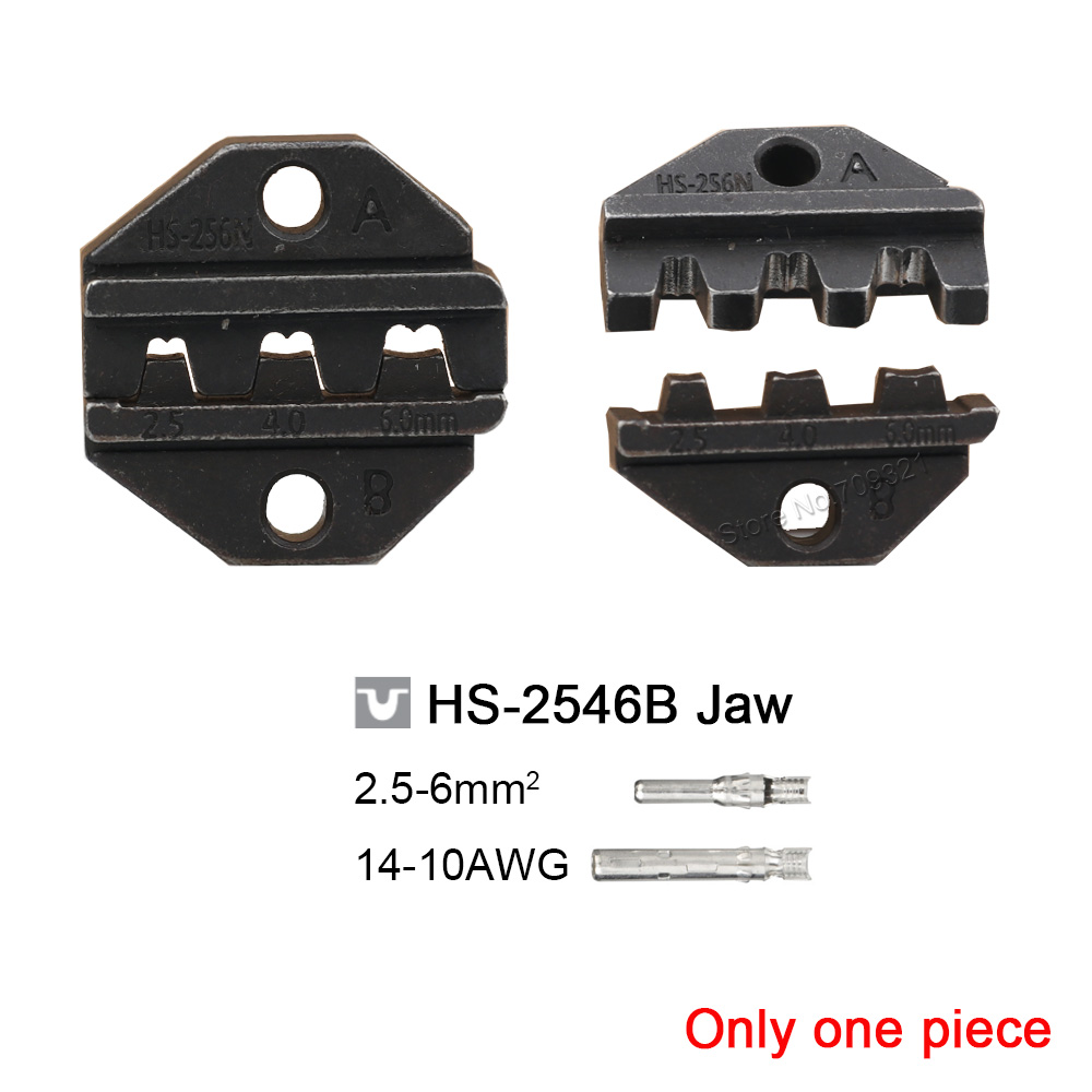

Interchangeable Die Set Pliers Attachment Jaws For Crimping Tools (ebay) 5 to 8 pounds
Question What are the codes / name for the mc4 as there are a lot of them ?
TIA
never actually searched for these until you posted this.
I have now :)
Here you go - https://www.aliexpress.com/item/4000570644746.html?
You want the "2546B" insert for MC4 Terminals
These will suit 2.5mm, 4mm and 6mm cable, which are all the normal sizes for Solar Cable. (I am guessing that is where the "2546" name comes from for this item?)
