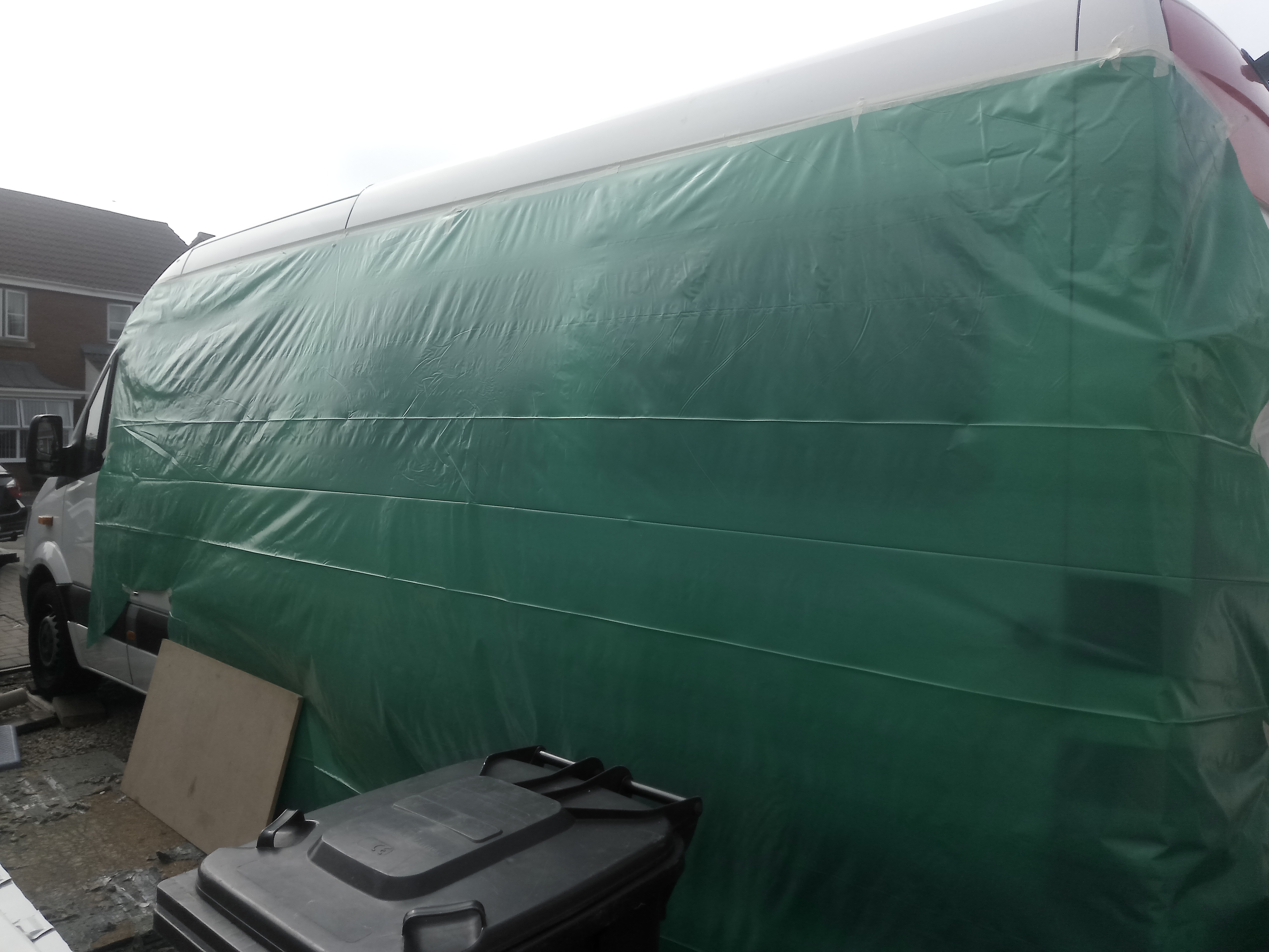

Hay mod please asked Geeky to add this account to 1cup on wild camping and motorhomes please as I think he's keeping his distance
And I'm going green.
