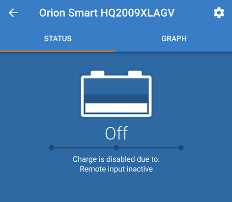

A little post about the a feature I noticed/discovered about the Victron B2B Charger which is kind of linked to this discussion ...
I am using a Remote Input Control feature on the Victron to disable it when the Cyrix VSR is active instead.
It tells you when that is the case when you look at the unit using Victron Connect

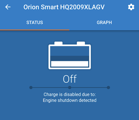

However, that is not the full story! Most of the time, the Charger will be off for a different reason ...
This is telling you the Charger is off as the Engine is off - or more accurately, the input voltage is under the turn-on threshold value.
Same Difference though? well, actually no! The Charger being off due to the voltage being too low is the first condition that is checked for and the Remote Input is secondary.

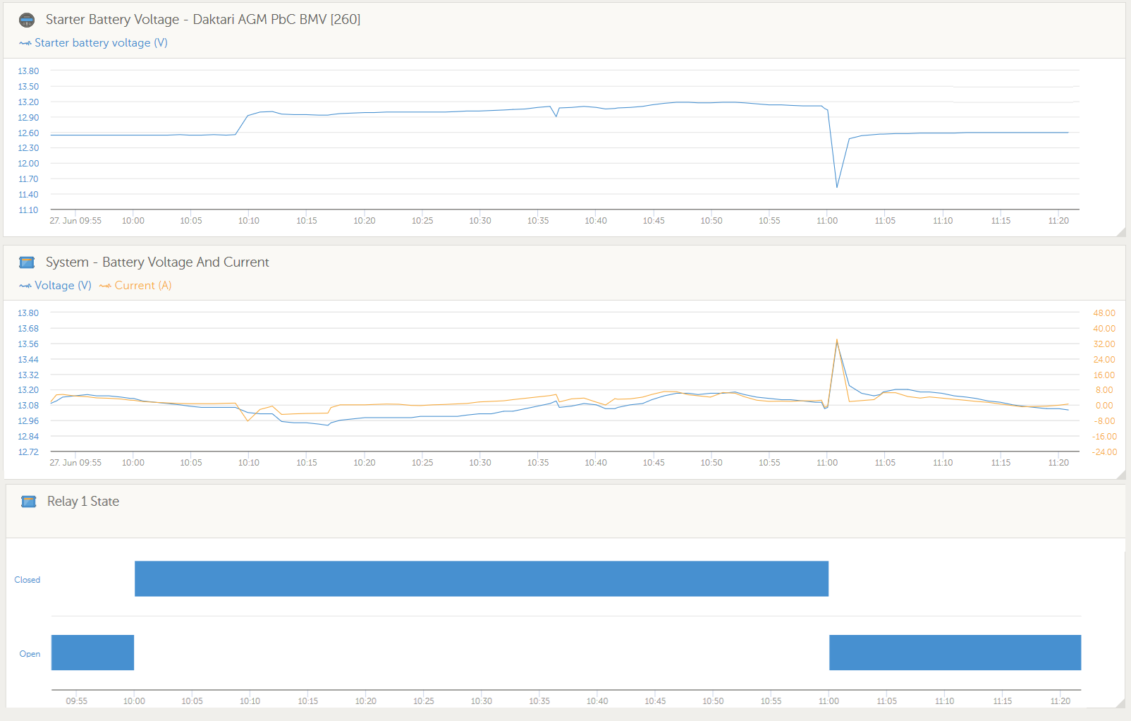

I found this was happening for the last few days as I have my van setup so the VSR is enabled for an hour each morning to let the solar do some Starter Battery boosting. This raises the Starter Battery voltage enough that the B2B turn-on threshold (currently 13.2V) is reached, and even though the B2B could not go on (as the VSR is on and it is one OR the other), it remembered it 'wanted' to. So as soon as the VSR went off, the B2B came on, and the Starter Battery voltage instantly dropped as it was suddenly supplying 30A to the Leisure Battery.
You see from the graph below at 11:00 the VSR goes off (the VSR is on from 10:00 to 11:00 each day), The B2B is no longer disabled and kicks on due to sometime in the last hour the starter battery voltage must have hit 13.2V even though it is below that at 11:00.
But does it really matter? Well, not really at the moment here, but depending on the voltage parameters you set on the Victron B2B, you could end up with a situation where you are putting a trickle charge into a Starter Battery as a maintenance thing and then wiping out that good work by taking a big slug of juice via the B2B, so it is something to be aware of I think, especially if you have an 'unintelligent' Starter Battery Maintainer such as a Battery Master, a Solar Charger that trickles a current as a secondary output or a basic connection.

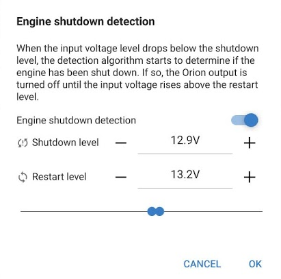

I chose the thresholds on my Orion Smart-tr to be suitable to go on when the Engine starts, but I didn't really take account of the effect of the Solar on the Starter Battery - because I knew the B2B could not go on when the Solar was boosting the Starter - but I didn't realise about the Victrons apparent Memory.
An easy fix - just change the parameters (These are my current ones that I need to alter)

I replicated this yesterday specifically by turning on the Relay for a few minutes (to disable the B2B while enabling the VSR), and then whilst that relay was on, turned on the engine for a few seconds and then off again. I also had the headlights on full beam (so around 220W as my dipped stay on with the beam) to avoid the starter battery maintaining any high residual voltage after turning off the engine.
This graph shows the time from just before the regular 11:00 B2B switch-on (not changed the voltage threshold yet) to my little test.
(note that the timeline on the relay graph is a little offset so it doesn't line up when scannng up and down - you need to look at the X-Axis to compare the times - usually I adjust to line it up for better visual viewing)
The info bubble for 11:37 shows the highest voltage that the Venus polled since the last switch on - just 12.84V (the on-threshold for the B2B is 13.2V). The first dip before that time (at 11:36) is when I turned the ignition on and the glowplugs come on (there is always a significant voltage drop with that I see from the cab voltmeter - actually drops to 10.5V for a few seconds!); then the engine start and so voltage will have shot up to the high 13Vs with the alternator - only for some seconds whilst the engine was running, so not long enough for the Venus system to have logged it, but the Victron B2B will have detected it and tried to start - if only the remote input hadn't disabled it!
Then at 11:38 the Control Relay went off, sending the Remote Input "L" down to ground and removing the Remote Disabling line. Victron B2B now remembers it wanted to start and without checking the current Voltage threshold, just starts, crashing the Starter Battery Voltage down to 11.70, and then turns off again as the off-Threshold Voltage was met. Now bear in mind the Input Voltage at 12.84V was actually BELOW even the off-Threshold at the time the B2B started up, let alone being below the ON-Threshold and there is a definate bit of coding that should be fixed IMO.
The chance of it having a significant impact on something is pretty slight, but it really is not working precisely as it should IMO.
(as an aside, you can see that at 11:36/11:37 in the second graph the current goes to around -20A. The Cyrix-ct VSR Relay is not just enabled but actually on as the Leisure Battery voltage is high enough (from solar charging) so what you see there when the engine is cranking, the Leisure Battery Bank is providing assistance to the Starter Battery to start it. It doesn't really need it and 20A is nothing really compared to what is needed to start an engine, but it shows how the Leisure Battery Bank could help if needed and the Victron Cyrix-ct does feature a potentially very useful "start assist" feature that can force it on regardless of voltage level (as long over 4V))
