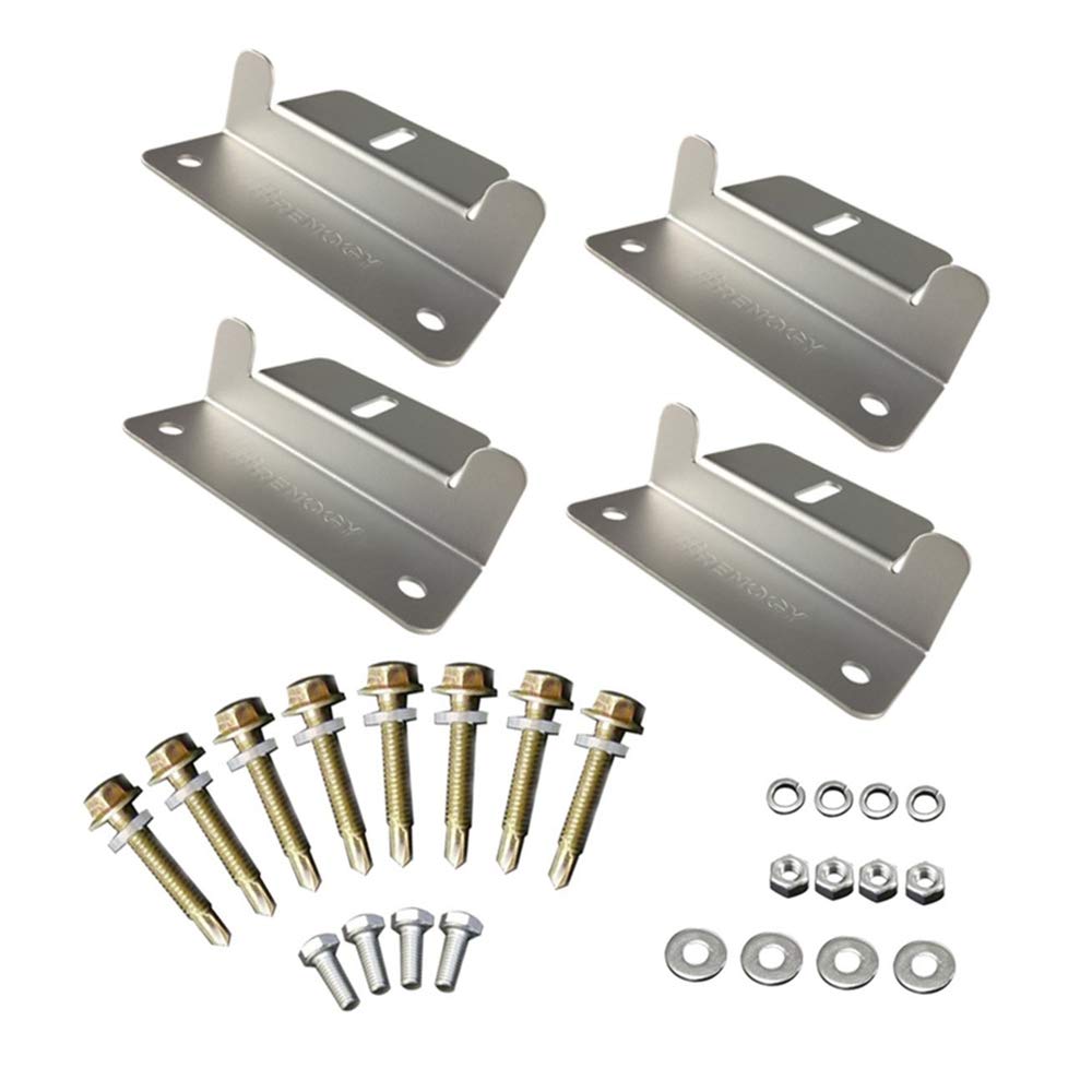

You get 4 brackets, 4 sets of bolts, washers, lock washers and nuts, and 8 self-trapping screws with plastic washers. Price varies between £7.50 and £12 depending on time and seller. I have always got mine from Amazon. The last ones I got were just a couple of days ago and were £8.20 (today they are £9.30 - the price of these fluctuates constantly)

And a good photo showing what you get (I actually got 8 ring washers, not 4, as it happens and I think that is correct)
