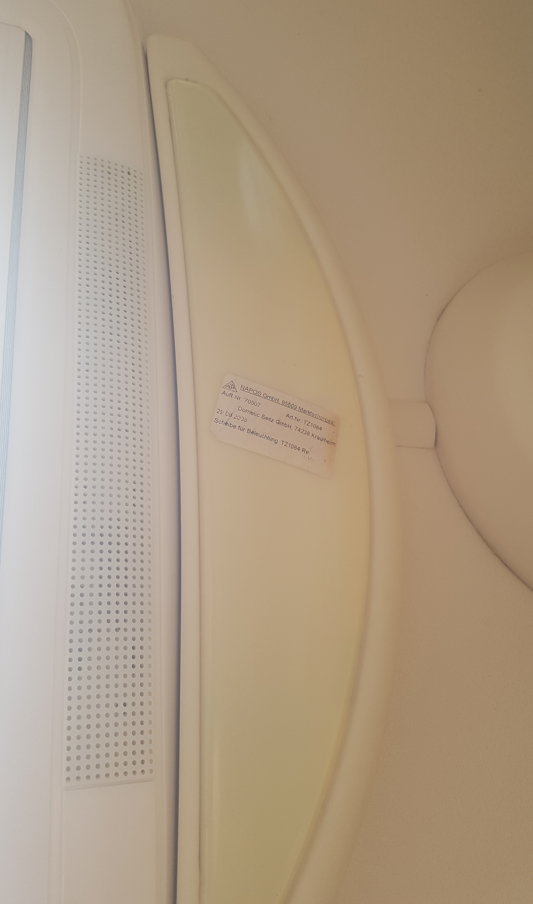

I'm having to do similar but less complex. previous owners of the present van never bothered to remove the protective covers of the ceiling light lenses, and the covers had labels on them which to my eyes was dreadful and lazy so off they came, disaster they had faded except where the label was.
I've bought some Perspex off eBay big enough to cut them out of and after 3 attempts I got the opacity right so it allows light through but you can't see the gubbins above, I keep meaning to buy a fine jigsaw blade so I can cut them out, fixing will be a challenge but I think 2 SS screws will work.
This is most likely our last vans as we can't really downsize from this as they don't make a PVC to our needs.

It is so strange the labels on a light were never removed. why would someone leave labels on lights?
Pudsey Bear
I dunno it had 5 owners when we got it, must have all been muppets easy to believe as I had a lot of work to do on it mainly cosmetic and fixed with superglue, plugs and longer screws maybe they all had stiff necks and never looked up, but even then tey would see it laid in bed and that would drive me nuts until I'd taken them off, but they didn't look like they had seen a finger nail on the labels or the plastic wrapping
This is the actual label I pulled off, but I never managed to find any replacements, but that was almost two years ago.

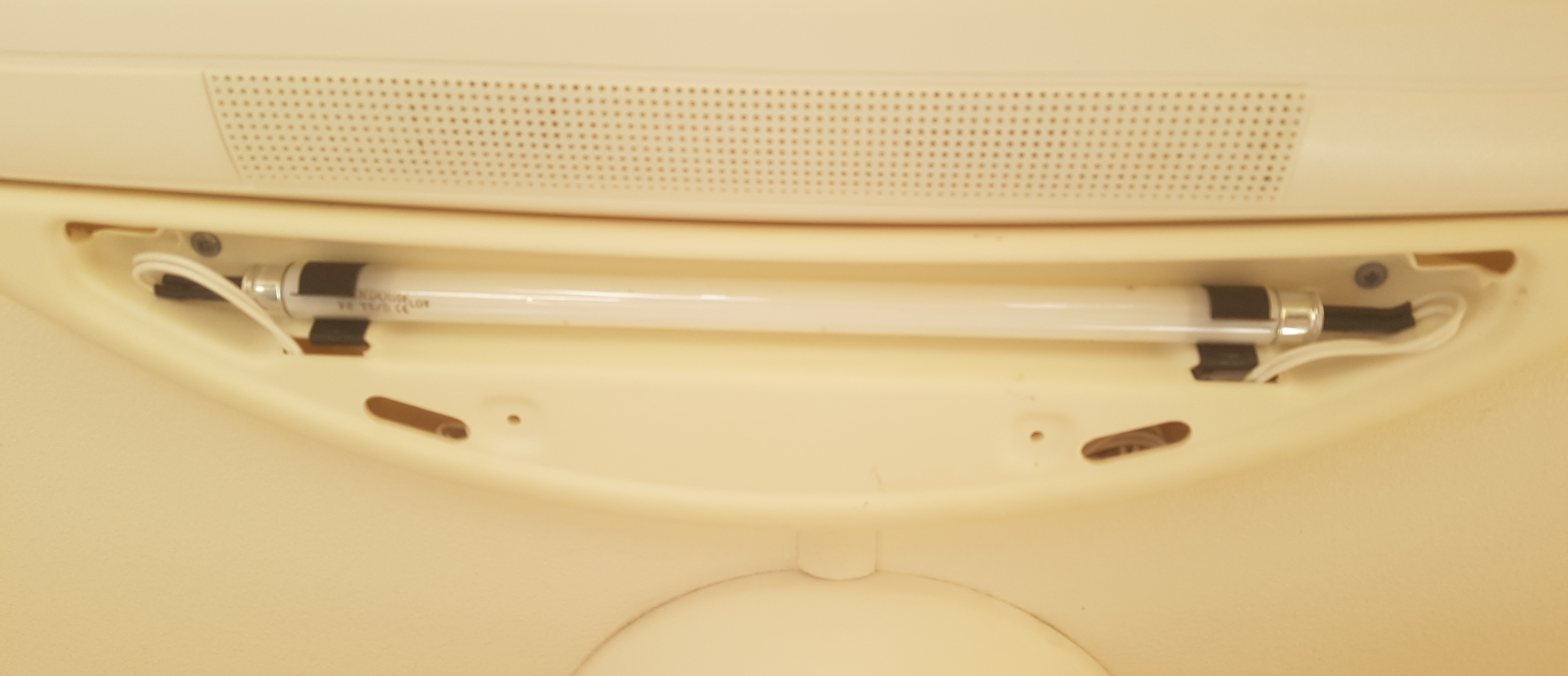

that's a pic I took when I took the lenses down Trev, I have already fitted the new LED tubes, work fine but we rarely use them.

Fluorescent tubes are hardly any different to led for power consumption, at least the size you usually get in motorhomes aren’t (12v ones)
Pudsey Bear
10w for the flo, and 4.5w for the LED tubesI got, 300mm
