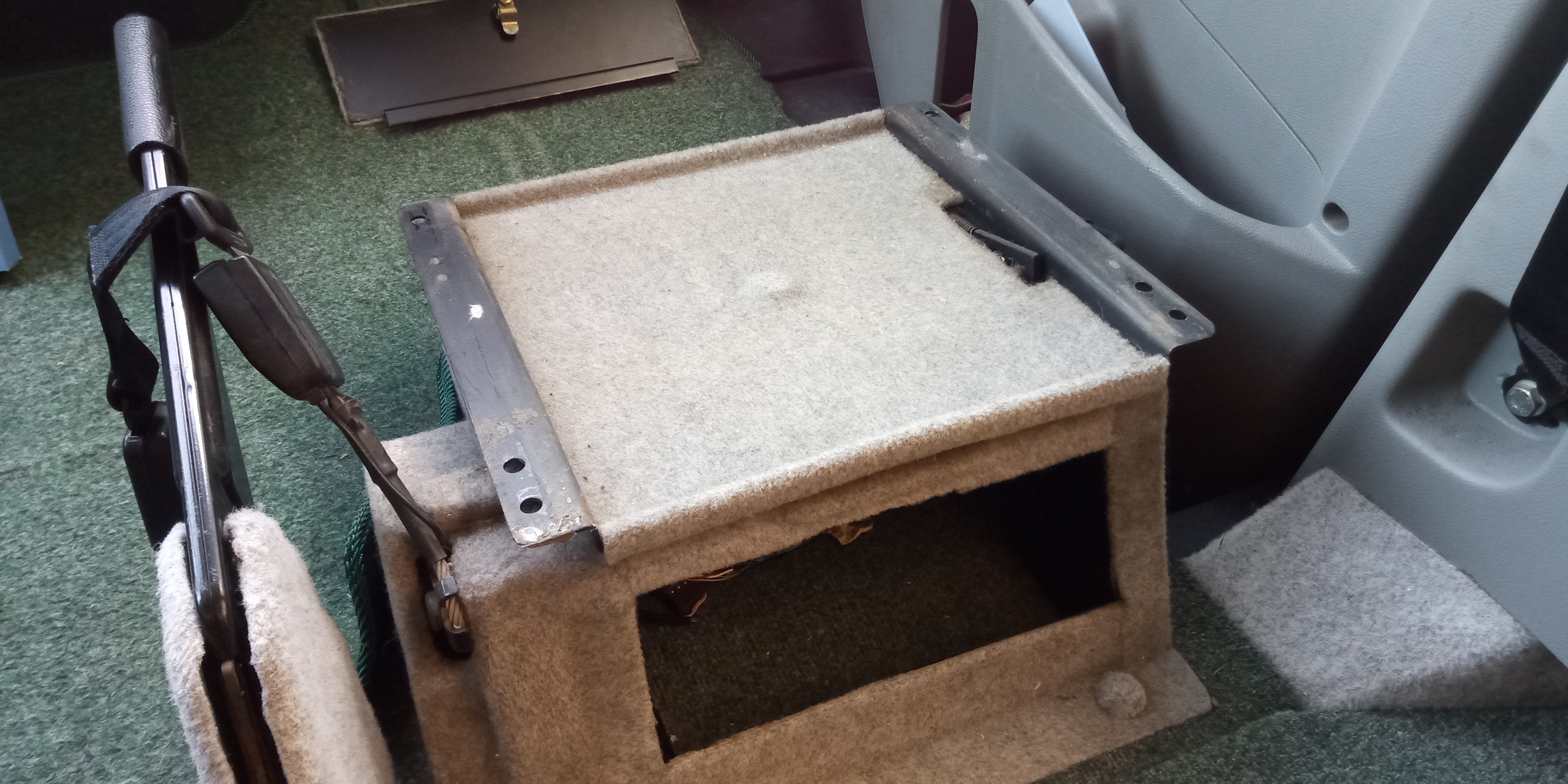

DnK, my 2005 Master has swivel driver seat on one of those combined safe/seat bases with standard handbrake and it can swivel. Have to move seat back / forwards and tip back rest as far forward as possible to clear the steering wheel but can get there.
Image with seat removed - not a brilliant picture but may help.
Yeah have to juggle a bit to get the passenger seat around but will get used to that. From 2010 they must have changed the seat base height because mine wont swivel even with the additional seat height increase of 30mm and where you can find the driver seat swivel for post 2010 the suppliers confirm handbrake modification.

Thanks. I'd forgot I had already discarded the possibility of the Traffic one fitting or any other due to the seat base frame shape being angled one end. I have a single swivel seat fitted now and have fitted the camper option handbrake to allow driver seat to swivel. Will post some photos when I have fitted them.

Bought the new part 8200727562 from our local Renault dealer, as brother in trade we got a little discount but not significantly cheaper. They are a bit scarce apparently. Probably why they are taking the pi55 with the cost.
When you post your photos can you advise what is required to fit? From the video looks like possibly top pivot pin out and swap over the lever, or is it complete removal and cable re-adjustment? Thanks.
It's the whole lever assembly and just a 5 min job. This video shows what the new lever does to give the clearance needed.
Check the operation of the standard lever and you'll realise it's not an option to modify a standard one.

There is no commercially available double swivel seat solution. Thats why I went for two singles, the sting in the tail being the high cost of the handbrake that allows the drivers seat to swivel.

See photo in post #29 I got a LHD driver seat off ebay with the seat base. Because the van is available in LHD or RHD the bolt holes are in the cab to suit single or double seat on either side of the cab. If you want to swivel the driver seat you need to get the special handbrake lever to allow it to swivel see post #28 for part number
