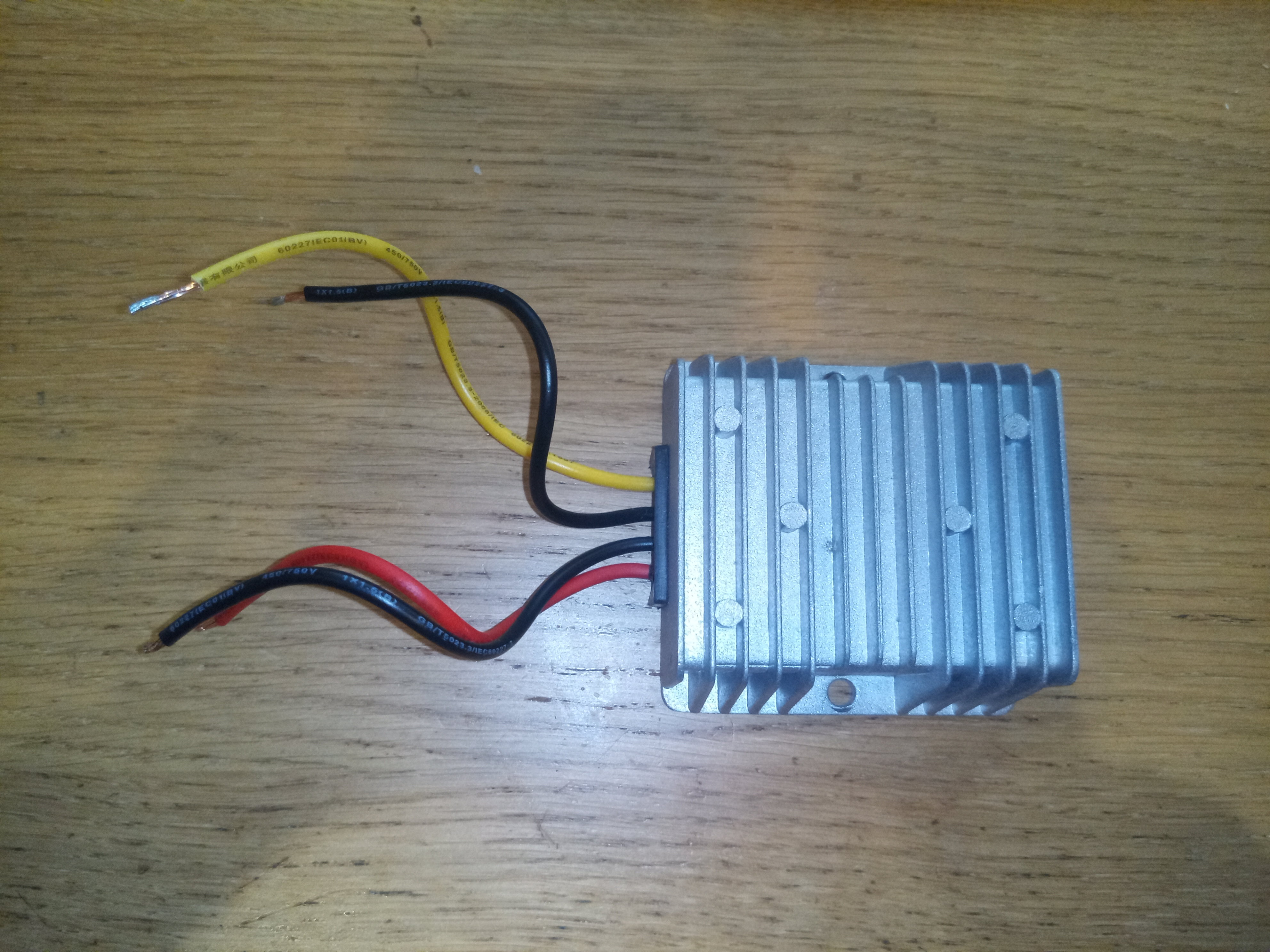

As well as the Regulators, I also tried a DC-DC converter I had kicking around. This was not a very expensive item for the specs (not throwaway money either however).
This is a 248W 12V regulator, but I don't think it is really designed to be on 24/7 and it failed after a few months of constant use.

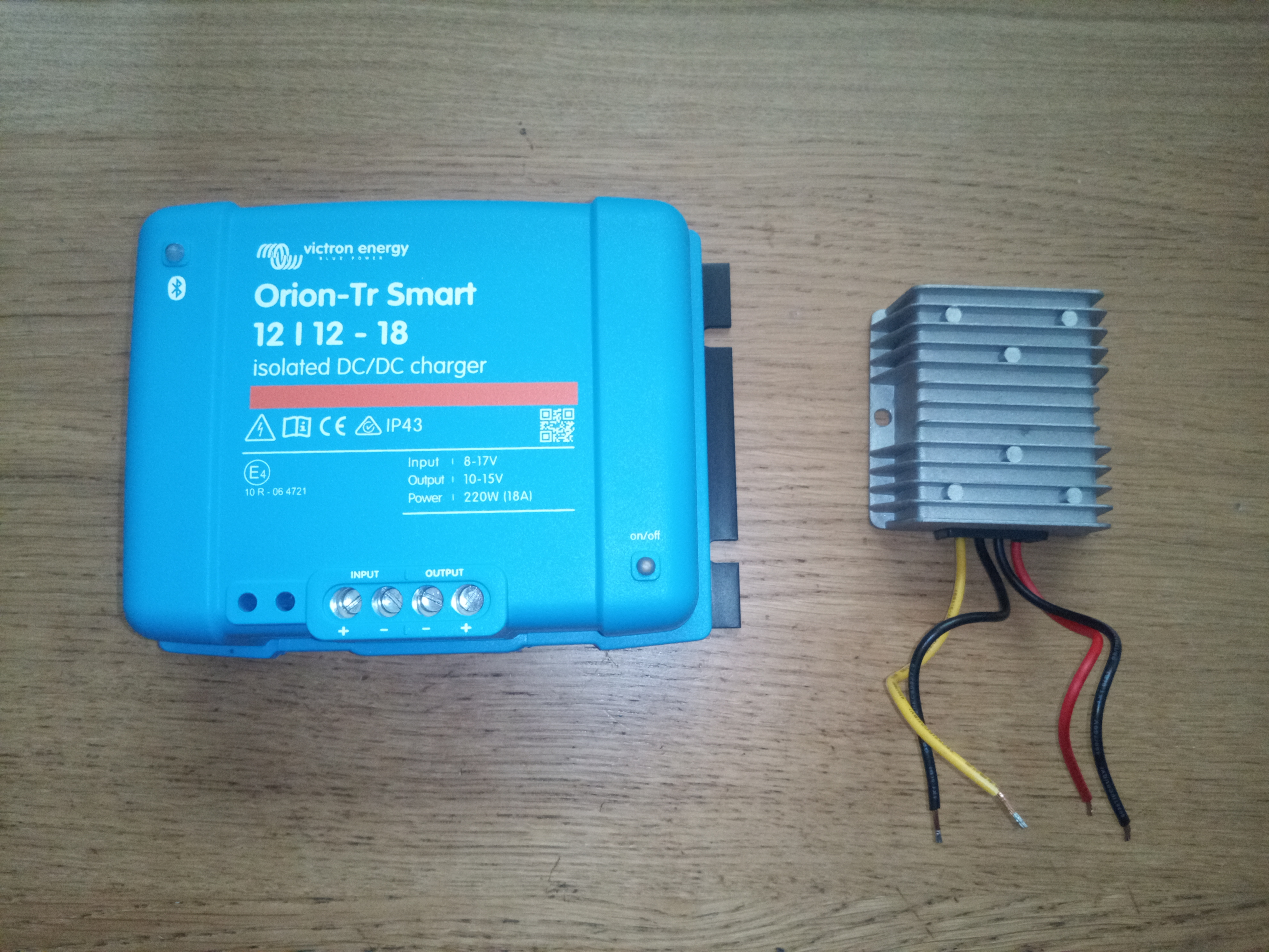

It is, I guess, a matter of 'you get what you pay for', so I decided to bite the bullet and go for another Blue Box from Victron.
So now to compare the 220W Victron DC-DC Converter with the generic 248W DC-DC Converter, there is a slight difference in the size ...
I am totally confident that the Victron Orion will be happy to be always on without a problem (and of course, there is a 5 year warranty if not!).
This is the Orion-Tr Smart, so is generally more usually found working as a Smart B2B Charger, but I elected to go for this rather than the 'normal' Orion-Tr straight DC-DC converter as it is a lot easier to configure and adjust via the Victron Smartphone App and you just set it into Power Supply Mode in order to use as a fixed output DC-DC converter.
This is connected in-between the Battery Bank and the Sargent EC325, so it ensures all the standard Habitation Electrics are supplied with a fixed 12V output (I haven't put a meter on the supply at the point it enters the Sargent unit yet. It might be with voltage drops on the run from Orion to Sargent that I need to up the 12.0V to maybe 12.1V say to give 12V at distribution point?).
The Sargent Hab electrics are protected by a 20A fuse and is limited to no greater than 20A, so an18A converter is just about perfect (I never see more than around 8-9A DC from the DC Habitation demand).

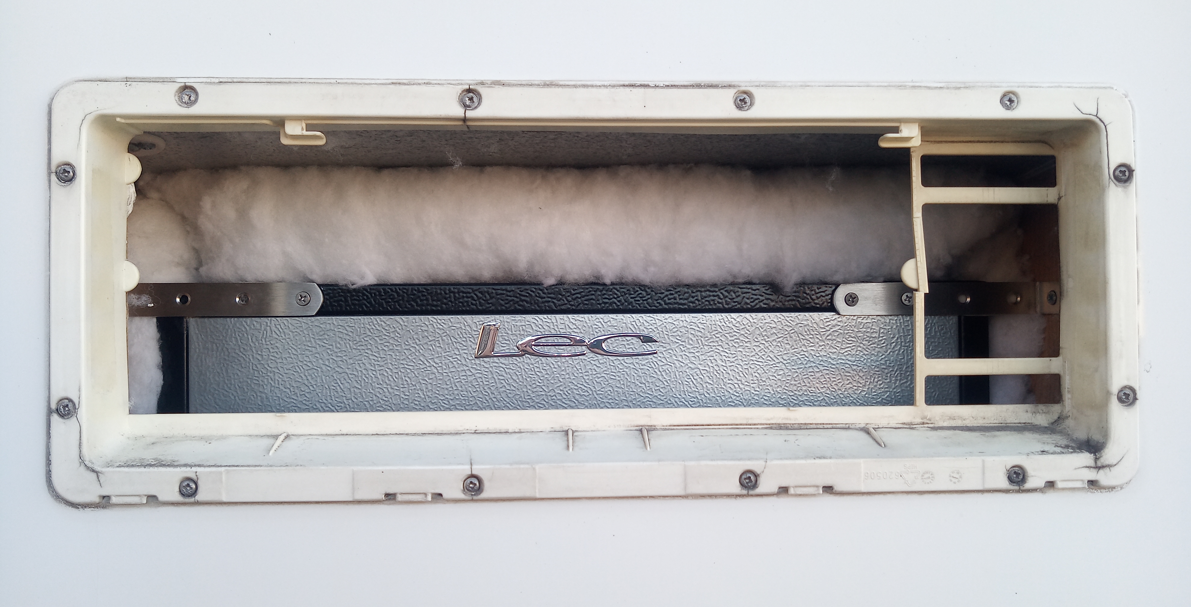

Been doing some work on the Fridge/Freezer to try and make it more effective in the Motorhome (as mentioned above, the Freezer was defrosting because, I think, the rear was too cold).
The other issue I have in this area is I get a cold draft coming through from the rear compartment through the sides of the Fridge and top and through the little gap openings I have for the hinges.....
To fix the Cold Drafts, put some insulation on the sides and top at the back.
So next is to keep an eye on how the freezer is going and if I need to doing anything else. I was thinking of maybe adding a slight heat source if the temp drops, but I could also use some of the leftover insulation to add a temporary insulation batt above the lower vent in the cooler months to enclose the area around the compressor and retain generated heat. (Need to remember it is fitted, mind!)
The cold draft is reduced but definately still happening at the top, so used the remaining insulation to completely block the top vent (not needed at all on a compressor fridge - they need no outside ventilation for safety, unlike Gas fridges) and also put some behind and above the bottom vent.
Will see how that goes for draft elimination now. If it still is ocurring I could pull down the insulation and block off the lower vent as well and see how that goes, but will need to remember to remove around Easter time so the cooling fans fitted to the vent will have a route for their cooling!

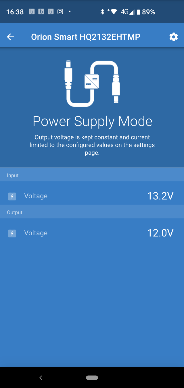

Today, checked the voltage on one of the 12V distribution circuit cables coming out the Sargent and there is quite a voltage drop! the various internal relays and componentry within the EC325 is certainly having an effect on the level (and interestingly the Voltage reading on the Sargent display, while not accurate as a BATTERY measurement, is actually pretty accurate as far as the SARGENT OUTPUT voltage. Is that useful? not really actually!)
I've ended up upping the Orion Voltage Out to around 12.5V to get a 12V Habitation Voltage and removed the first extra Boost/Buck fitted (for one of the Alexa Echos) and will get round to the others in the next week or so)

Have you left the gas drop out vent open?
I can block ours up when I get around to it as there is a separate one for the gas cooker (after removing the redundant gas line from the isolation manifold under the cooker)
I could have capped it with a compression fitting/brazed it shut....
As there's no chance a gas fridge is going back in on my watch.
I was wondering about the gas vent. It is slightly odd in that the drop vent looks to be part of the gas pipe entry, but this goes first to a interior cupboard and THEN externally, so there is a bit of a dog-leg which I *think* would stop a draft as such?
But a good point and what I could easily do (and will do tomorrow now) is stuff insulation into the hole to block off any air (I have not removed the pipe, just capped it and also turned off at manifold), and there is wiring also coming up the same hole so couldn't just put a cap over the whole hole anyway - but stuffing with insulation will do the trick for sure :)
