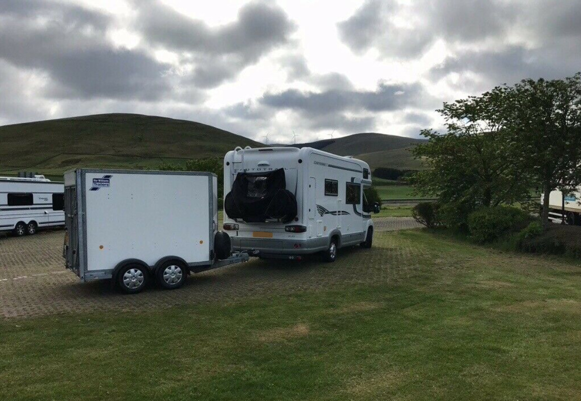

She has been all around Europe in all seasons over the years, occasionally towing a trailer with motorbikes and the like, so a cossetted but very full life :)
I got a very comprehensive handover, with the previous owner then asking questions to make sure I was listening so I could look after his baby properly!
mark61
I got a very comprehensive handover, with the previous owner then asking questions to make sure I was listening so I could look after his baby probably!
I can just see that trailer behind my van now.
Just need to get some toys to put in it. :)
