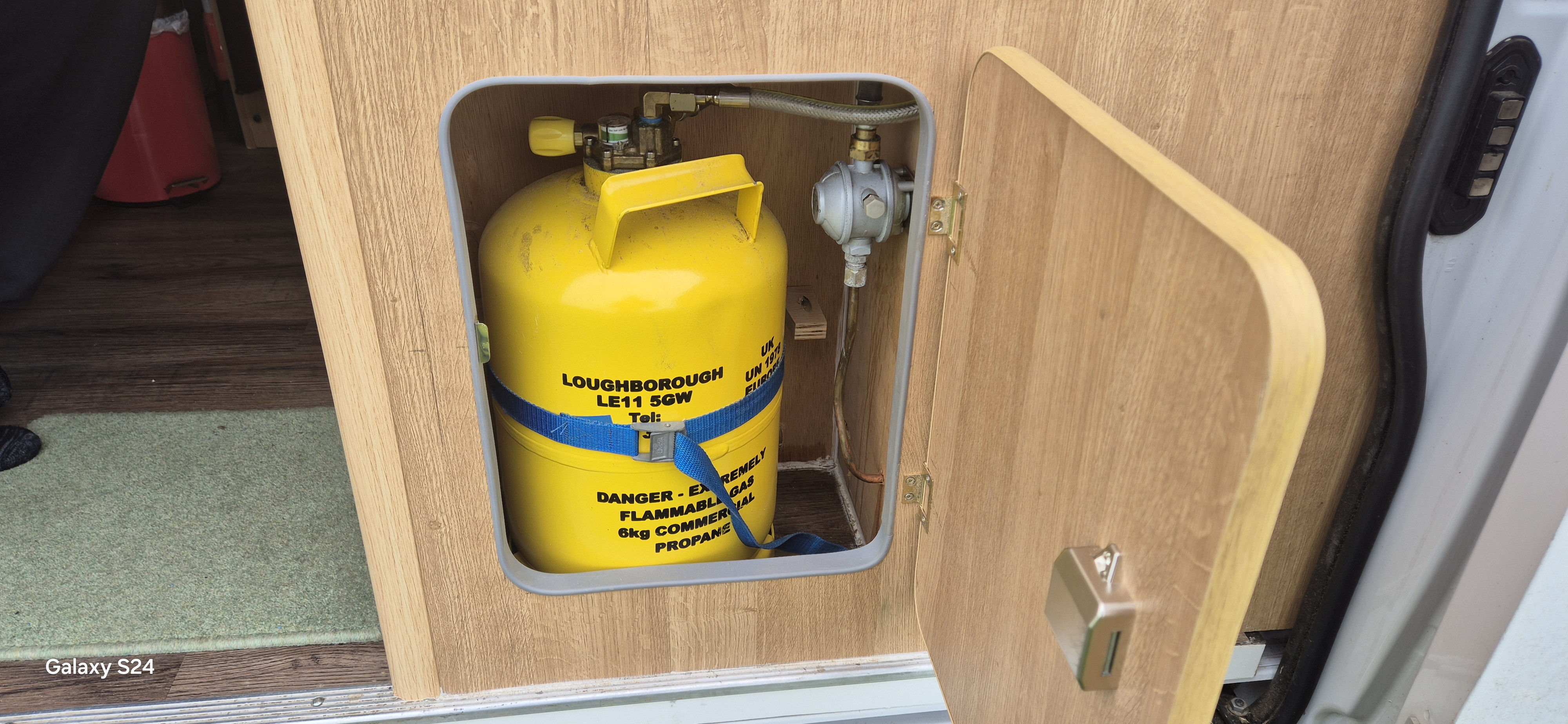

Continuing on, today the Gaslow 6kg bottle and filling kit arrived from Hamiltons in Northern Ireland, they were considerably cheaper than other suppliers and it was only a two day delivery.
This meant that I could now fit the fill valve and the water fitting. The area that was available for both was extremely tight as the only place that they could be fitted was directly behind the n/s B pillar and before the n/s wheel arch.
Measuring and finding the floor height outside and making sure I had missed the B pillar moulded steel was quite frankly intensive, but with care and multiple measurements, I marked the centre of both the gas and the water fittings onto the outside of the van and drilled an 2mm hole through the centre of both, so that I could safely check inside that the larger circular cuts would mis the wheel arch and B piller. I won't show the actual cutting of the holes but the gas apperture I used a 70mm hole saw and for the water aperture I used a compass to mark out an 80mm dia circle, after which the usual drill holes the size of my jig saw blade and proceeded to cut out the circle.
I think I have mentioned it in the past, the best way to cut out in tight areas is to remove the jig saw foot and use the guide roller as a very short foot. By the way it may be my personal choice but my preferred method of cutting appertures in the van sides is with a jig saw, I really can not understand why people insist on using a disc cutter as sparks fly everywhere it's noisy and difficult to keep on a line.
I've put up some pictures to explain the situation. Phil
Absolutely no criticism, simply an observational question for you Phil.
As gas filling points are getting fewer and fewer in the UK, wouldn't it have been better to have fitted a considerably larger cylinder?
Keep up the brilliant work, I only wish it was me doing it!
Morning Phil,
Yes your right of course but I have to take into account the purchase costs. Initially I proposed to my daughter that an exchange 6kg Calor would be fitted and then looked at the cost of even getting a secondhand cylinders's cost ( Have you looked recently ) it's horrendous, not only the initial cost but also exchange costs are eye watering. So I took the decision to go for a new 6kg Gaslow as I have an account with Cardiff Gas here in Barry where I can go and fill up 24hrs 7 days a week using a Tab key for 78p per ltr.
I hear what you say about LPG stations closing down but in all honesty when we are away in the UK if we run low on gas there has always been an LPG station with 25-30 miles of our location in an emergency, plus when on the continent GPL stations are plentiful, the other possibility is Gaslow do a system change over where you are able to have a exchange type bottle in reserve if necessary, a bit like a twin bottle change over system. Phil

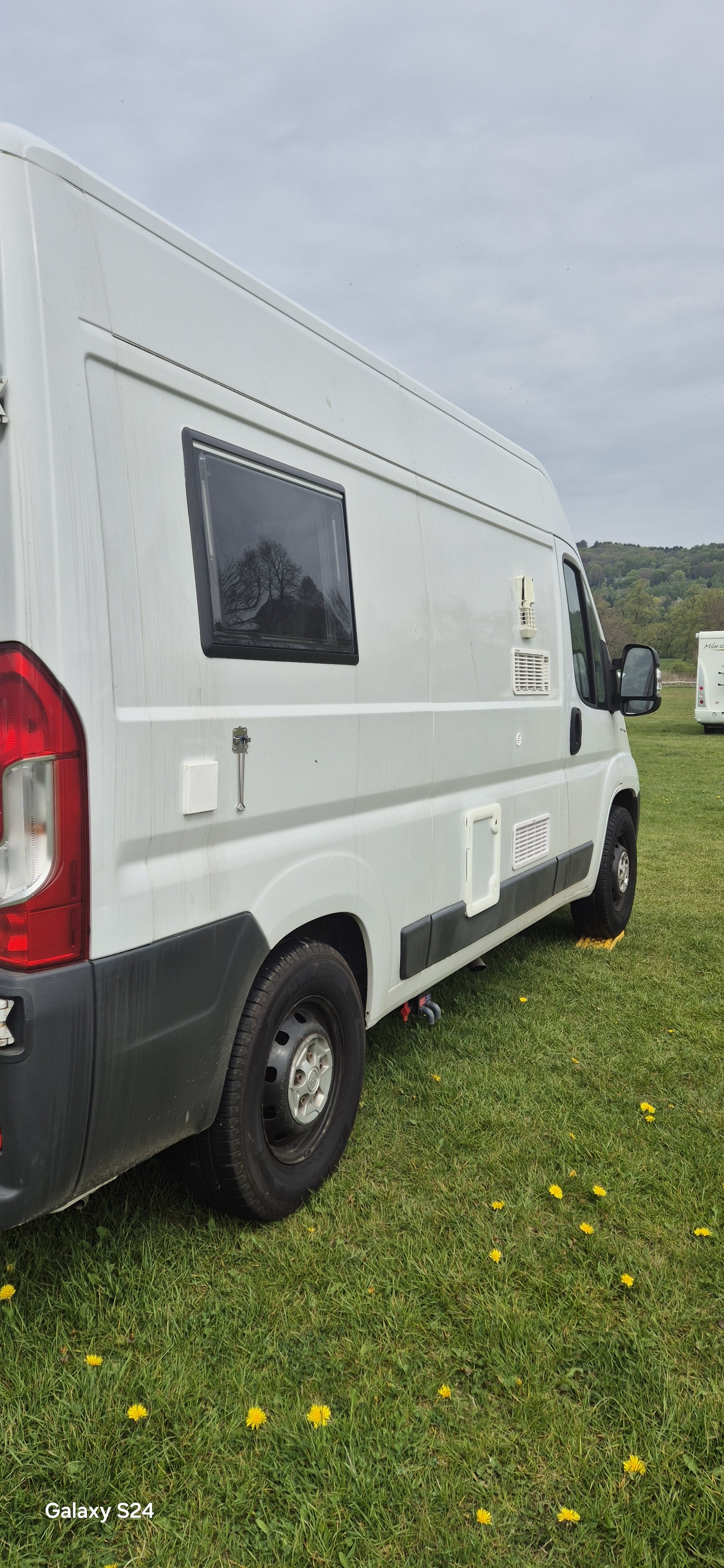

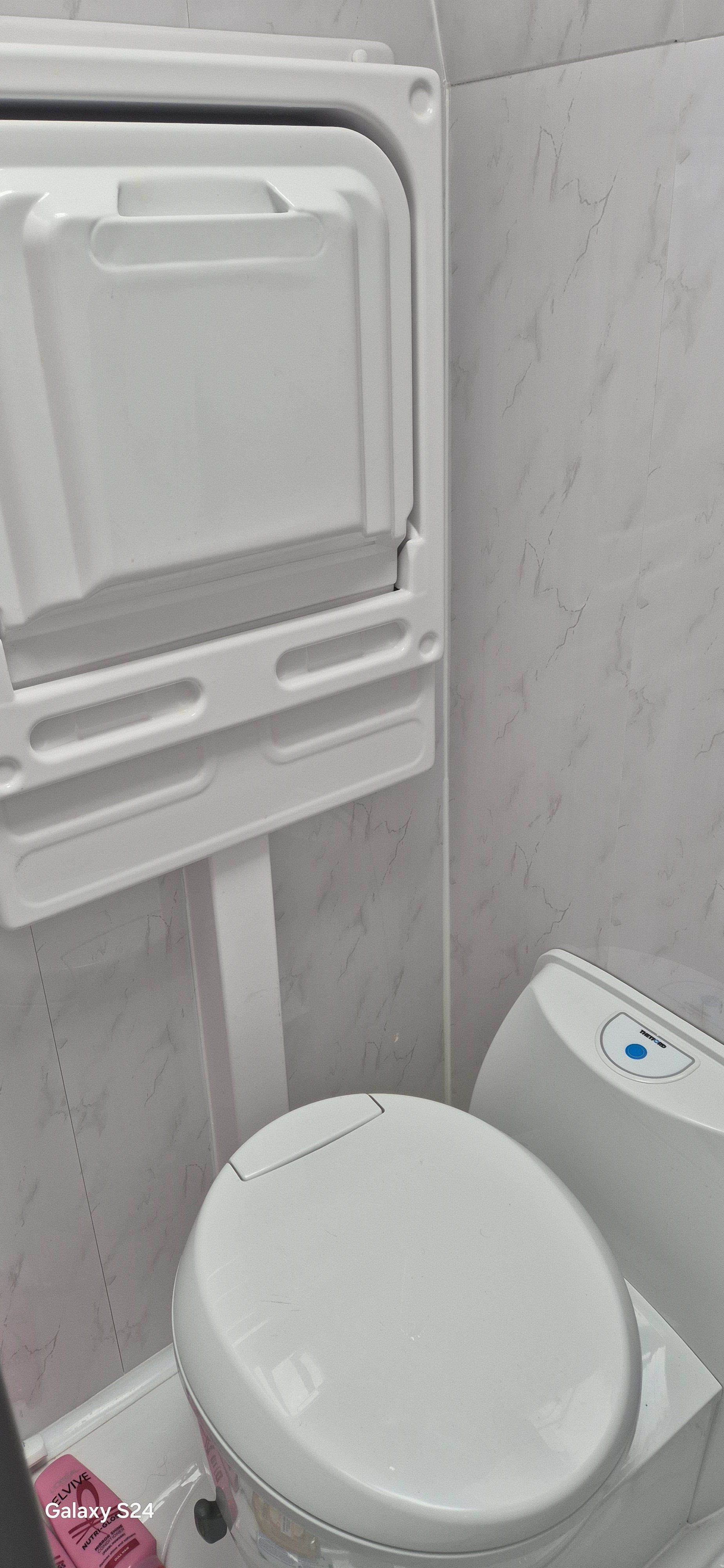

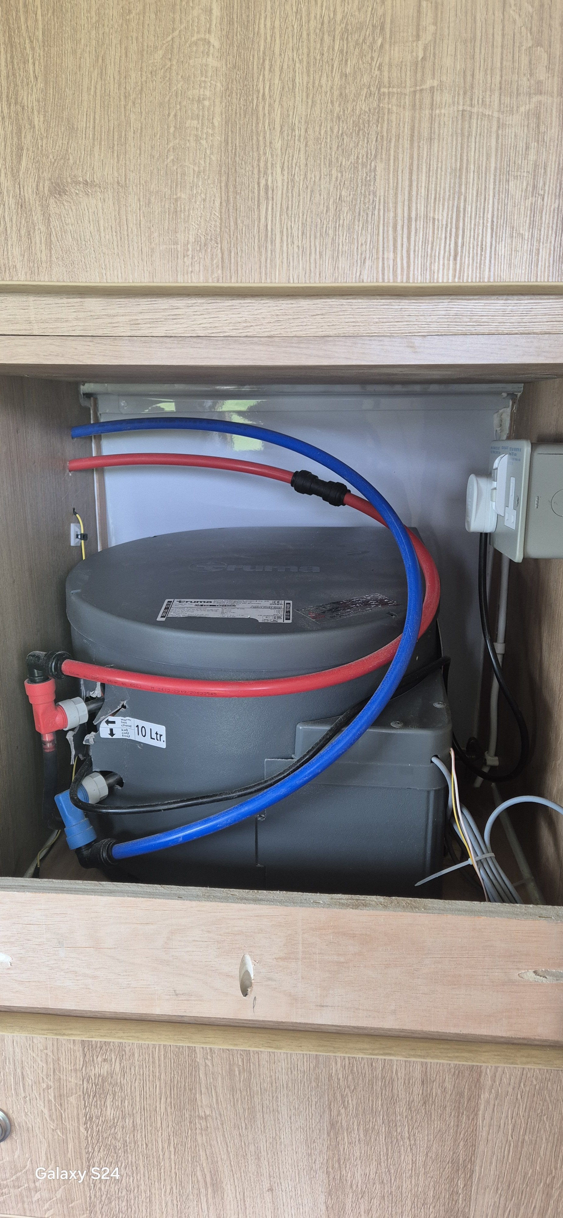

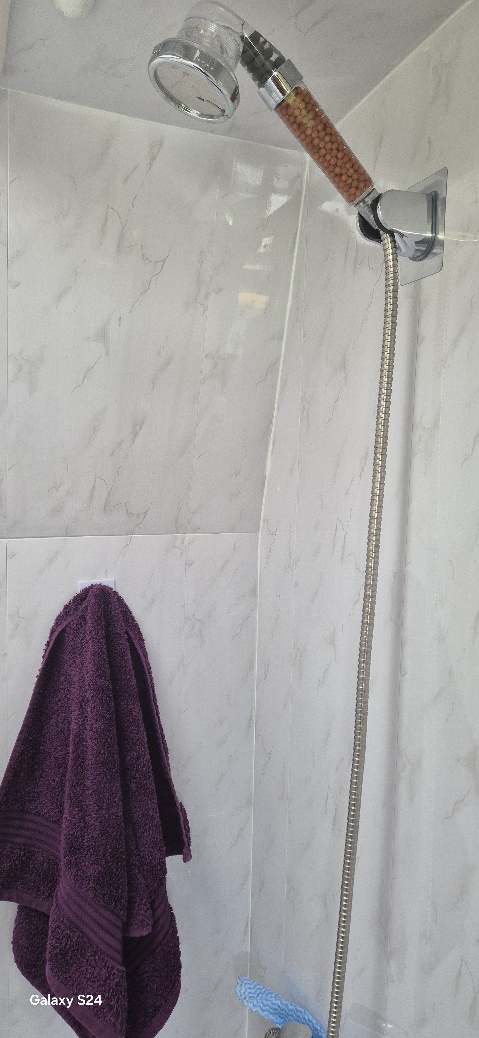

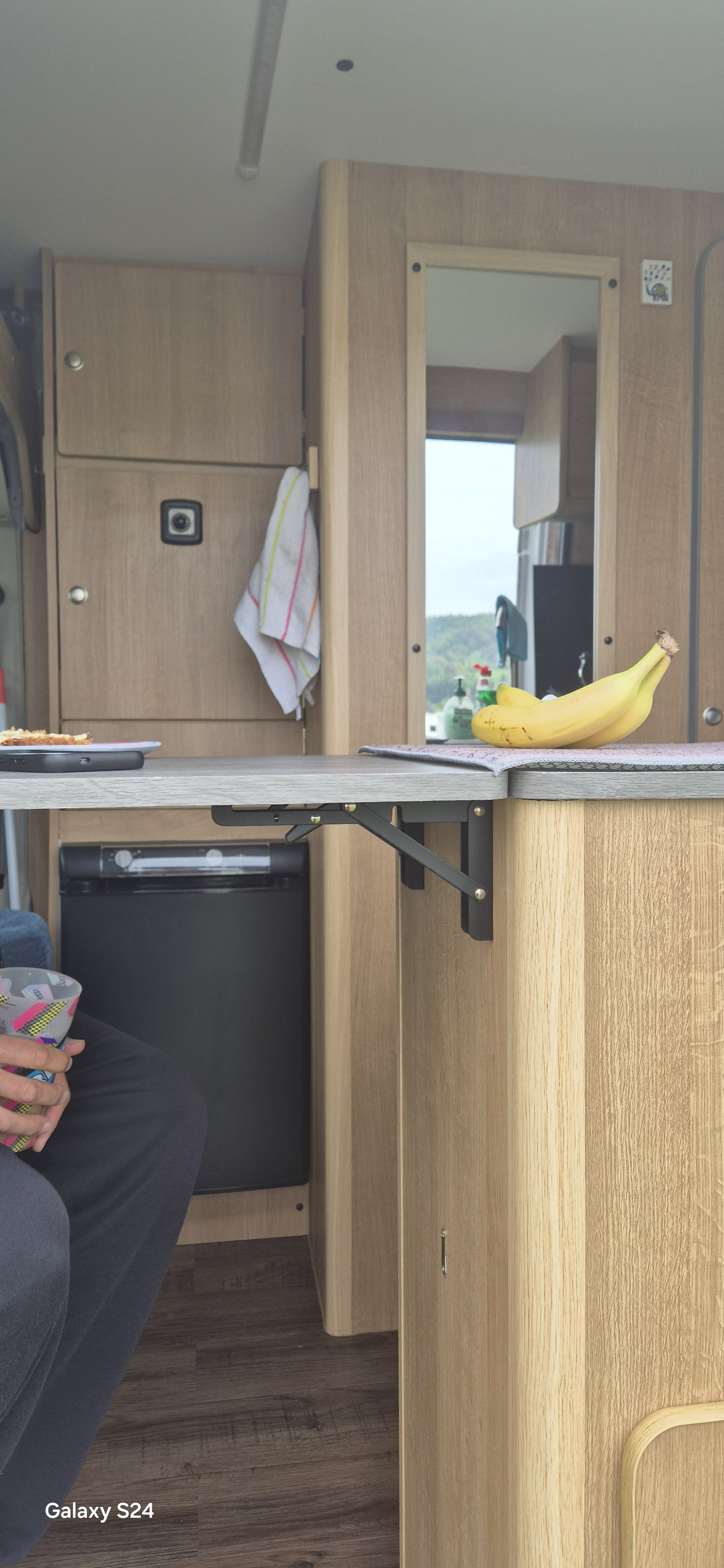

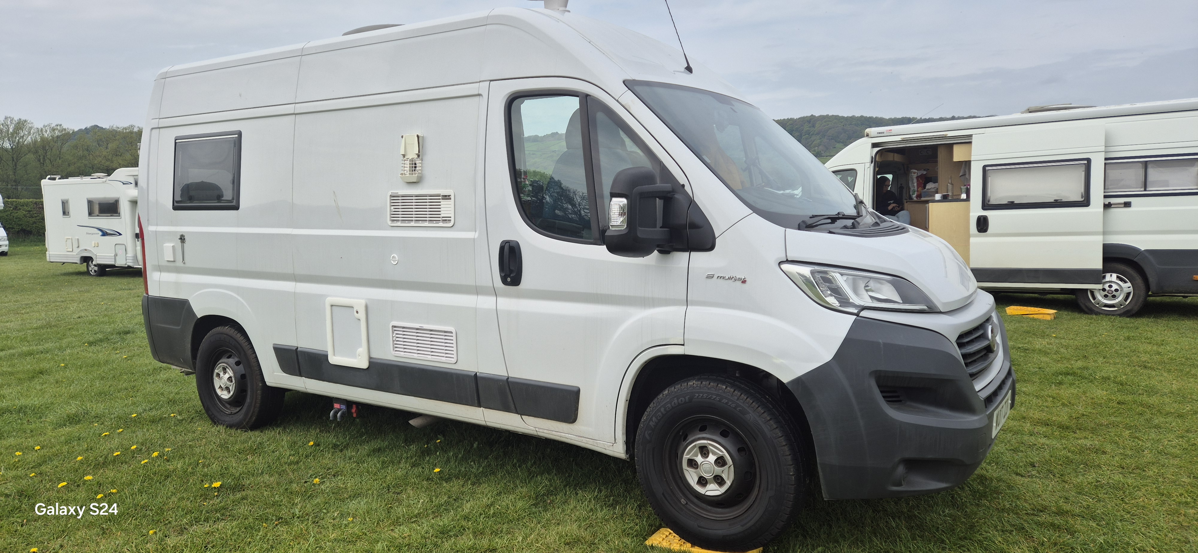

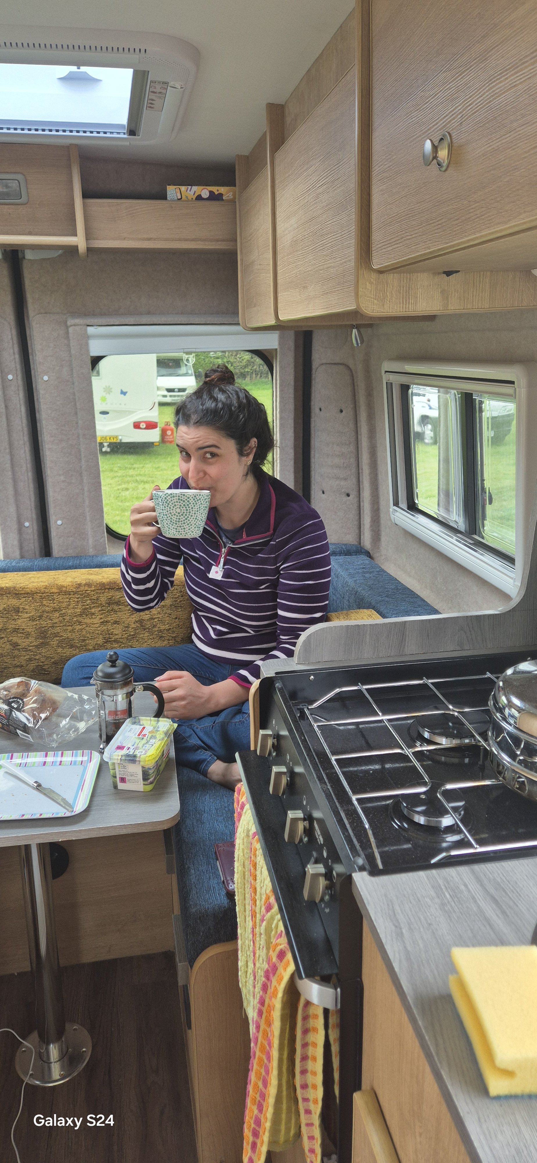

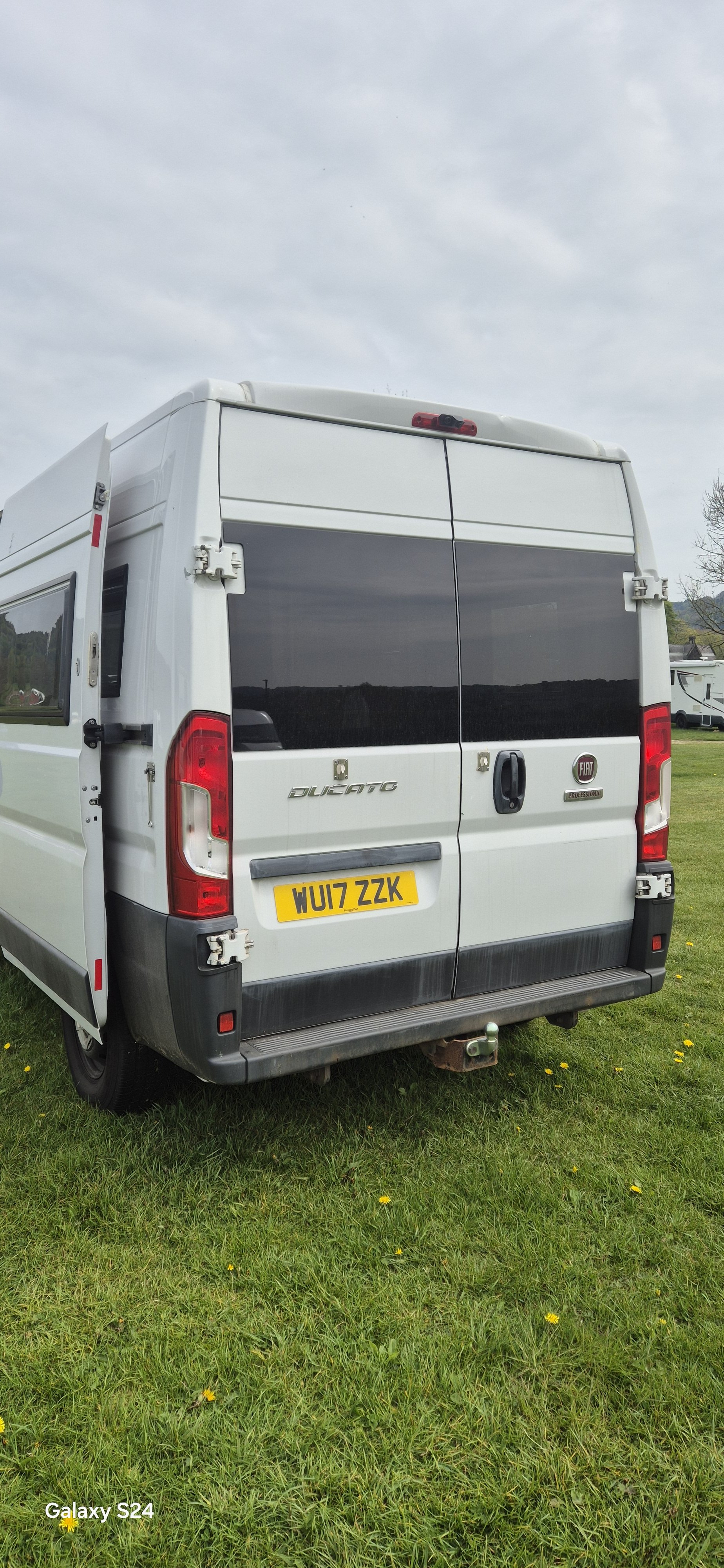

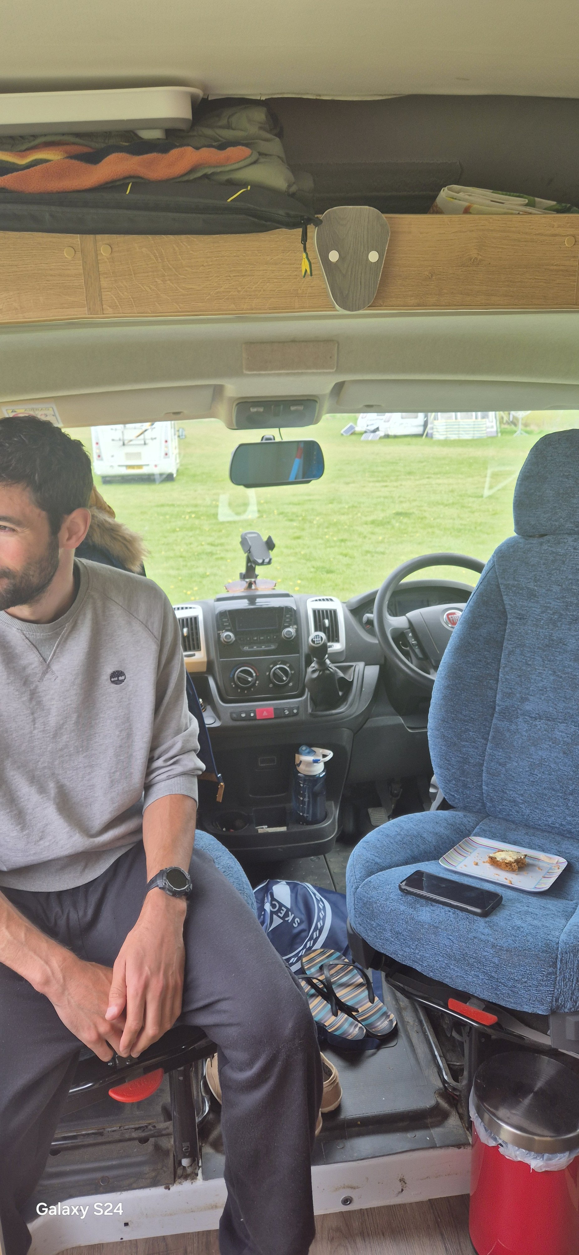

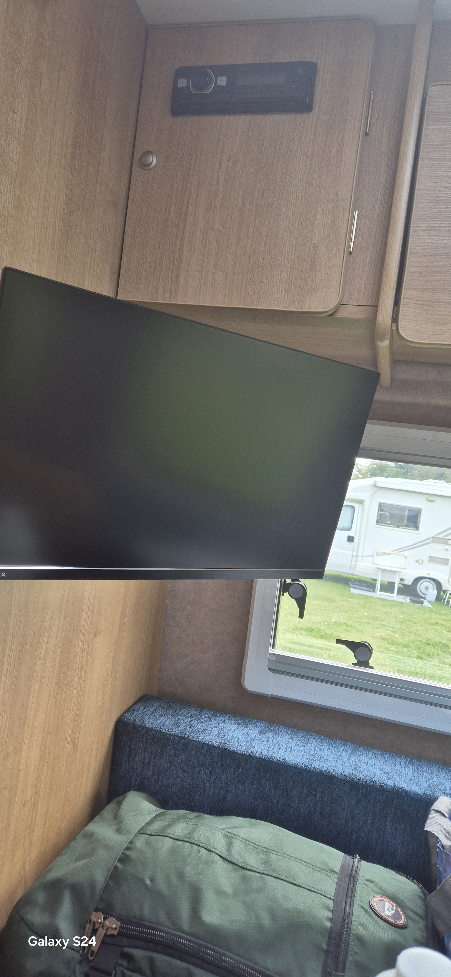

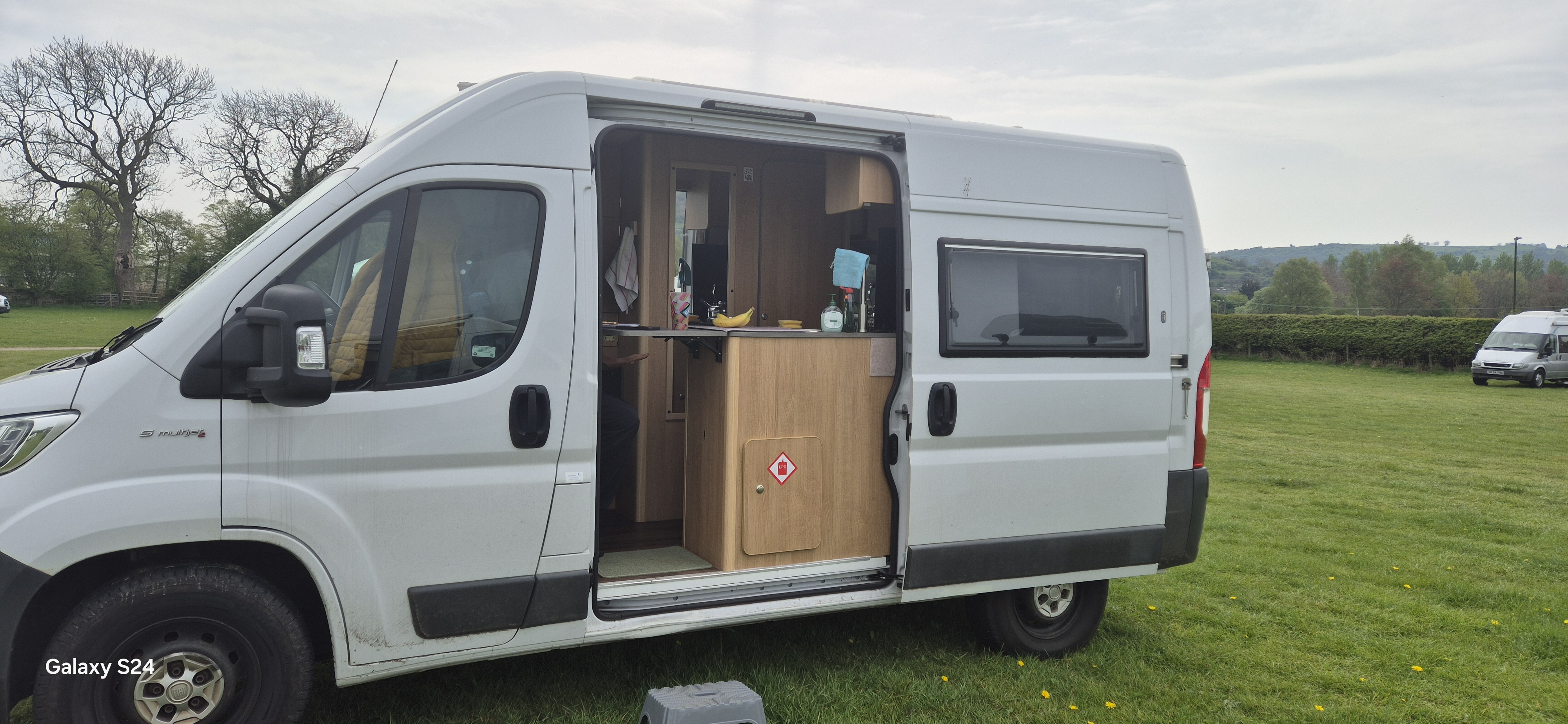

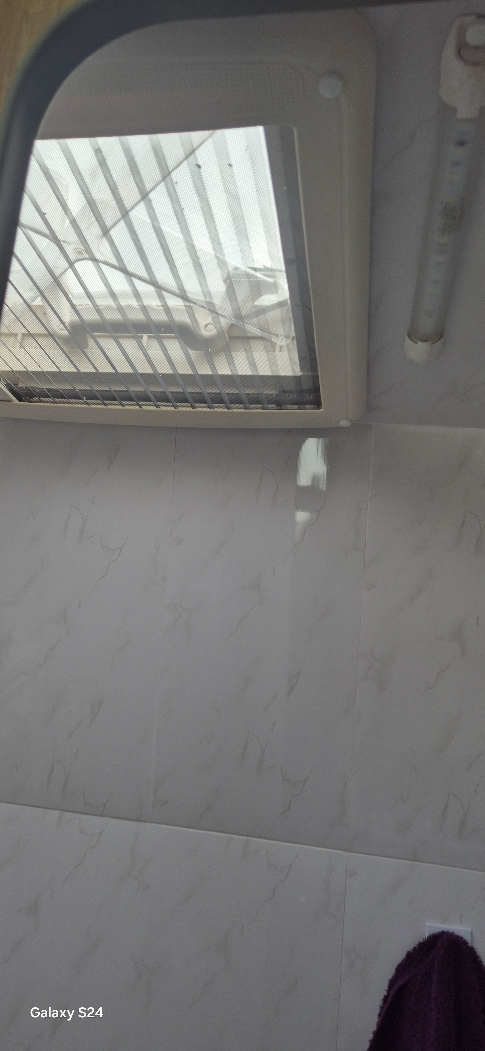

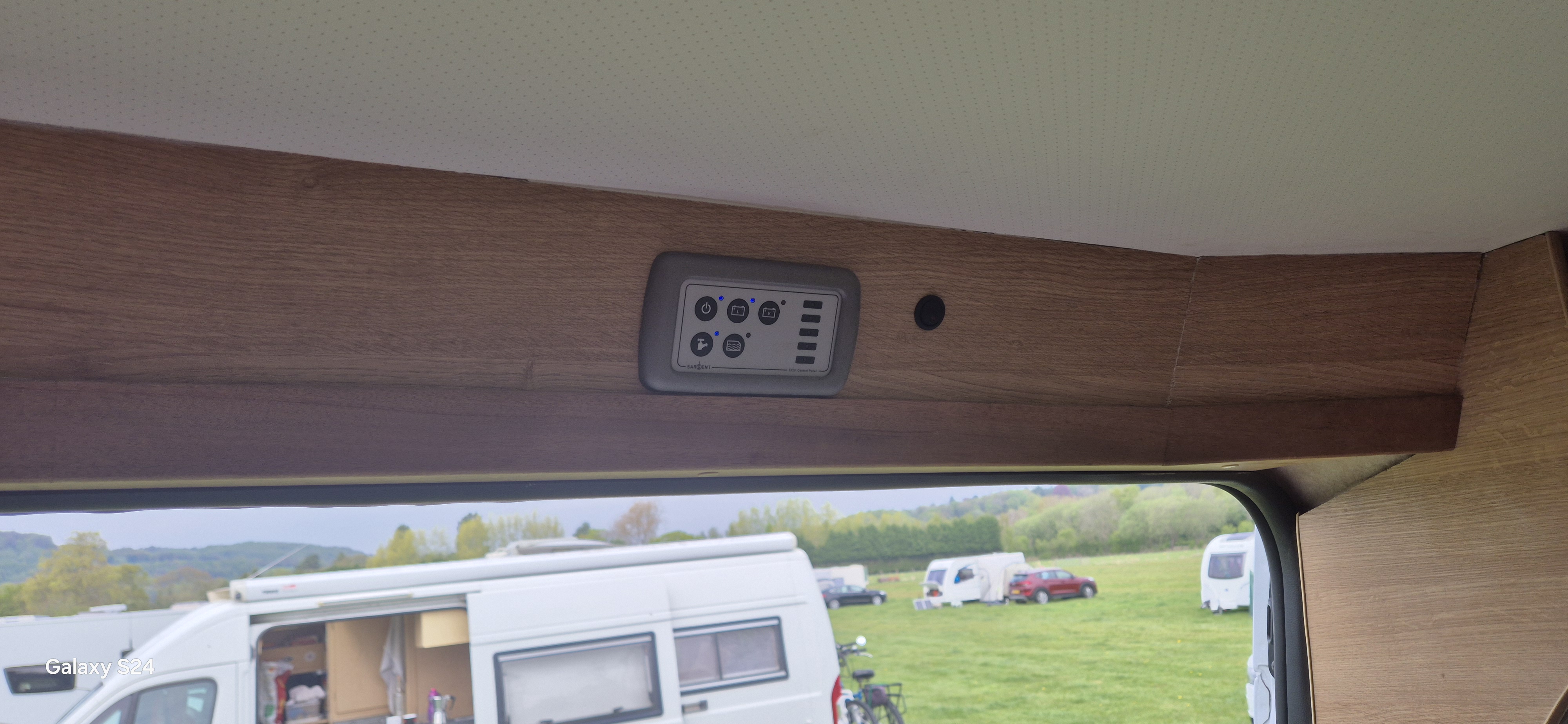

I know I stopped posting about my daughters van build but I thought I'd post some photos of the finished article.
My daughter on site with us in Darley Dale near Matlock this weekend, on a Camping and caravan rally. Phil.
Thanks Phil, to be honest I only put the
photos up because I'd started the thread and thought I should show the finished product. But the photos don't show the technical head aches I went through on this one, as the space usable made it difficult to fit everything in. Phil
