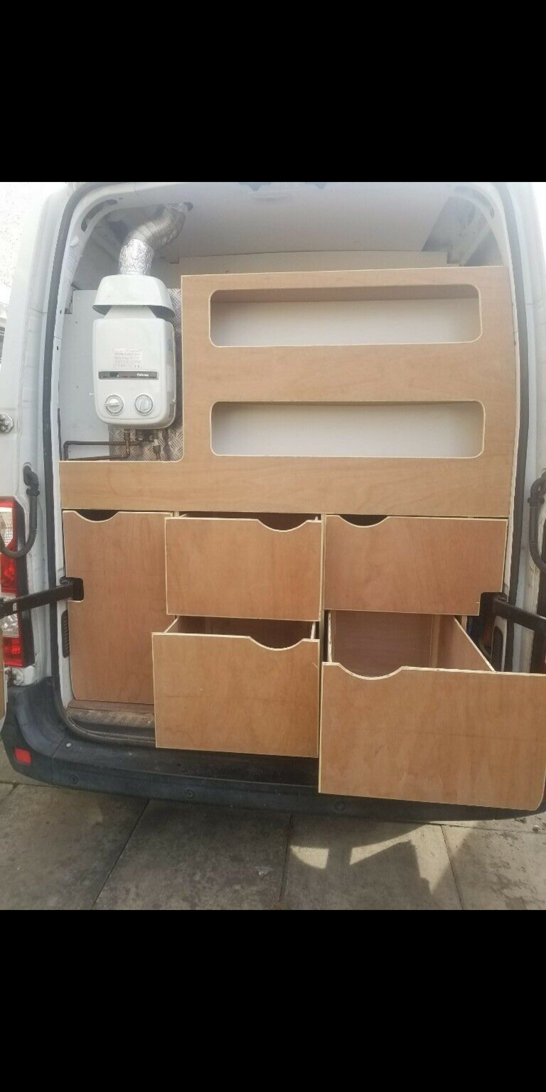

So I've just had my new to me panel van conversion Hab checked for the first time.
There are a few issues but the mail one is the water heater. It's a pilot light instant type but not made for a motorhome. What sort of water heater is best type without breaking the bank?
Is it one of the type that draw combustion air from in the van? Can you change so it opens to outside rather than into the van?

OK, I think I need to explain more.
I have 2 sinks and a shower. I currently only start the water boiler heater thing for a shower, for washing up I boil the kettle.
The boiler thing is in the back of the van completely separate from the living space.
So I need something to heat water for a shower. Propane powered would probably be the easiest.

What precisely has the hab inspection said about your heater? I guess its run off propane and has been converted from natural gas to propane? Phil
So I need something to heat water for a shower. Propane powered would probably be the easiest.View attachment 1811
Love your draws ;)
