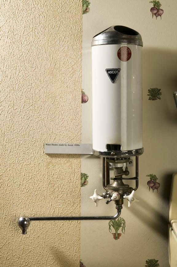

Various manufacturers make lpg versions on the same principle.
There are also lots of instantaneous gas water heaters out there that just use the surrounding air for combustion and vent combustion gases back into the room (no flue/flue less type)
Morco etc used to sell them for use in boats/caravans etc...
And lots of folks have fitted them without issues...
Though I personally wouldn't want anything that wasn't flued correctly... Especially in a small enclosed place.
