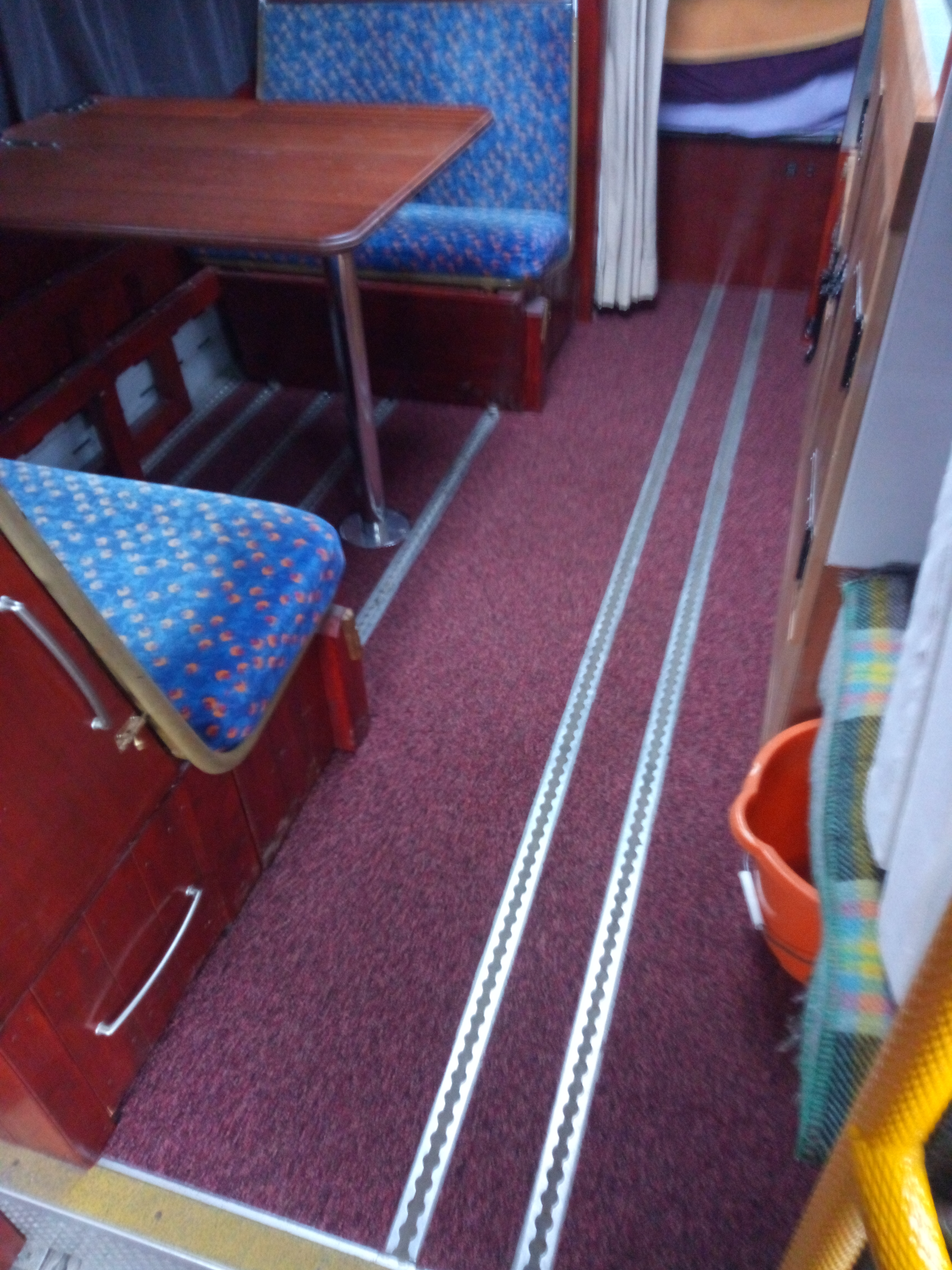

Greggbear67
Just done my bus with heavy duty floor tiles straight over the original bus floor. Went in between the unwin rails as they stood a little proud of the floor, so now its more or less level. Was going to then put a layer of carpet down & use the tiles as an insulation layer but I quite like the look & feel of the tiles now

We used the cut offs from our house carpets really pleased with the way it has turned out.

Just done my bus with heavy duty floor tiles straight over the original bus floor. Went in between the unwin rails as they stood a little proud of the floor, so now its more or less level. Was going to then put a layer of carpet down & use the tiles as an insulation layer but I quite like the look & feel of the tiles nowView attachment 2205
I like the colour and contrast there :)
what about cold and condensation from the rails? I have the same rails and have thin contract carpet over the floor (and rails) and feel the cold spots.
Greggbear67
Have to see how it goes with them showing I had planned to go over the lot with a layer of carpet to finish it off so I might go with that if the rails feel cold. I still have a lot of these tiles left yet so I could put another layer of them on top now...
I was going to get some of the rubber inserts unwin do for the rails (there is one pair of rails that I can use to drop a 3rd seat into for an extra passenger) but they are very pricey :(

Greggbear67
I looked at those too but was put off by the price. In the end we just filled the rails with clear silicone, it stops dirt getting into the rails & will pull out if I ever need to use the rails.
Clear Silicone? that's an interesting thought for the living area.
I still use the rails in the "garage" (under bed) with some of the unwin rings you can get to help secure loads and to keep the water bottles in place.
Greggbear67
Beauty of silicone is it will pull back out cleanly if I need to use the rails. Rails under the table etc just fill up with dust & grit etc if not covered, & as I don't carry a vac it was easier to just fill em up!...
Greggbear67
I find mine very cold when wandering around with naked feet.
Mine too but I don't tend to take my socks off very often. Probably gonna end up putting another layer of carpet or something over the lot next just to tidy it up as I don't actually use any of the rails. Thought about just putting a 2ft wide runner down the centre so I could take it outside to clean when needed,don't think the area under the table really needs anything else now.
