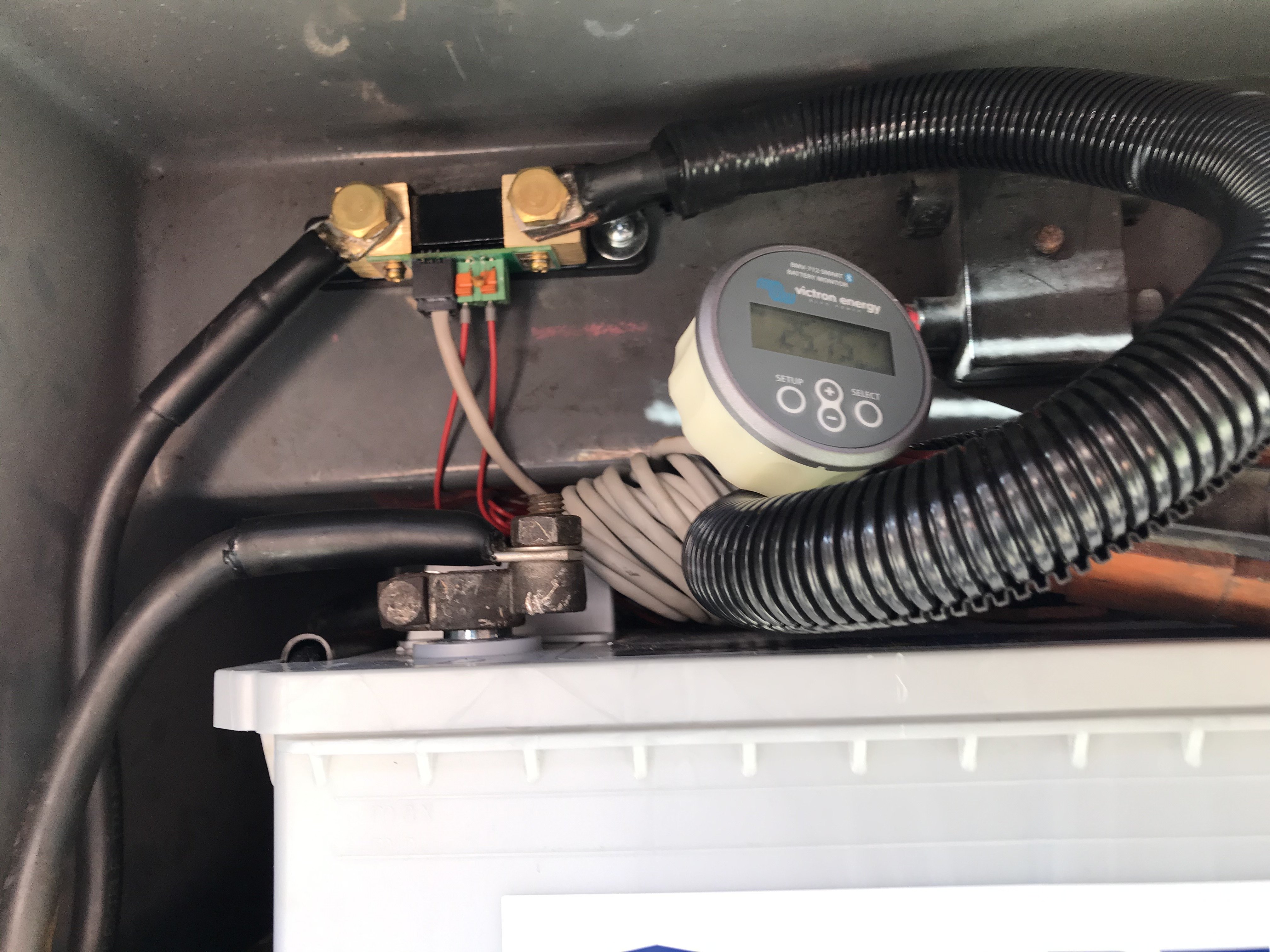

I can't remember the cable size, but it's the same as plaxton fitted. This is on the starter batteries and is 24 volts. I remember soldering the lugs was a pain. During the build these batteries have been used for all the 24 volt supplies, lights and heating etc. Thinking about it, Murky's BMV shunt is about a metre away from the battery, but all negative wires connect after the shunt.
