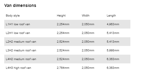

I think I'm right in saying that you would go for the H3 if you want to stand up easily in the back? I can't find a table for Sevel vans with internal dimensions, but I found one for Fords and it goes (internal dimensions)
H1 - 4'6"
H2 - 5'8"
H3 - 6'1"
I must go and look at some...
Damn, just found the Peugeot dimensions on that link scottybeee gave, and they are bigger
H1 - 5'5"
H2 - 6'4"
H3 - 7'1"
Which explains why I can stand up in my Ducato-based jobbie

As for load space dimensions the H1, H2, H3 and L2, L3 & L4 I believe only give you basic interpretations or feel for the sizes of the load bays.
I know that when considering the H2 FWD Renault Master and the much rarer RWD Renault Master then the FWD version has far more headroom.
With regards to the L2, L3 & L4, from what I can recall from many years ago in my commercial days L2, L3 etc. referred to the numbers of Euro pallets that could be fitted in along the length of a van, but there again I might be wrong!

The H and L definitions vary tremendously between makes (as you have seen above :) ) A MWB (often referred to as L2) Sprinter is longer than a LWB/L3 Sevel Van.
Also, it is mostly relevant to the Fords, but I think applies to certain Sevels, Masters/Movanos/Nissans and latest Crafters (so just about every make I guess!) ... If you move from FWD to RWD or 4WD, the exterior height doesn't change, but the floorpan is raised up to accomodate the running gear. This means for example a RWD H3 Transit will have less headroom than a FWD H3 Transit.
