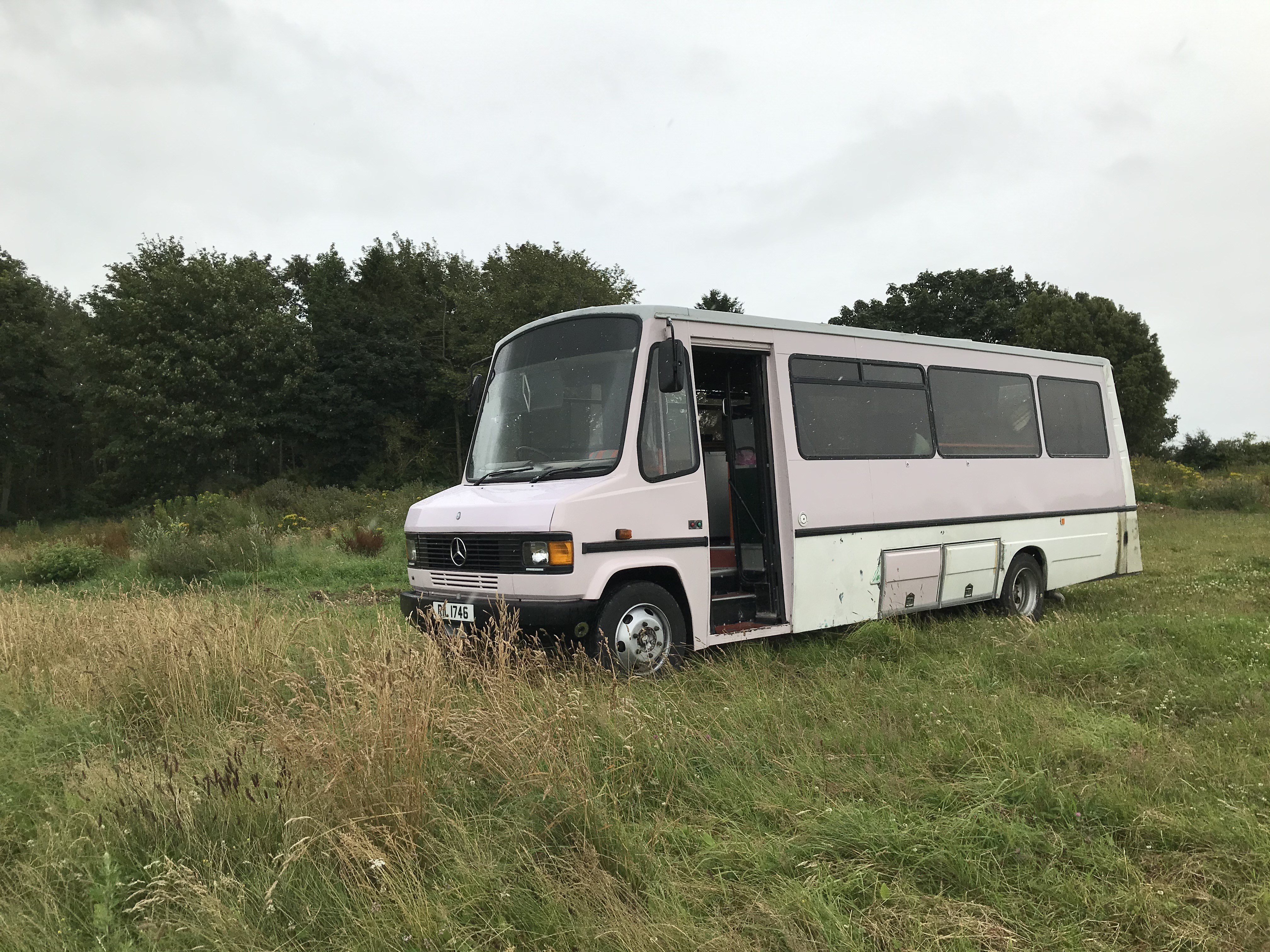

This is our odd tart.

Looks a little dated as compared with your 'A Class' Vario. I suppose that's one advantage
found with my PVC, it still looks much like the last of the Vario PVCs. Only the
front grille and tweaked up front wings/lights differentiate them.
I have a pic of a concept MB Type 2 1995 van, looks like Plaxton plagiarised the design
If I can find I'll post it in the appropriate thread..
