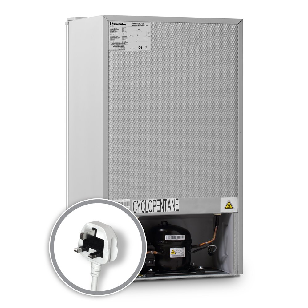

this is an image of the rear from the supplier...
Duckato
IIRC I looked the compressor up on the manufacturers web site a while ago but could not find the exact same model I have since forgotten what it is so I will go and look it up again later I am pretty sure there is a startup cap on the side
