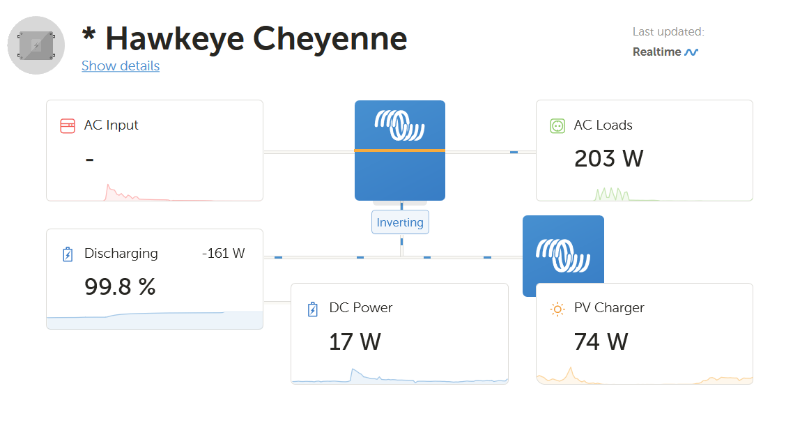

The fridge has still not come on at all! I am going to have to go out and check the internal temp and that it is still set for AC (probably lower the temp setting as well just to make it come on!)
still cold (ish. think setting a little high). turned it off and on and still selected AC automatically as it should. lowered temp a click or so and started up :)
Since adjusting the temp setting a bit low it hasn't gone off! I think it was a little too high before as the freezer was only just below freezing. might be quite senstive to the settings? will need to keep an eye on this. I'll be putting a temp sensor inside the fridge and connecting that to the Cerbo once I work out the best routing for it so will be able to easily see what is going on.
Also lowered the SOC cutoff down to 40% (which would mean approx 12 hours of fridge running time with a typical on/off pattern - the actual time will depend on duty cycle) as I am interested just how long it will run in what seems to be a initial cooldown process, even though must have been very close to start with?
(just looked at VRM and just this minute the Inverter switched to Low Power)
