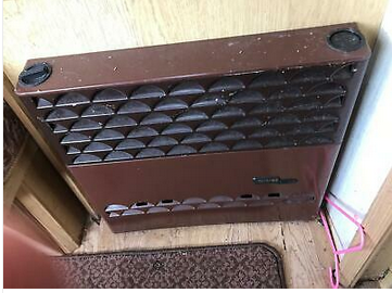

Get a old caravan gas indirect heater,the exhaust is under the van so no nasty burnt gas to kill you,can be bought from £25 up and use no lecy.View attachment 1424
The down side of those heaters is that the fumes can find their way into the habitation areas, they also seem to use a lot of gas for the heat given out. Not experienced one, but I'm told the ones with a built in fan are better at heating.
Your correct in saying the blow fan ones are more efficient Squirrel but that means 12volt is necessary to drive the fan and most that have the fan also have 230volt heaters incorporated as well, the fume smell I feel is more to do with dust that settles on and in the heater as the gas burner is in or should be in, a totally seperate compartment sealed from the hab area, the other slight disadvantage is the chimney to work well has to go directly up and through the roof. Phil.

The ones I've experienced Phil, had the flue under the vehicle.
Mark
Mark
Hmmm Mark I can not categorically say for sure but the only ones I've come across the inlet (Air intake) comes from under the van goes through the burner and then continues up the chimney, for an exhaust to operate in that it exhausts down through the floor would require a strong exhaust fan to drag combustible air in and push exhaust gas out, in the same manner of a domestic boiler flu works and indeed the flues of Truma 4/6 boiler/Heater. Phil 🤔
This is a posh one with a thermostat. The air intake rotates away from the exhaust.
