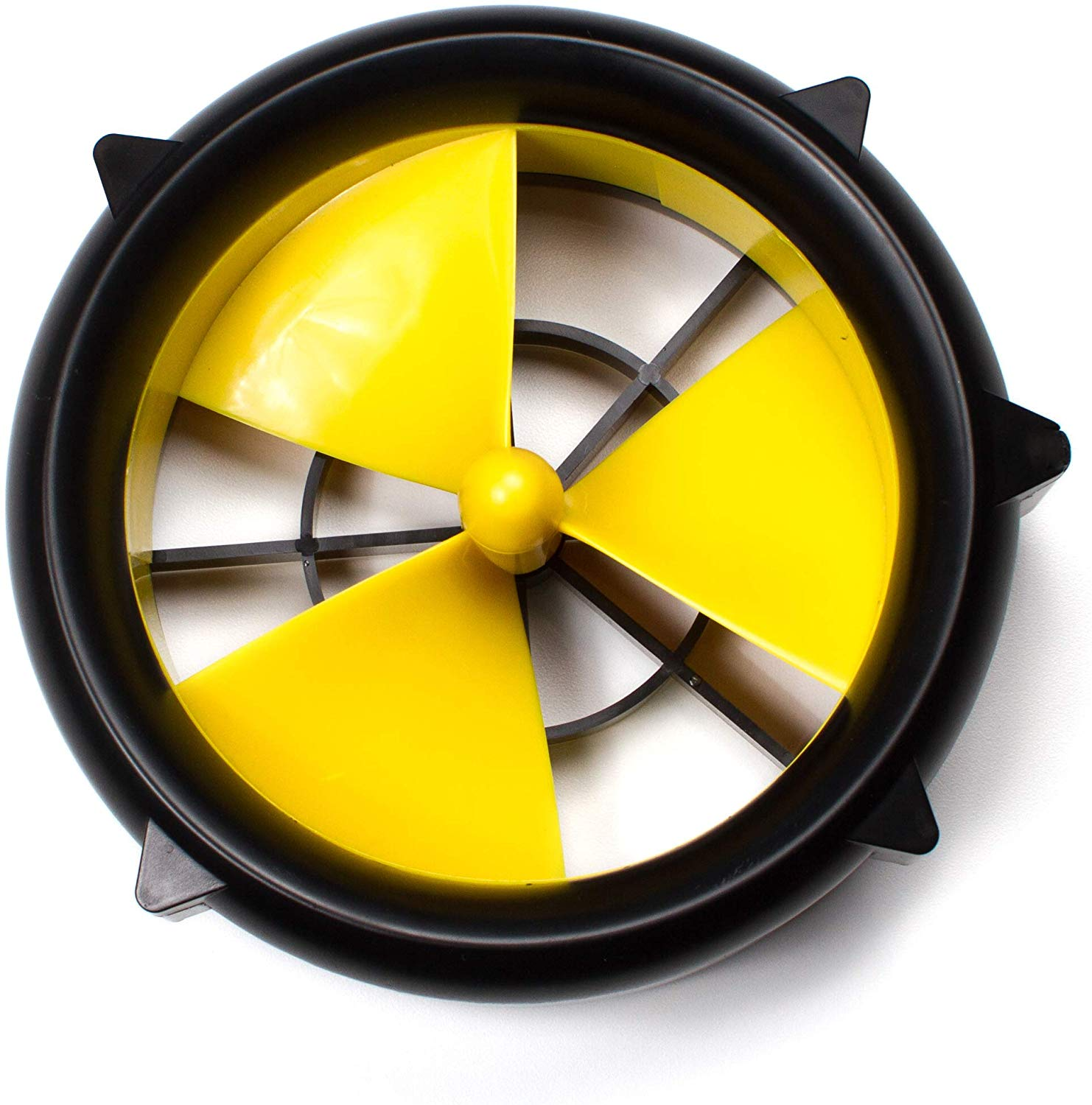

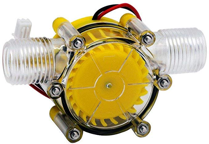

blooming windy today and stuff is getting blown around the garden.
Checked my weather station and wind speed has peaked at 30MPH. Now considering most small wind turbines seem to require a wind speedof around 25MPH to achieve full power, I don't think I would want to be parked up in a place where I can get that!
I was kinda considering getting a small wind turbine to play around with, but don't think I am going to bother considering the above.
Now what COULD be an interesting project ... How about Water Turbines?
or maybe .....
park near a river and drop in a water turbine/paddle and get some power while there 24/7 :D
  • Like
Reactions: RAW
RAW
Full Member
View attachment 1928 or maybe ..... View attachment 1929
