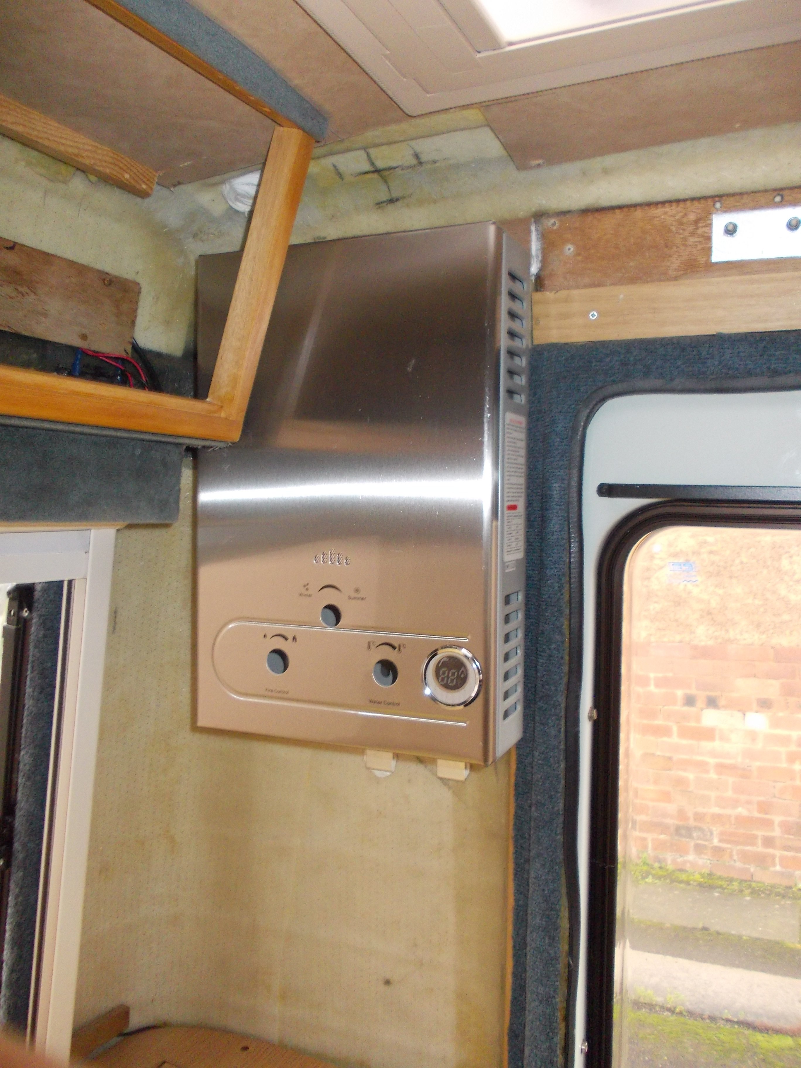

Ok, I fitted one many years ago on my library conversion but got told recently there not permitted by law anymore. I've done a bit of research but nothing is coming up. Who has one on here..??? (Shhhhhh.....!!!! I'm fitting one regardless....)

Your quite correct sir, indeed it was aimed at domestic type combi boilers. The one I fitted was a simple function 'demand & supply' with jets swopped for propane. I'm going for a really good shower setup and also hot water feed to washing machine ( all savings on AC inverter loadings being applied wherever).

just to reiterate, unless the law's changed , there are no rules for people fitting gas appliances to their own vehicles . which means of course , that common sense must be involved
I've got one. Never got round to finishing it........need to drill a hole in the roof.
