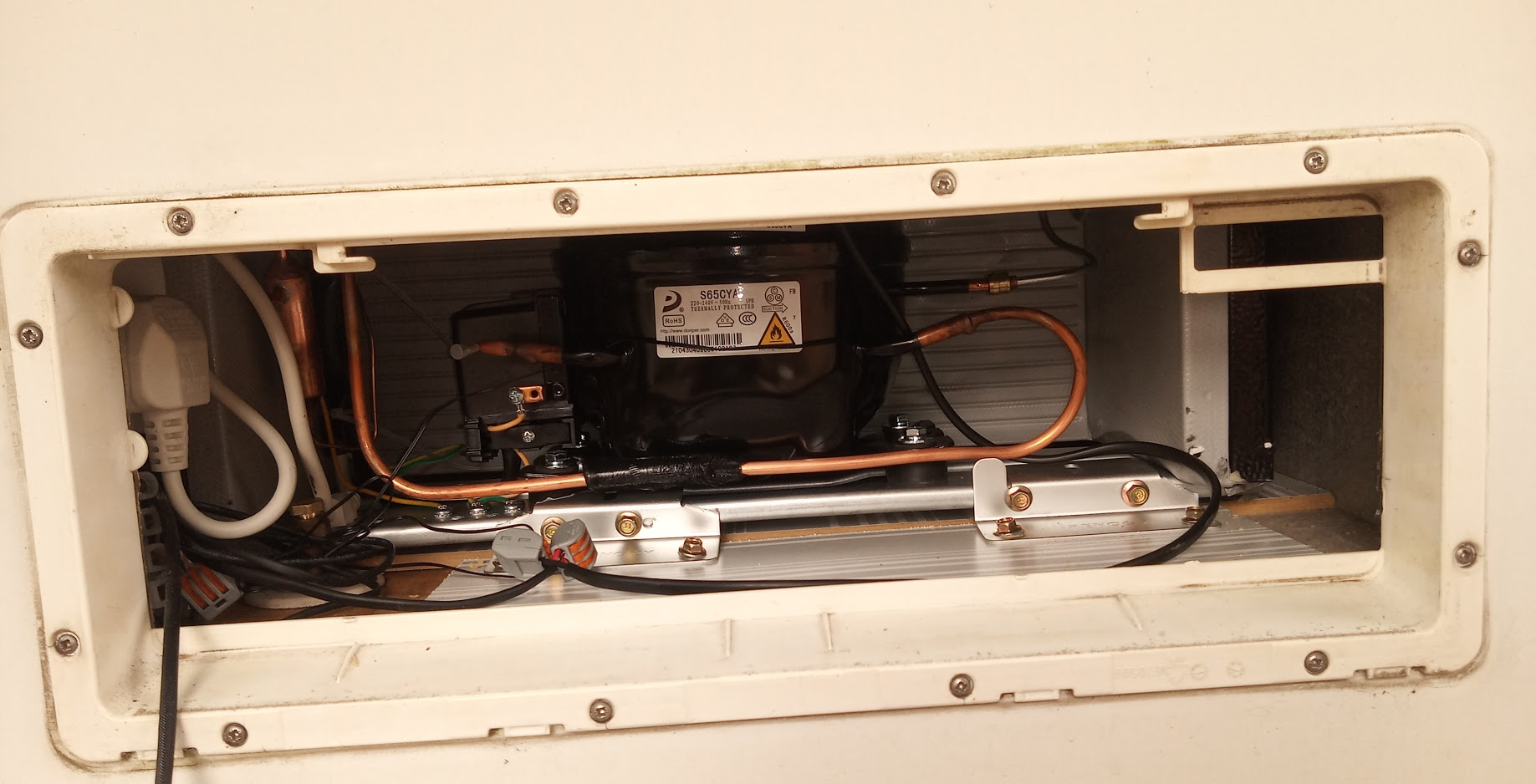

This is my set up you can clearly see in the second shot the plastic bungs which hide the screws

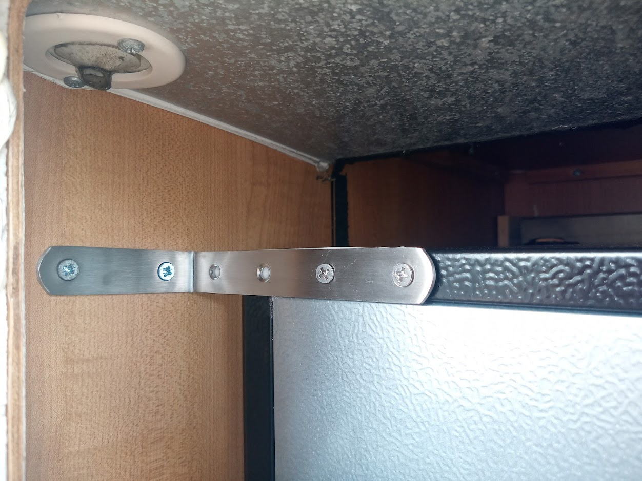

On mine, at the bottom I used a pair of Renogy Z Brackets, which are designed for solar panel fixing, with some slight adjustments.
And at the top, a pair of heavy duty L Brackets secured into the Fridge top with VHB and short self-tappers

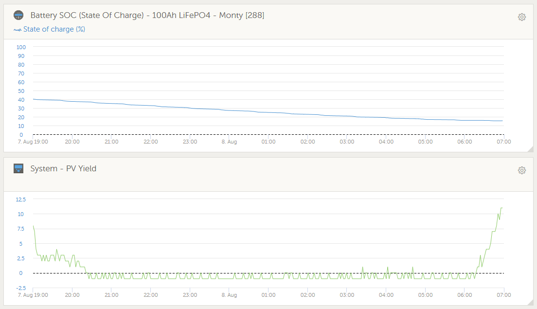

To give you an idea of power use, this is the SOC chart for my van for the last 12 hours where solar didn't figure
SOC went from 40% to 15% - a use of about 25Ah out of this 100Ah battery

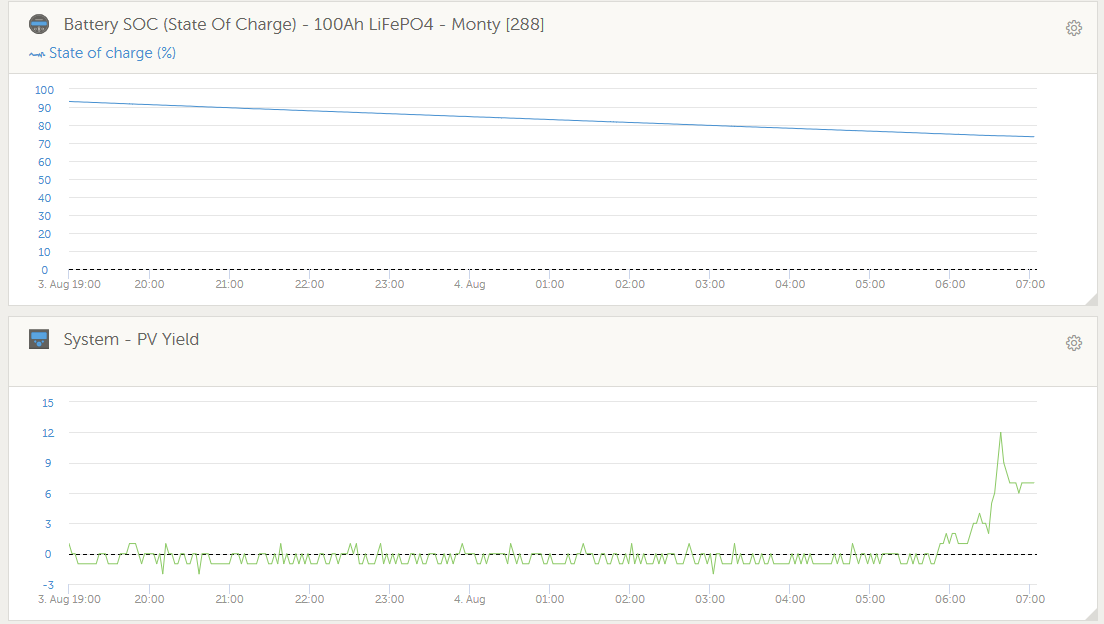

But I have a fair bit of general power draw .... this is the same time range a few days earlier when the fridge was switched off ...
Start at 93% and end at 74% - a use of 19Ah
So on those numbers, My A+ rated Fridge/Freezer is using 12Ah ((25Ah - 19Ah)*2 for 24 hours) per day INCLUDING the inverter overhead. You can see the solar is doing nothing of note in the 12 hours of graphing shown.
