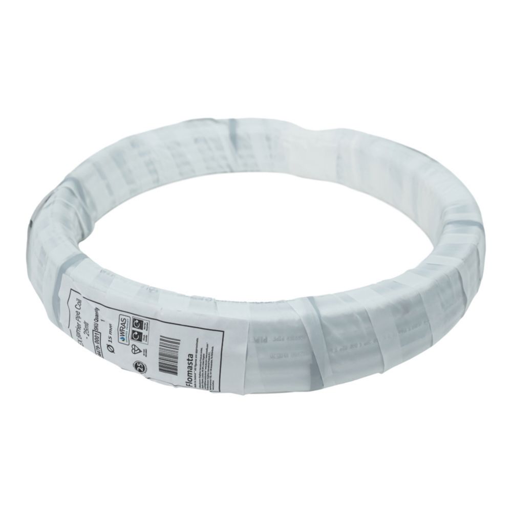

On another note where is the best place to buy water pipe ?
I used something like this on the Murky build due to it's frost tolerance.
