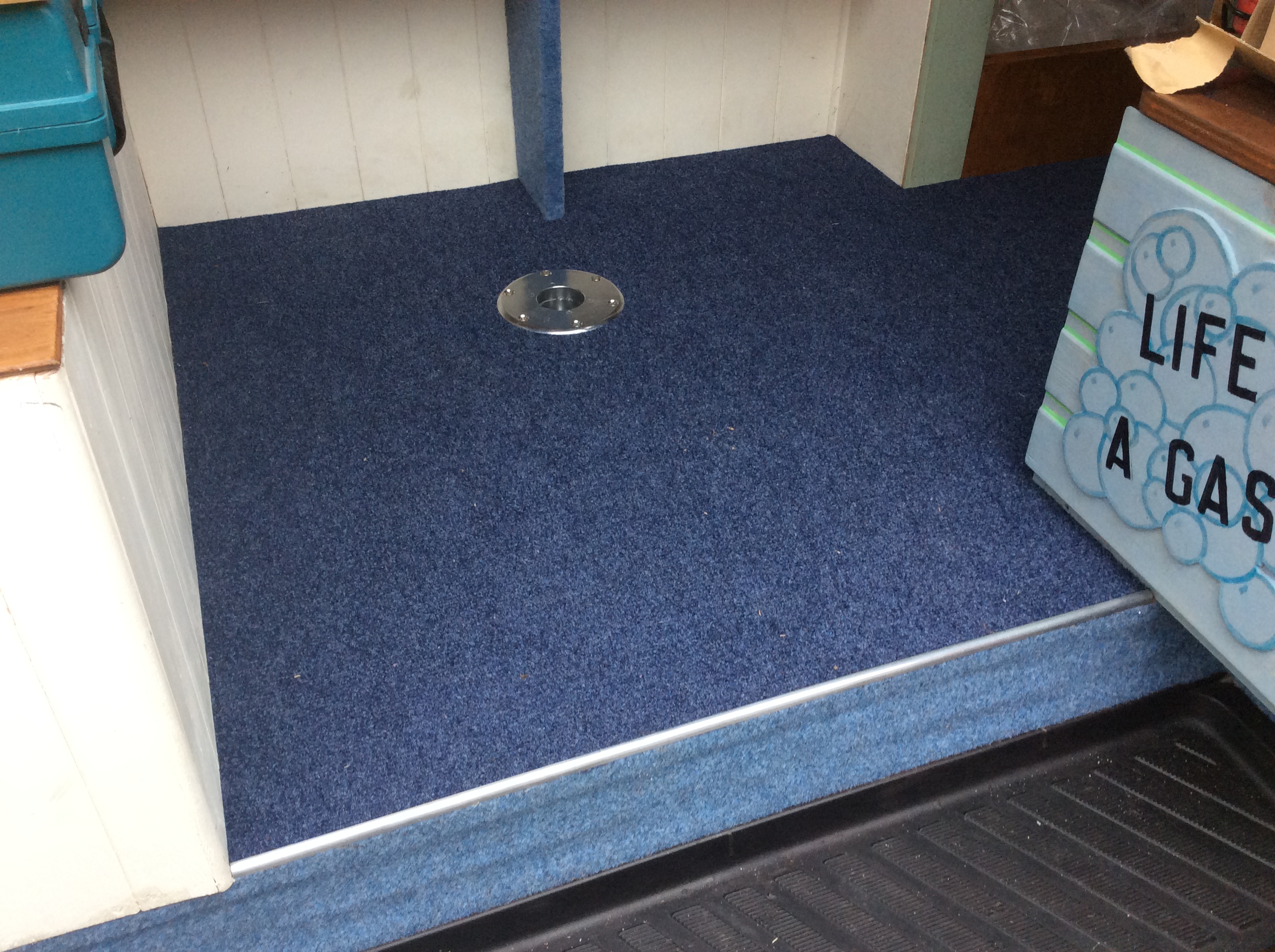

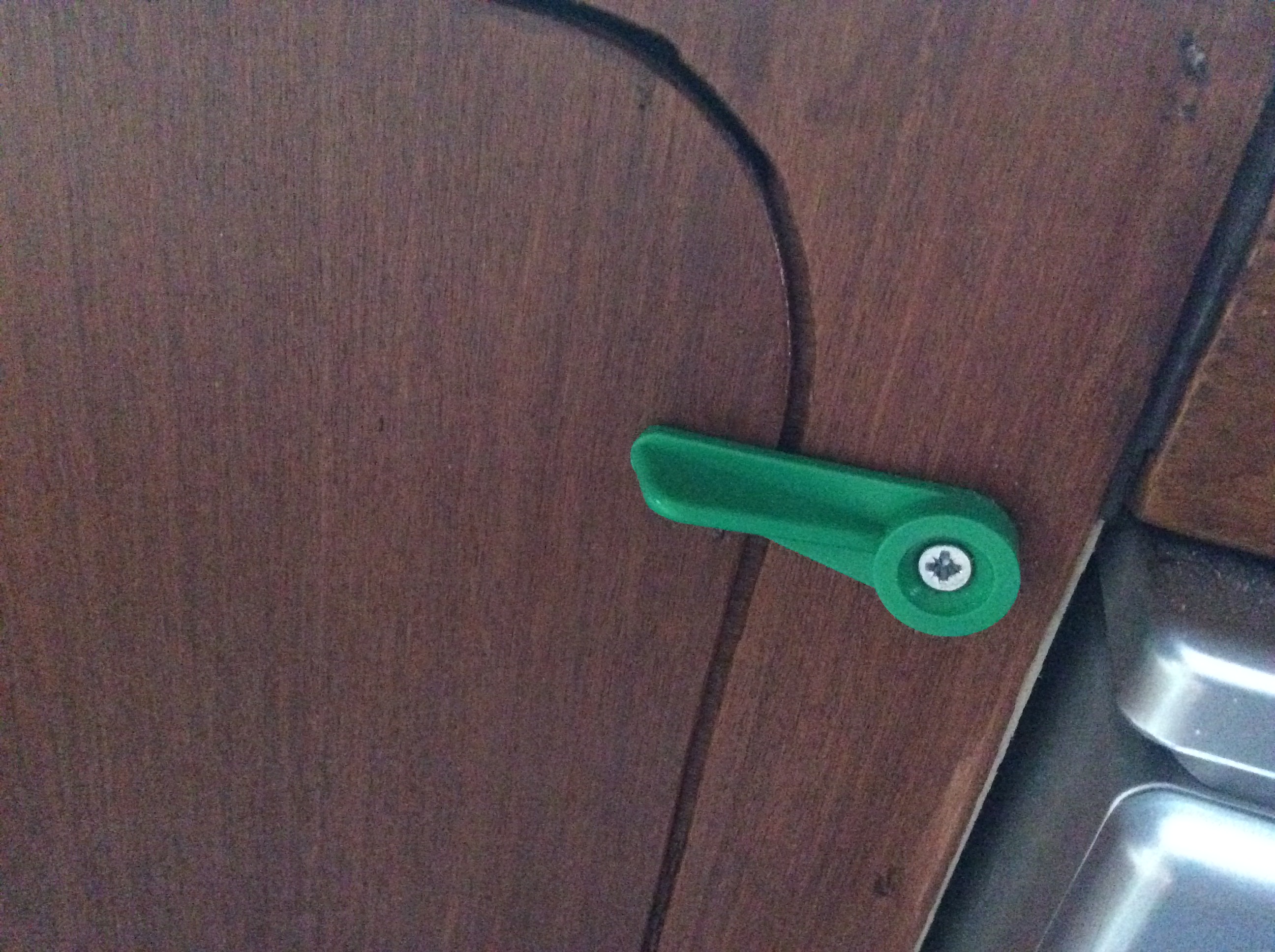

Determined to get the van finished, a wee break in the weather and I got the carpet in and the table leg socket fitted. Also fitted some turnbuckles, a pack of twenty for a fiver off eBay. They’re marketed as birdcage door catches!
