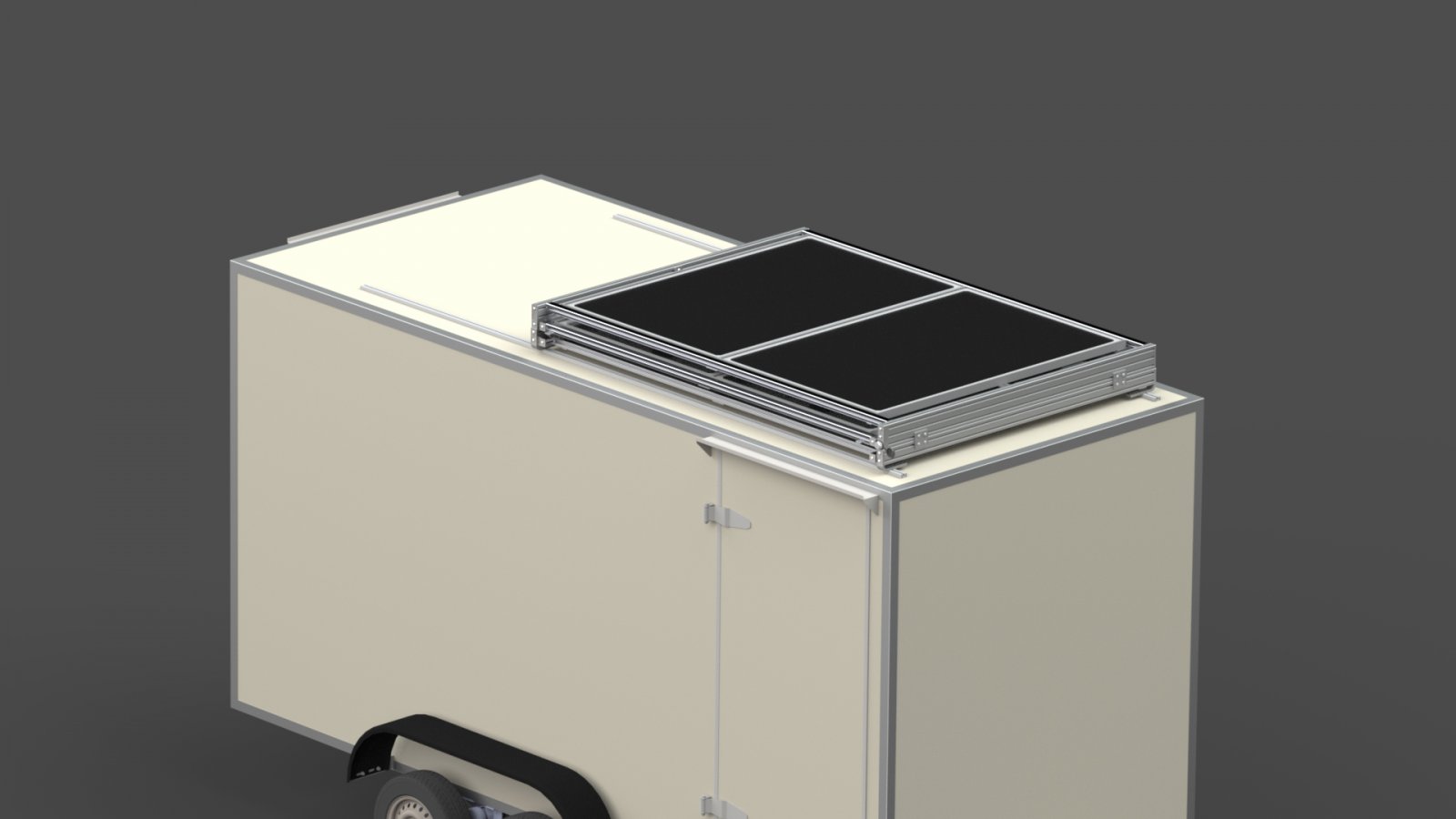

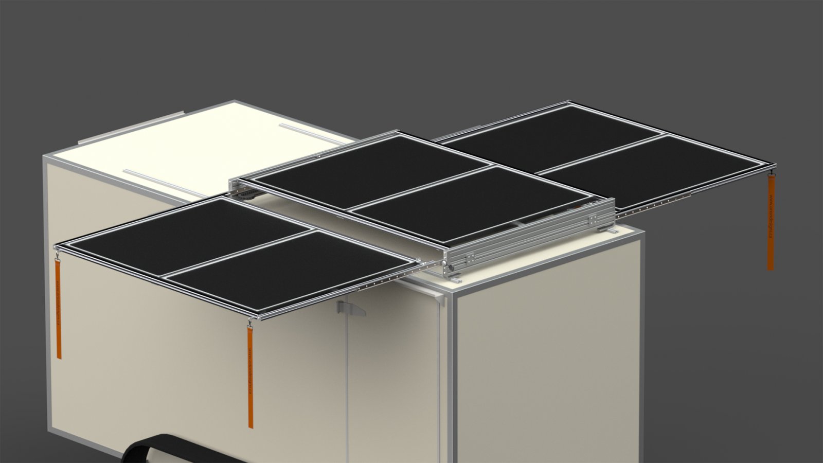

I was actually going to do this (and have even got a 12V Actuator bought for the purpose) but decided not bother. But I reckon it is a great way to add more panels.As far as I am aware nobody seems to have done this yet on a van. These slide outs are really getting some lateral (no pun intended) thinking going, love some of the things people are doing with them. Is this Dave’s next project?
View attachment 2850View attachment 2851
That kind of thing could be brilliant on a MotorhomeOne of these would be very 'Bond'
In summer/strong continuous sunshine maybe Trev but definitely not all year round in the U.K. I can leave it today but will need to run the genny tomorrow and that’s 300W solar with 200ah Lifepo4200w and 200ah battery bank should be plenty for most vans unless you are planing a mars orbit.
