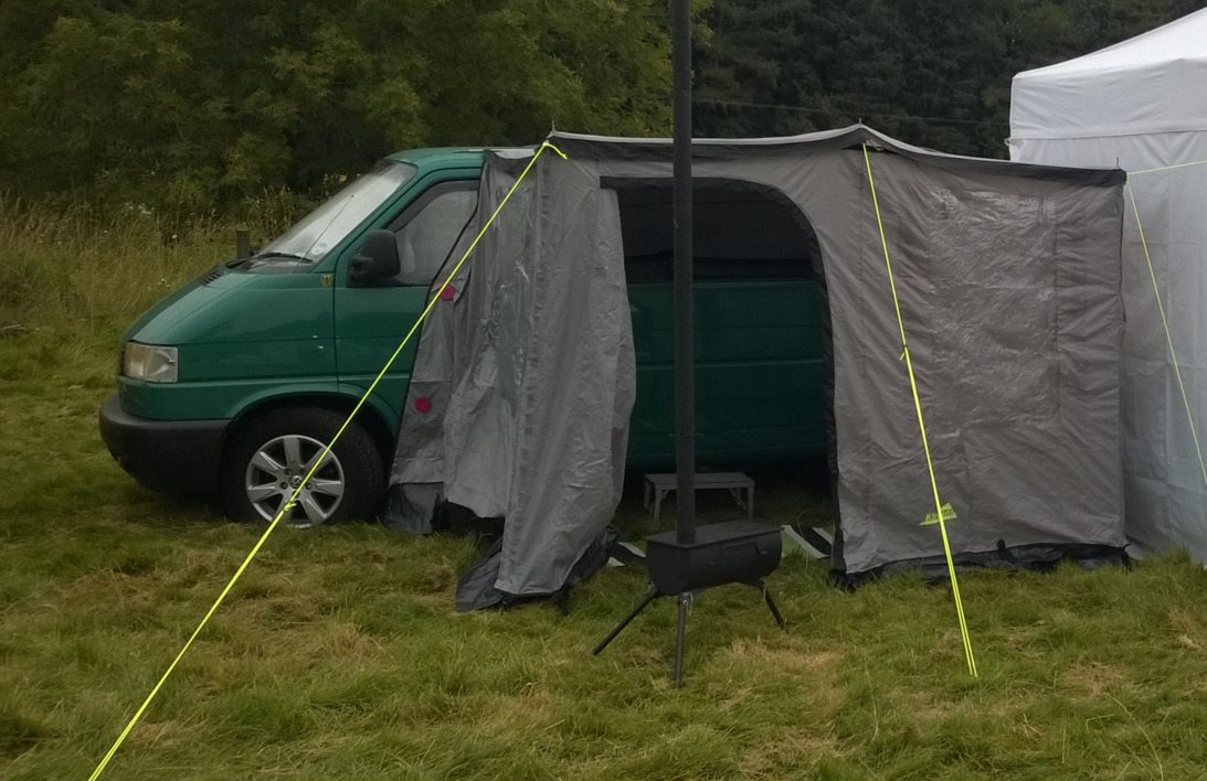

FWIW, I carry a wood-burning stove in my van, it just isn't fitted inside :)
I have a 'Frontier Stove' ( https://anevaystoves.com/products/the-frontier-stove)
With my 'Overland' Camperbus
IMG_20180825_181926 by David, on Flickr
And its first outing I think?
Tempted to get the Water Boiler that sits on the top and attaches to the chimney but it's just a very pricey kettle really. I do use it for cooking al fresco.
IMG_20180825_182040 by David, on Flickr
