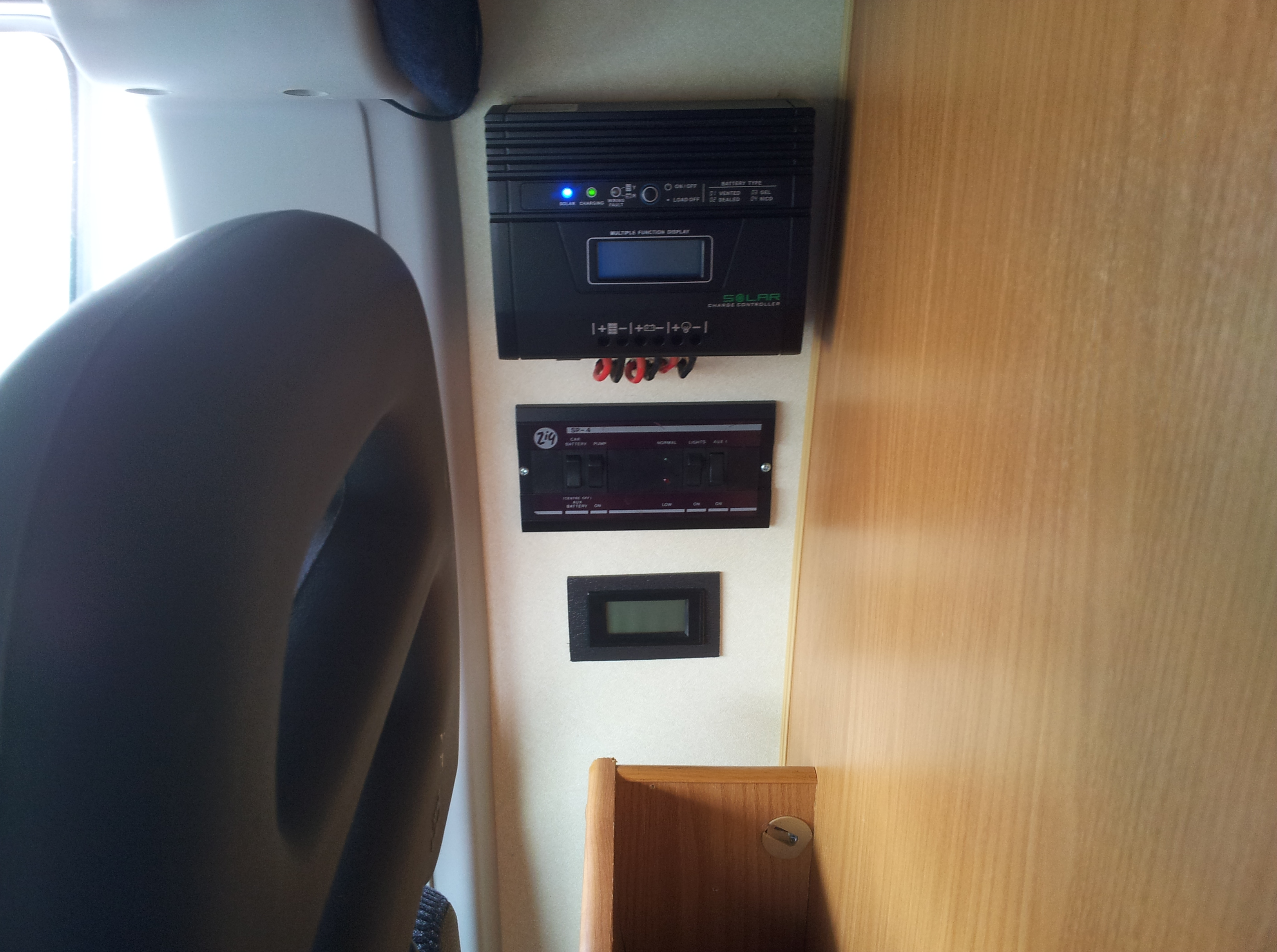

Tidied up the Transit Electrics.
Only doing minimal things myself to help the owner have a useable setup while they decide what and how they want the electrics to be.
Pulled gently on the little 0V/ground lead on the VSR and it just came out the hole from the cab, so was either never connected as I thought or connected badly. I didn't bother testing any of the existing connection setup as even if it had worked it was still not fit for purpose.
Moved the VSR to a little electrics 'sled' I prepped up, along with the existing 6-way fuseblock (which had not be connected at all) and wired up the Starter battery to one side and a temporary Leisure battery to the other. Replaced all existing battery wiring (which was mostly 1.5mm2 twin mains cable!) with decent 16mm2 cable, adding in fuse protection (which was totally missing previously) and a 2-way isolation switch which will let them remove power to the hab electrics (Pos OFF) plus allow them to select either Leisure battery supply (Pos 1); Starter battery supply (Pos 2); or join them together (Pos 1+2) (which could be handy to help the Starter battery bank maybe at some time?). Normal operation will be switch on Position 1 (down pointing to the Leisure battery
And finally moved two twin-core (mains
) cable sets over to the fusebox for proper connections with fuse protection (the other fuses are just there so they don't get lost!). The Red/Green/Brown wires coming out the Switch are for a "Battery Watch" kit - Voltmeter with a 3-way switch so they can check the voltage of the Starter and Leisure batteries with the one display.
Probably add some cable tidies or P-Clips next month. Right now the Leisure battery is just a temporary one for them (actually the old one taken from Campervanannies Adria - thanks Annie
) until the new ones are available in January from Alpha Batteries, so they can use the Camper to go away for a few nights over the holidays.
So once new batteries are in, battery wiring will be finalised and secured.
