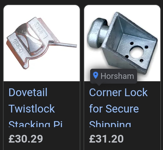

Hi ISO containers as they are called are fastened together @corners & midpoint using a lever or a turn buckle clamp see picture
