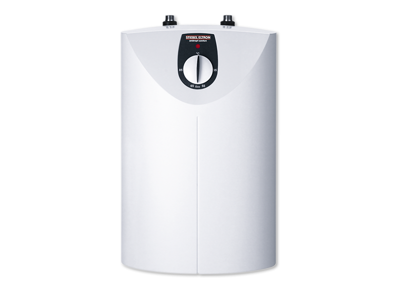

I've been sizing battery/solar etc for our possible all-electric van and I've been thinking about water heating. It's the biggest consumer of power. We need a 10l heater if we have showers and one heat cycle will do both of us, plus probably the breakfast washing up. But we might also need hot water, possibly, for washing up at some other point in the day. Heating 10l again seems wasteful when we only need a couple of litres.
I think there are 3 possible solutions
1. Get a small undersink heater with less capacity. Something like this:
The 2kw one has a heat cycle of about 8 minutes so would be very usable.
2. Get a relatively low power instant water heater, like this.
I think the snag with the instant heater idea is flow rate. If you have a battery-friendly wattage the flow rate is very low: the one above flows at 1.5 litres a minute, but of course uses very little power over all if your need is just a couple of litres for greasy dishes.

Well, my thoughts would be forget #2 - that is just too big a power-requirement and is pushing it on a campsite hookup.
#1 - that is the kind of unit I run. I have a 10L Ariston 2kW unit. I would have preferred a lower power (~1000W) one but they don't seem to be available as off the shelf heaters (which is what I personally wanted as the most cost-effective option)

....I would have preferred a lower power (~1000W) one but they don't seem to be available ....
Crazy idea? Two of these:
Two 5litre/1kw heaters 'in series', so to speak. You could turn them both on when you really do want 10l, or just have one on when 5l will do and/or you want to conserve battery.

It says for non-pressurised taps. Does that mean gravity feed only or something, rather than our pumped systems?
Good spot. I'm nobody's expert on plumbing, but I think 'low pressure' is a gravity fed type system where the pressure is less than 0.1 or 0.2 bar, whereas 20psi from a Shurflo is about about 1.4 bar. So I guess it would only work with the pump on demand type systems, with the expensive taps!
However, I'm open to correction. As I say, what I know about plumbing would fit on the back of a wet postage stamp.
PS - I think Wildebus uses an Ariston heater and that's the same deal...I presume his hasn't exploded yet? Baffled.

So your Ariston heater, Wildebus, says its for low
Right, after a bit of research, I think I’ve found that “vented” heaters, like the Stiebel, need “vented taps”. This is because when the water expands on heating it makes its way out of the tap (it drips....). So I suppose the tap must allow water to pass even when turned off if it’s over a certain pressure. “Unvented” heaters, like the Ariston, can use normal taps because you are supposed to fit an expansion vessel with them which copes with exapansion.
As to inlet pressure, my reading is that unvented heaters work between 1 and 3 bar (Shurflo is 2 bar) and vented one’s work at water main pressure, which is about 1 bar, but a couple of heaters I looked at talked about working pressures of 0 or 0.15bar. So.... “unvented” it is, in our world, if you use the Shurflo type pressurised system.

You sure mains water pressure is 1 bar? I thought 1 bar was "normal" atmosphere (e.g. 1000 mBar).
The internet can be dangerous but I found something like this in a couple of places
“Water suppliers’ statutory service standard level of mains water pressure is 10 metres/head (or one bar). This means there is enough force/pressure to push the water to a height of 10m.
This is measured at the point where the water leaves the water suppliers pipework and enters yours (usually the outside stop valve or property boundary).”
And I don’t think the expansion vessel is to do with inlet pressure. It’s to do with the volume of water expanding as it heats. I don’t suppose it’d be a problem with a 10l tank, but a bigger one might be more interesting!
Full Member
You are right about the expansion vessel not having anything to do with inlet pressure, and also it taking the water as it expands - but if you didn't have the vessel fitted, the effect would be the pressure in the heater would increase - and if you had a bigger water inlet pressure as well, that means more pressure still. (This is why the Ariston Heaters, and no doubt all the similar ones, come with a Pressure Relief Valve (another PRV ackronym ;) ) which will dump at (from memory) 6 bar. I fitted this as well, not as I think the pressure will get close to that, but it also works as a handy manual drain valve :D
In terms of Heater size and Expansion Vessel size, you would generally match them (not like for like, but as the unvented capacity increases you may want a bigger vessel). The one I got is more than big enough and I could have gone a lot smaller but it has the extra benefit mentioned and they don't tend to get cheaper as they get much smaller anyway.
I would not want to live in a house which was served by a 1 bar mains either. I'd have to run around the shower head trying to catch the drips to get wet :)
In fact this reminded me ... my gf (later ex-wife) had a flat in North London and if she didn't get her shower in before 6AM, that was it until after 9AM as the pressure was just too low to get the combi to kick in. No doubt that was delivering to the Water Companies minimum standard still.
