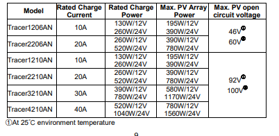

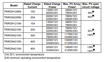

Here's a couple of the max input watts for 2 models of the EPEVER for interest sake.
TRIRON
TRACER - Probably the one the OP has
I don't think Victron controllers can handle over current. Anyone else know?
But as Wildebus pointed out, look at the manual as they all differ, as the two different models above highlight!
TRIRON
As posted, the victrons can handle "excess" power as long as the input Volts and Currents are not exceeded
