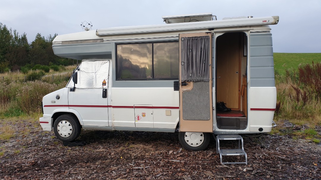

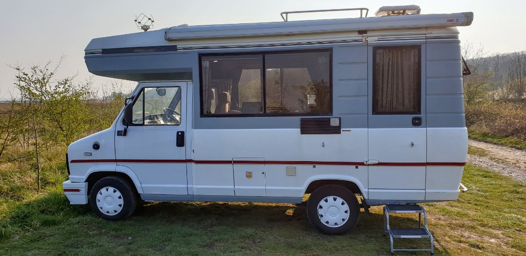

A ha - Different Coach now, how long's that one ? Or is it the same one in different colours, notice picture has a time stamp of 19/02/2009 !!
This is "Betty" the plaxton Cheetah. The one with bonded windows. This about 8.5 metres long and a bit wider and taller. I don't have any current pictures that show the whole of the outside, the paint work is more subtle now. The one I'd shown earlier has better designed widows. All the hard work has been done on that, just some finishing to the bodywork and then painting.
