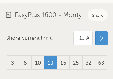

With Multiplus, you have a feature called "Power Assist". You choose a maximum AC input current to match the EHU supply and the Multiplus will not draw more than that from the supply.
My multiplus has a 16A input maximum, but I plug into a 13A socket, so I set the limit to 13A.
If your AC load in the van is greater than that input supply, it makes up the difference upto the capacity of the Inverter.
Example: you are on an 8 Amp EHU Supply - so can pull 8 x 240V = 2000W (rounding numbers as easier).
You want to run a 1000W Hob, a 2000W Room Heater and an 800W Kettle? 3800W total load. 2000W will come from EHU, the remaining 1800 will come from the Inverter.
Note: In the above maths, I am ignoring any limitations of your battery bank and assuming the batteries can supply the inverter without problems. You need a battery bank that can cope of course.
I am also simplifying how Power Assist works out what the EHU and Inverter will each provide. it is a bit more complex.
Can this work the other way around like take 50amps battery 30amps from 240v ??
Mines 120 amp @ 16 =240 charger . so at 13amps = 240 whats the max charge to battery in amps.
8 and or 13max charge capacity will 8 amp ehu be 60amps charge ....?
Can the inervertor not charge whilel output is inuse???
Will only cook with 1 ring so battery has high use but dont want to kill it

What goes to the charger is whatever is not being used by the loads when on EHU.
Your mixing up DC and AC a bit. for the UK, a 12V DC Amp is 20 x a 240V AC Amp for the same power. i.e. If you are drawing 20Amps on 12V DC, that is just 1A on 240V AC.
Better to think in Watts sometimes as Watts are Watts whatever the Voltage.
The charger is 120A @12V = 6A @ 240V = 1500W (rounding the numbers)
the 16Amp max is input mains, so 240V. 16A at 240V = 4000W (rounding again)
the Charger will use spare capacity to charge the battery. if you have a 16A EHU input (4000W), and you are running a 2000W Heater and a 1000W Water Heater say, that is 3000W you are pulling from the EHU. You have a 4000W supply, so that gives you 1000W free to send to the charger. 1000W at 12V is around 80A. So the charger will run at 80A rather than the maximum 120A.
(these numbers are rounded for simplicity).
