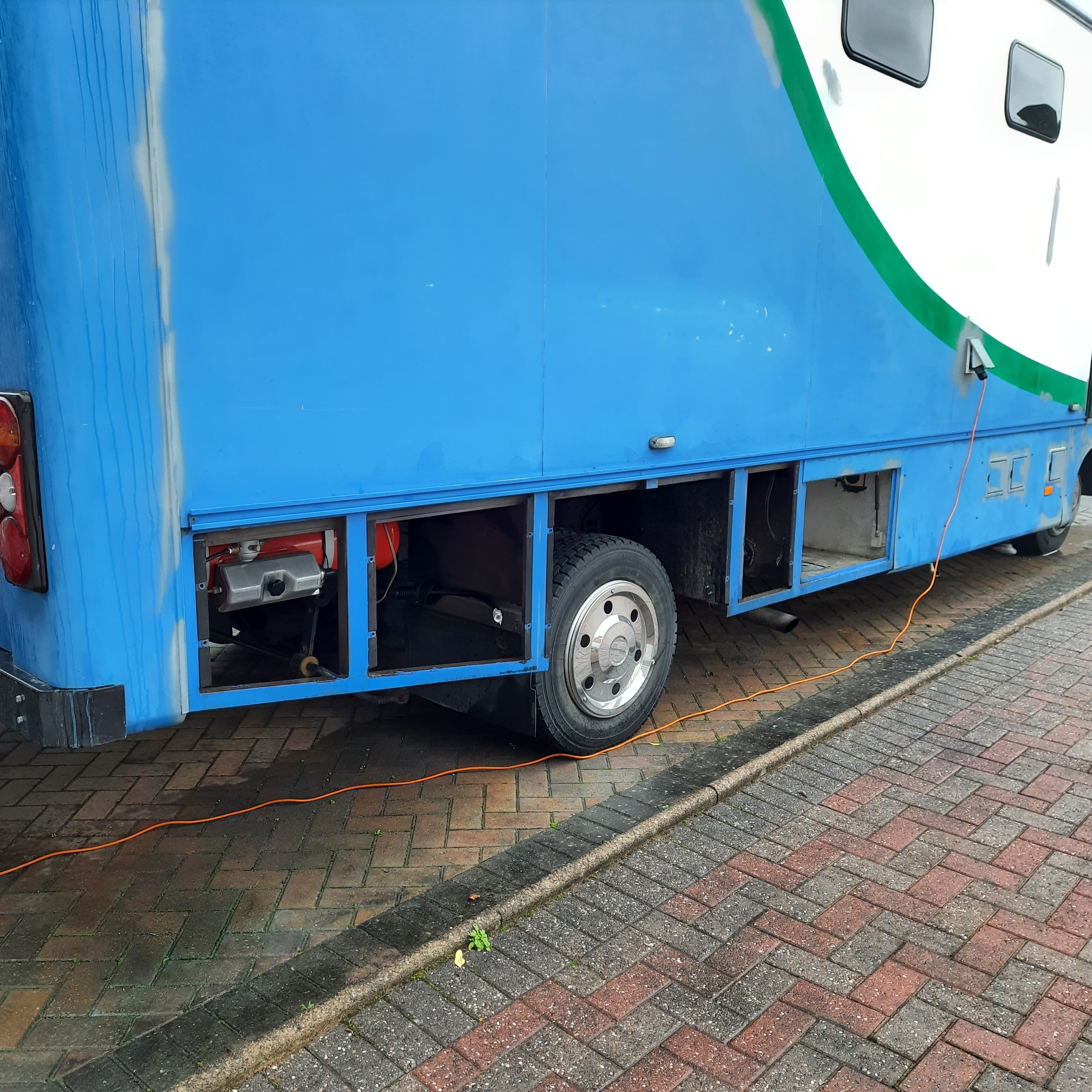

Bouydog

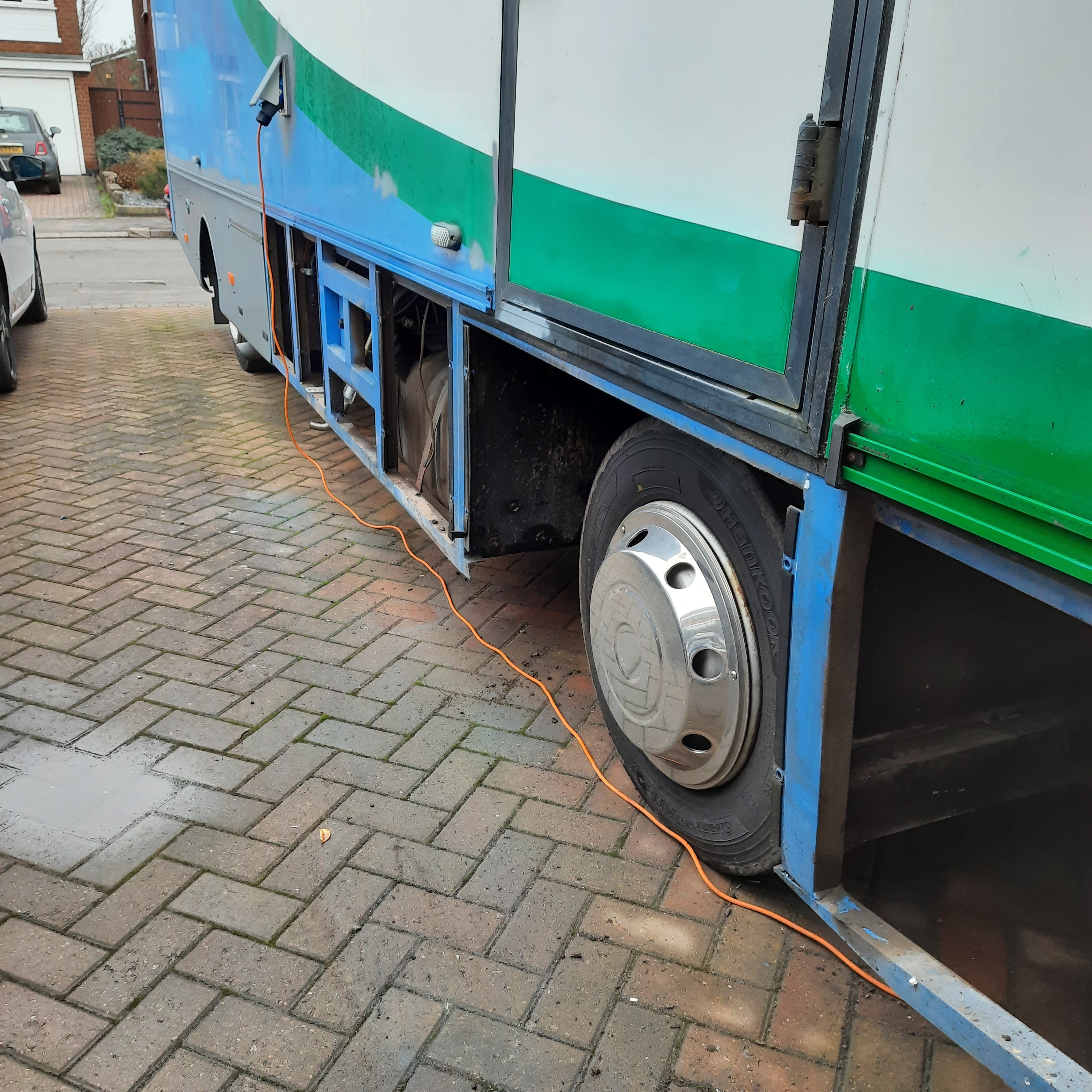

I decided to remove every panel that I could do final prep and paint them in the garage where I could control the temperature.

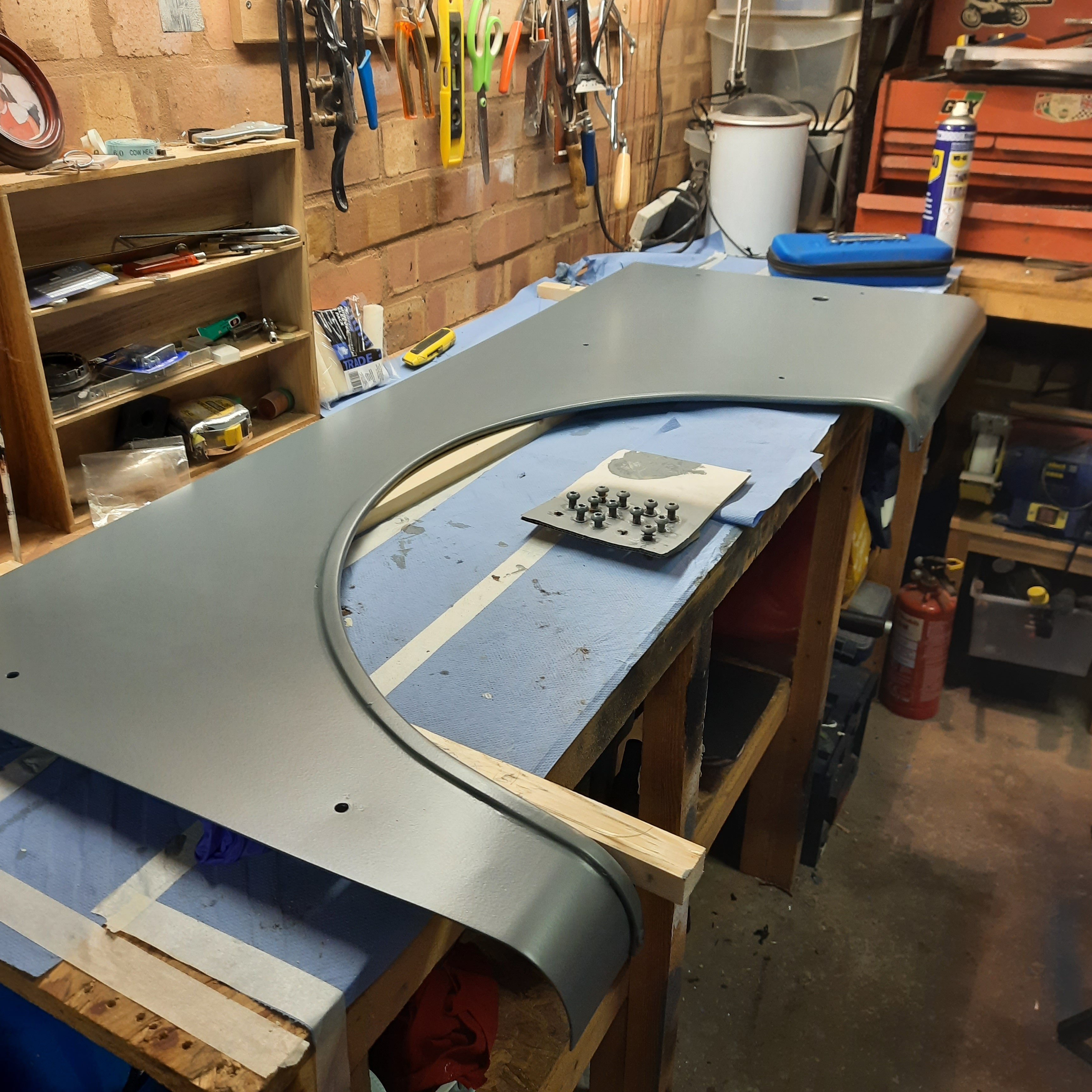

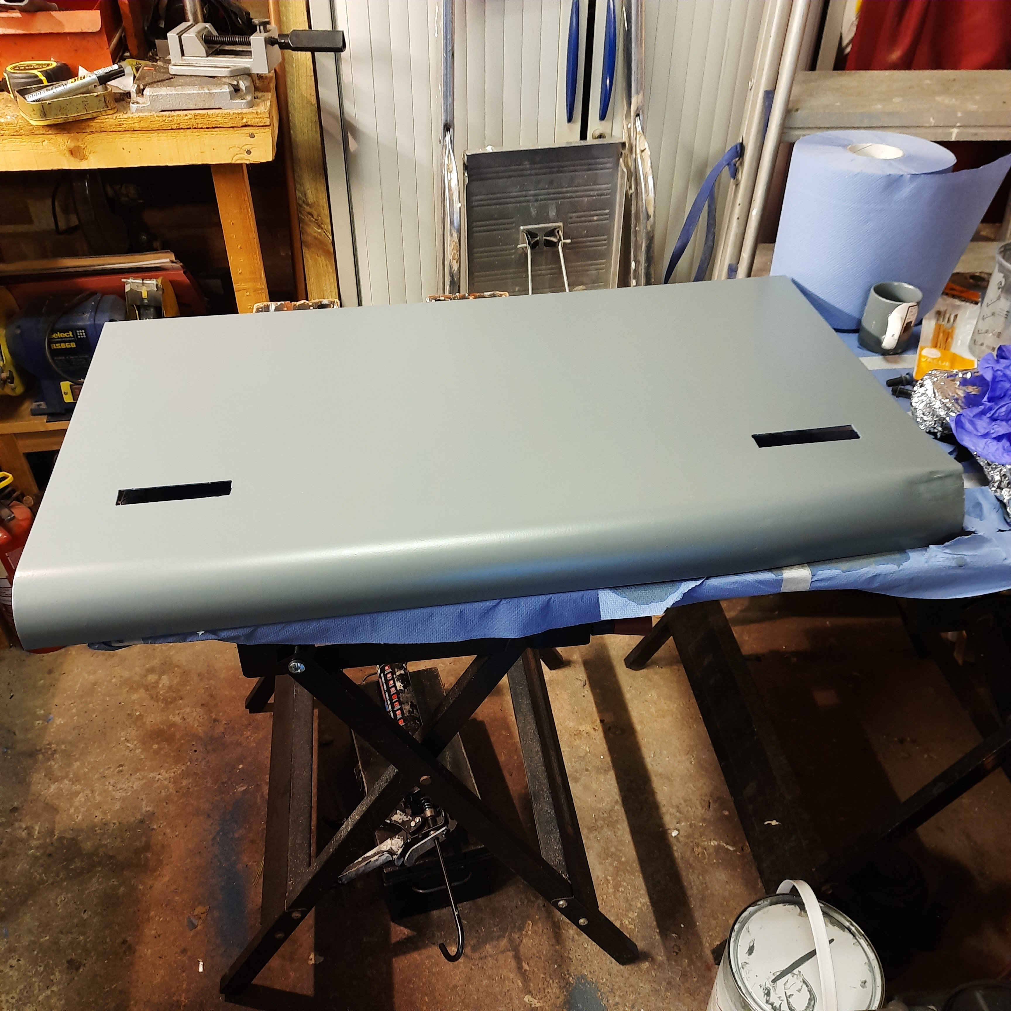

With the bottom panels off I set about painting the first one, I will point out that I have not done this before. Plenty of people have done this and there's plenty of info available particularly on the type of roller to use, 4 inch hard foam conical ends. So did the first panel and could not believe the amount of bubbles on the surface, thought OK let it dry see what happens it dried with a bumpy snake skin type effect. I sanded it all off repainted thinned the paint, hotter colder 5 times no difference. So phoned the paint manufacturer explained how I was doing it and the result. He asked about the roller told him high density foam he said that's where the bubbles are coming from I should be using a short mohair roller. Now I know a few people who have used the foam roller with no problems the only difference I can think is they all used matt paint I am using satin finish. Sure enough did the same panel again the way the guy said hey presto a finish I am happy with.
So considering it's my first time I think it looks OK.

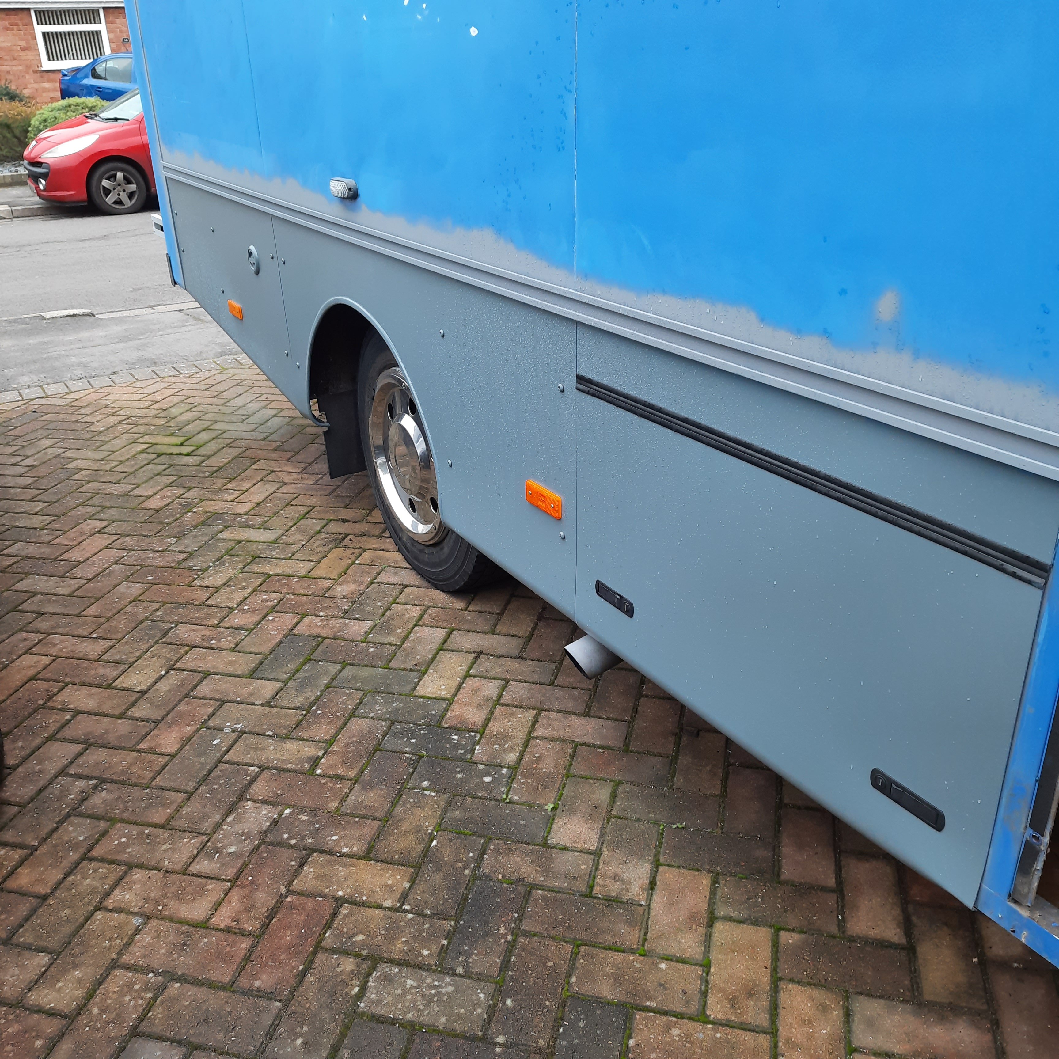

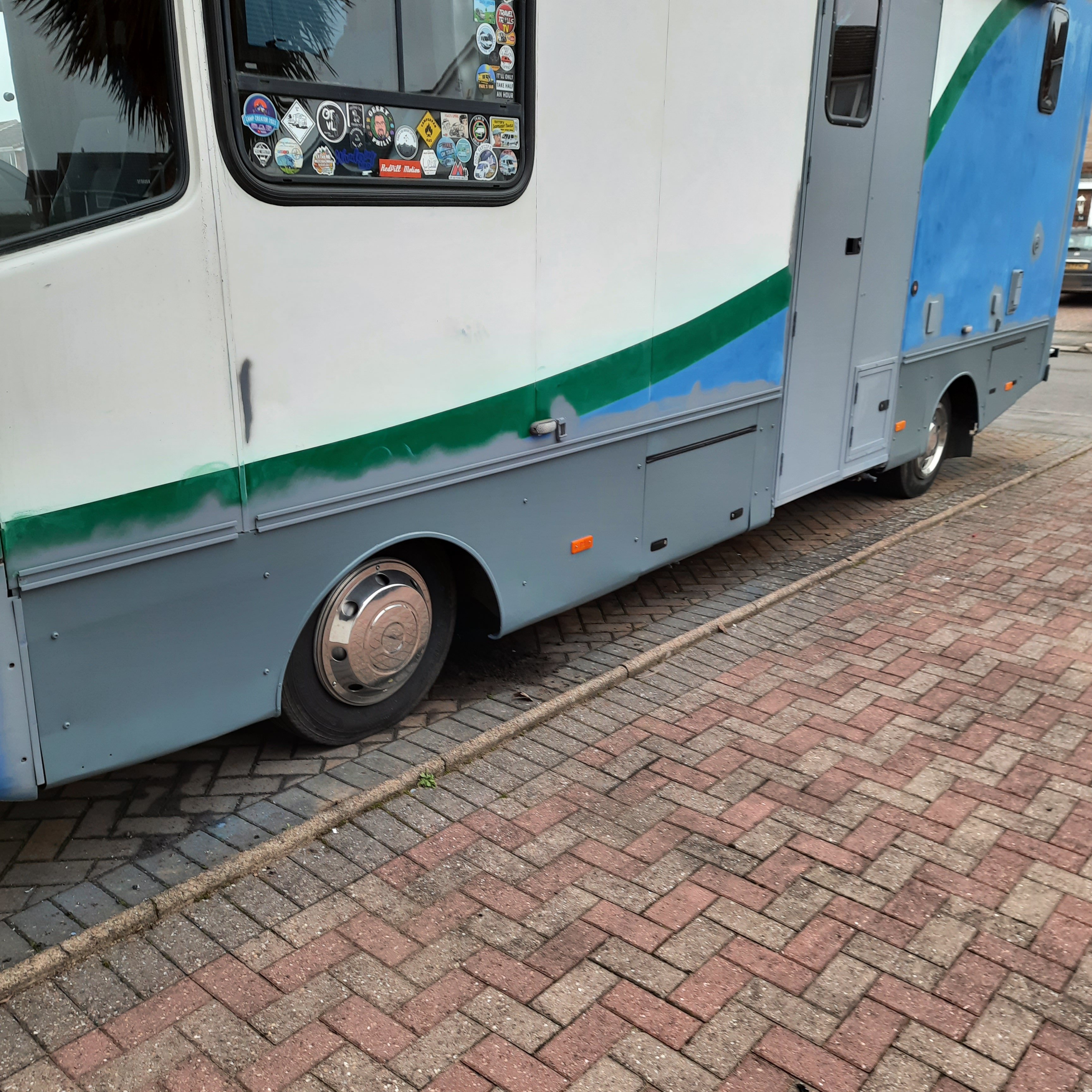

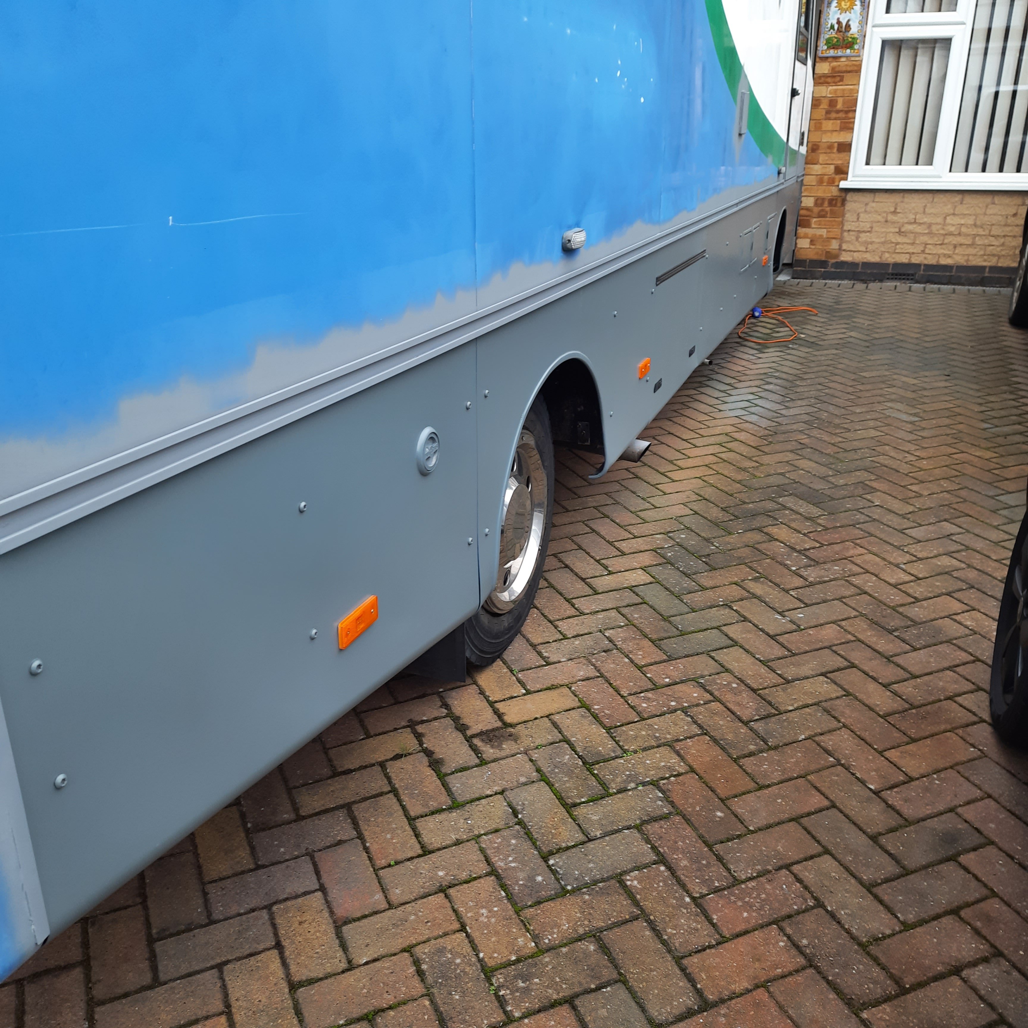

Bouydog
Overall I am pleased so far, that bottom colour is blue grey the other colour will be silver grey with various divisions and if I get really confident maybe a stripe !! So no camo this time 😄
View attachment 5063View attachment 5064
View attachment 5065View attachment 5066
So considering it's my first time I think it looks OK.View attachment 5068
