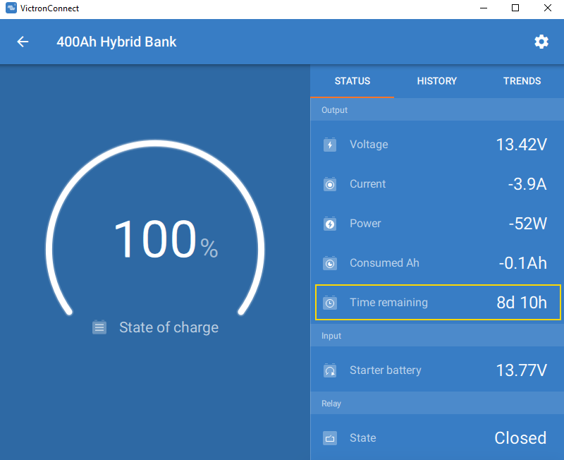

On the main display you get a "Time Remaining" field. This only appears with a number when you are not on charge (I turned the charger off on mine to get a number on mine for the screenshot)
This value is calculated based on a couple of entries in the settings - shown below

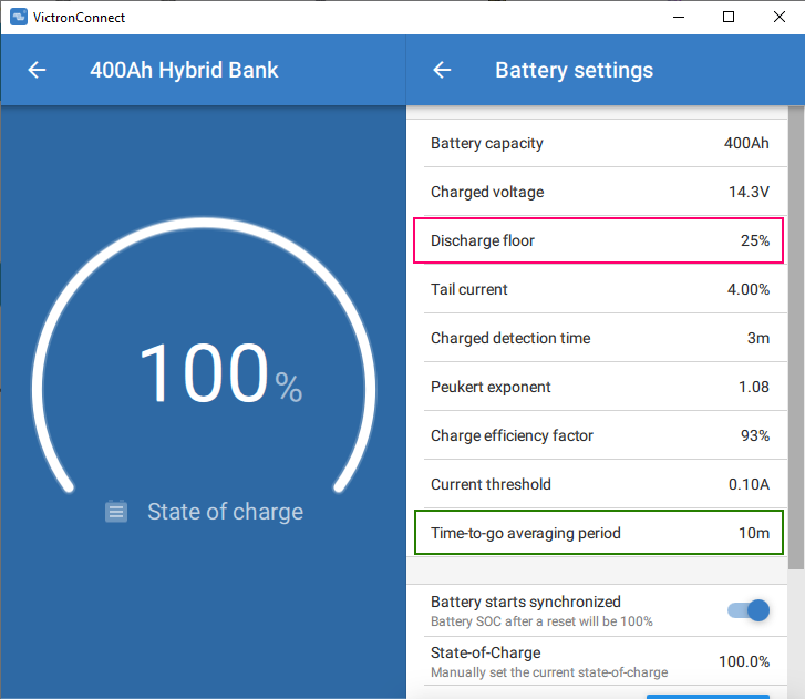

The Discharge floor (this is the maximum Depth of Discharge you want to take your batteries down to. So for the basic Lead Acid battery with the archetypal "don't go below 50%", you would set the Discharge floor to 50%). Mine I have set to 25% as it is a combination of Lead-Carbon and Lithium, so an agregate 25% discharge is fine (for me).
The Time-to-go-averaging period is used to work out the average current used over the time set (the default is 3 minutes. I set mine to 10 minutes).
So basically the maths would be the available AmpHours left above the discharge floor, averaged out based on the consumption over the Time-to-go time.
So in my case, it would be Available AH (300AH (75% of 400AH) - 0.1Ah), averaged over the Ah taken in the last 10 minutes, making a calculation of 8 Days 10 Hours.
How useful it is I don't actually know as I don't use this personally. I can imagine it could be useful for someone who tends to have fairly consistant power draws?
